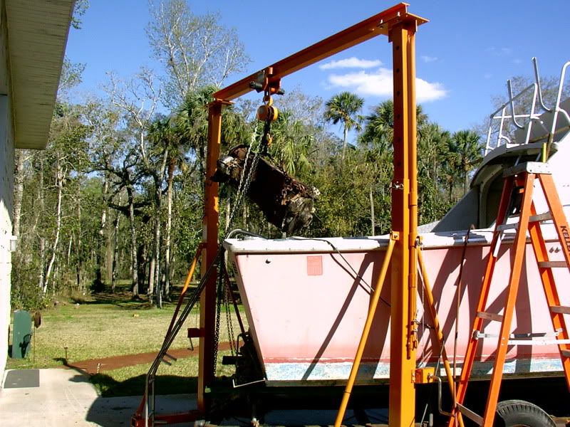

NoBones 03-13-2010 08:12 PM
******** eXtreme Makeover---- 27' Edition*******
Today was the day to shuck the balls of rust in the
engine compartment. "A" frame worked great, just a fuzz
to narrow.. :eek:
Port engine came out first
http://i7.photobucket.com/albums/y27...13-2010001.jpg
Then the starboard
http://i7.photobucket.com/albums/y27...13-2010003.jpg
Loaded on trailer, ready for scrap yard
starboard fuel tank came out as well.
http://i7.photobucket.com/albums/y27...13-2010006.jpg
Some of the tasty food that the rats liked
http://i7.photobucket.com/albums/y27...13-2010005.jpg
Found 2 pig weights in the bow. :eek: :eek: :rolleyes:
http://i7.photobucket.com/albums/y27...13-2010007.jpg
Tomorrow is another day of gutting whatever.
See ya, Ken
strick 03-13-2010 10:12 PM
Re: 27 project
Ken are you sure you cant refurbish those engines ? :D
Gotta love the Harbor Freight Gantry Crane. Sure comes in handy. I widened mine a little as there is room to move the two vertical legs out a couple inches on either side. I have 98.5 inches between the verticals now and I think I can go wider still. You will have to drill some new holes...take a look and you will know what I'm talking about.
NoBones 03-13-2010 11:13 PM
Re: 27 project
Strick, look close at the top... ;)
Been there done that. :cool:
First thing I did when it came home was re-drill
the 1/2 inch holes on the plate.
The beam is 9.8 on this tank!
Believe me those engines are beyond gone.
When we wrapped the chain and it hit the oil
pan they busted open and water poured out.
Ken
