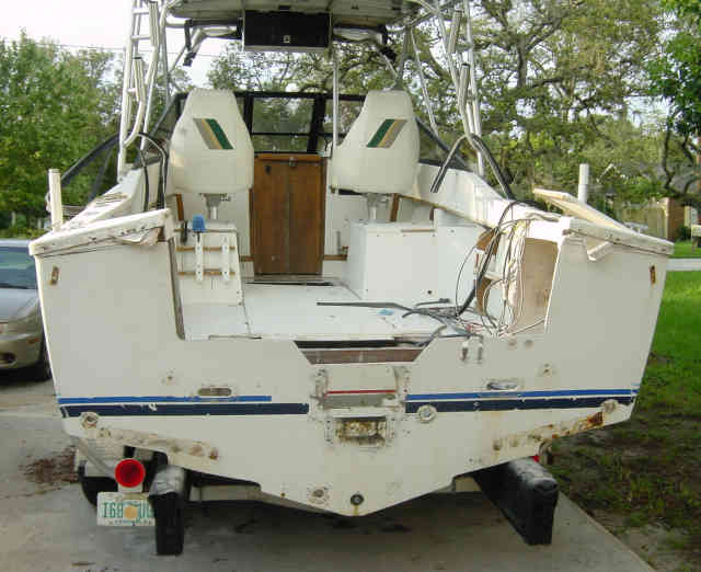

I have started "resurecting" my SeaCrafts sorry transom. The process got jump started by a couple week lag in work, and the fact the gas tank support collapsed on one side, wedging the gas tank against the side of the stringer, and loosening it from the hull.
I noticed when I would hit waves, the boat would pull to the left, a tad. Hull flex/load up on one side was the give away and some unusual "percussion". No stress cracks or anything else visible. The good news is these boats have an unbelievable amount of glass in them. The bad news, I think this boat was built on New Years Day. I have only seen one SeaCraft worse than this "under the covers", and it was a Potter, so you Potter guys don't get all puffed up. I have seen good and bad Potter, CSC, and Trackers. I have NEVER seen a bad Mosely era boat.
Anyways, I didn't plan to do this in the middle of the summer in Florida, but I figured the annual summer cold water would shut things down offshore, and I would just gypsy on other boats for a few weeks.
Here are a few pictures and questions
Here is the classic "before" makeover shot
http://www.deep-blue-sea.org/images/transom1.jpg

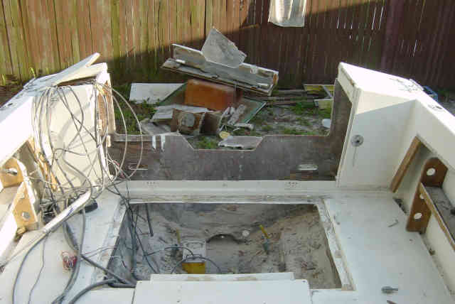

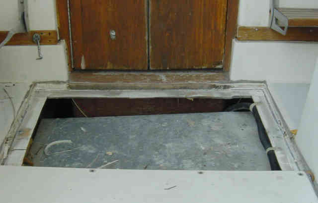

2 days of grinding/chainsaw/prypar/disassemly/etc
http://www.deep-blue-sea.org/images/transom2.jpg
http://www.deep-blue-sea.org/images/transom3.jpg

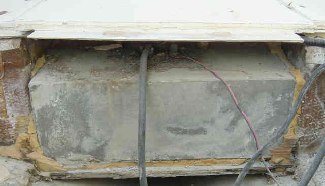

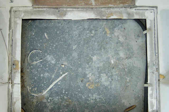

A few questions...
As I mentioned, I have to pull the tank and rebuild the platform under it. Capt Obvious pointed out that the tank is wider than the opening in the hatch, by over 1.5 inches.
Take a look at the pictures, and let me know what you thing.
http://www.deep-blue-sea.org/images/tank1.jpg
http://www.deep-blue-sea.org/images/tank2.jpg
http://www.deep-blue-sea.org/images/tank3.jpg
Someone looked at it and said I might be able to rotate the gas tank on its side and lift it out. hmmmmm.... Never had to do that before. I really don't want to take the top, cap, and liner out just to get at the gas tank. If any of you have any "helpful" suggestions, let me know.

hermco 07-27-2007 07:20 AM
Re: Stringer/Transom area question
You will have to cut the hatch reciever lip off to remove the tank. It is not possible to "rotate" it. ;)
JohnB 07-27-2007 10:48 AM
They put the tank in before they put the liner in? what a plan :D. That will be a pita to re-engineer. Maybe I will just cut the transsom down and slide it out the back. I am probably going to replace the tank, and when I do, it will be a couple inches narrower.
hermco 07-27-2007 12:50 PM
Yes they put the tank in before the liner. Is not that hard to pull the tank I just did one. Cut the lip and pull the tank,replace the lip making it only 1" wide,and have the new tank made to fit inside the lip opening.The liner probably doesn't sit on the stringer so this is the time to glass it as well. :D
JohnB 07-27-2007 01:14 PM
Your right about the liner/stringer relationship. That is something I plan to fix. Sometimes I wonder if the "SeaCraft" ride is partially due to the gap between the liner and the hull. A built in shock absorber. The problem is over time, it causes stress cracks all over the fish boxes and by the cabin.
You have any secrets on how to put the lip back in?
hermco 07-27-2007 01:36 PM
Take a straight 2x4 x whatever you need for length and apply masking tape to edge so glass wont stick. Set in place where you cut off the lip and glass up to it from the stringer. Be sure to grind the stringers first. When it cures trim to a width of 1" and you are good to go. :D
