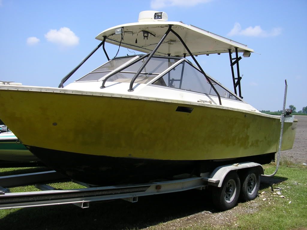

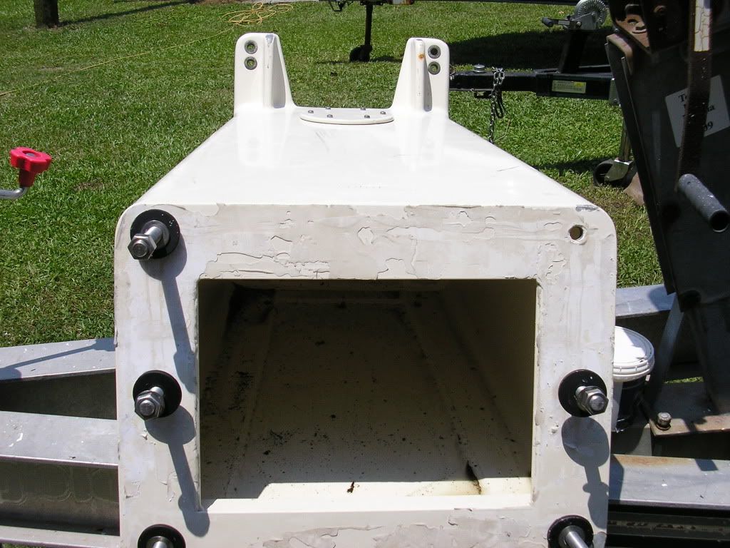

Well finally we finally quit procrastinating and finished sanding the hull sides down to old gelcoat (port) as the starboard side has been finished for a couple of months!! We also removed the bow rail and are in the process of removing bow pulpit to recore it (rotten also). I've also pictured my newest and most sought after PRIZE! I found a gent on another fishing website here in NC that had a Armstrong (by the looks of it) bracket for sale.....$300.00.....what can I say....I snatched it up quick!!!

SBD 06-12-2010 09:27 PM
Re: '77 Sceptre Rebuild update 06-12-10
That bracket looks like a Gil.
newellchunker 06-12-2010 10:13 PM
Thank You SBD......I researched it and it is indeed a Gil Bracket! I was fortunate enough that it was 12 degrees as was needed for my transom.
SBD 06-13-2010 02:29 AM
Can't go wrong if its the right angle at $300.
