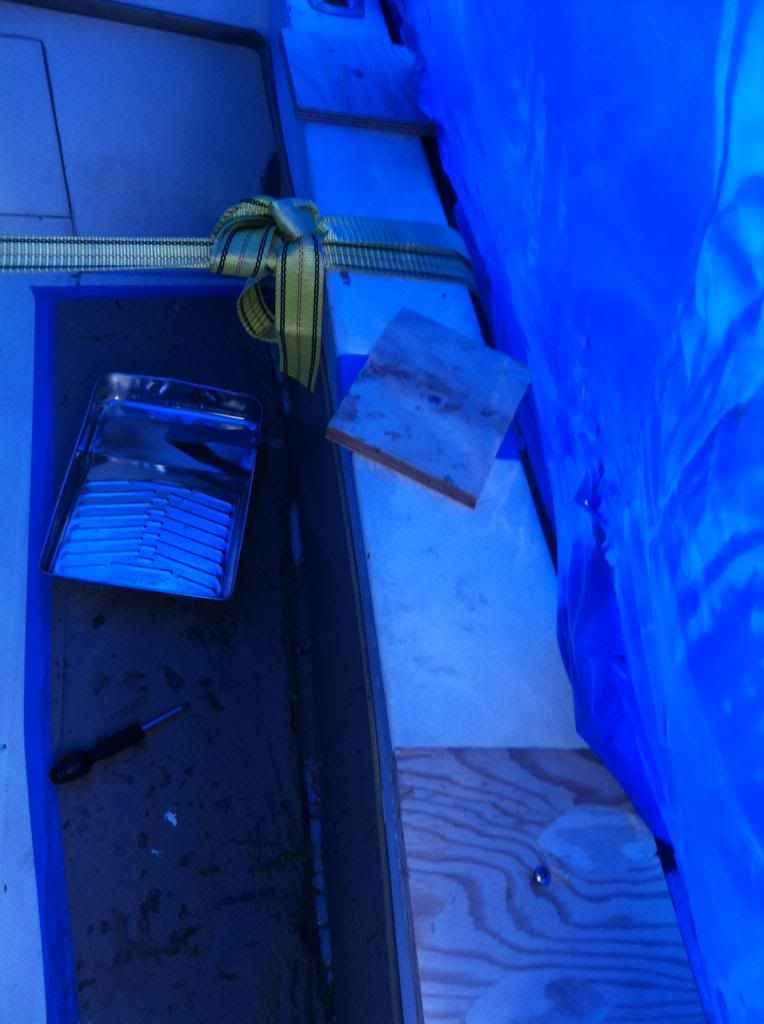

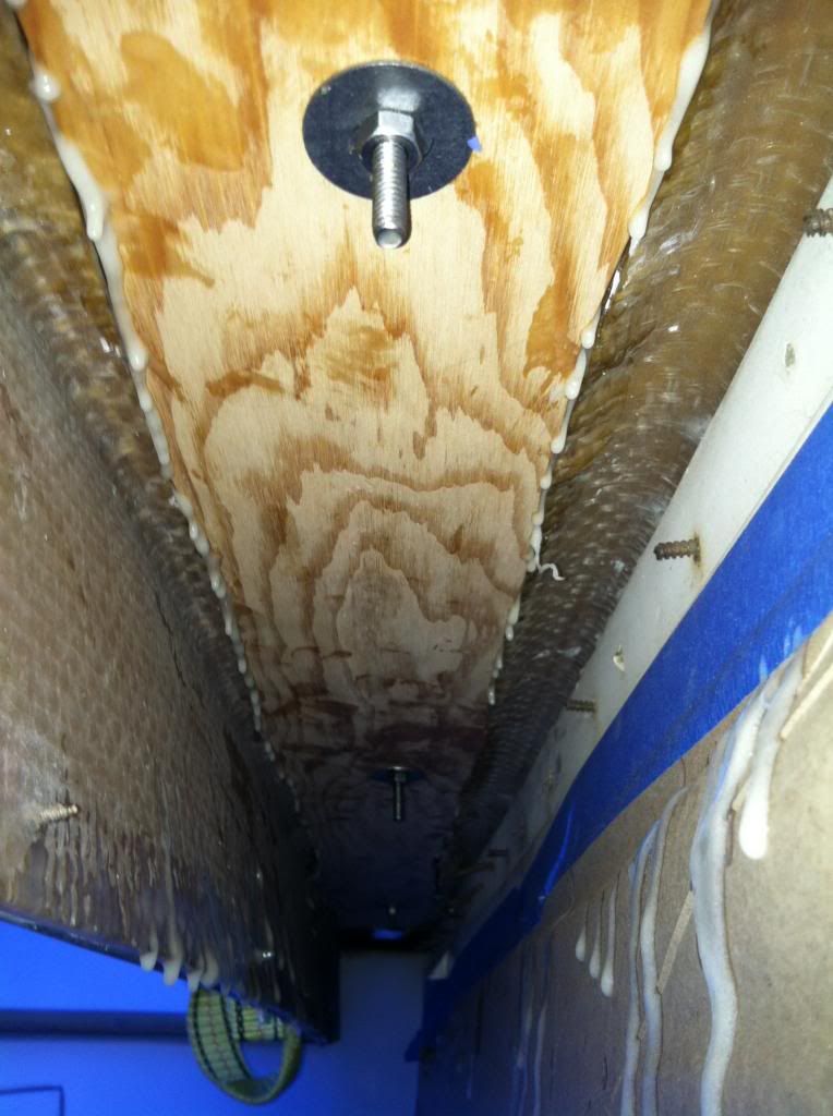

zendora 05-28-2013 04:32 PM
Well, I made an unholy mess, but the new cores are in. Tonight I'll take the screws and 'backing plates' off, fill in any voids along the edges with West System 6-10 thickened epoxy and glass over the boards from underneath.

wattaway2 05-28-2013 08:20 PM
Looks like a lot of work how's the back and neck feel looking at yours I'm glad I was able to pull my cap off and turn it upside down and do it that way --- hats off to you!!
