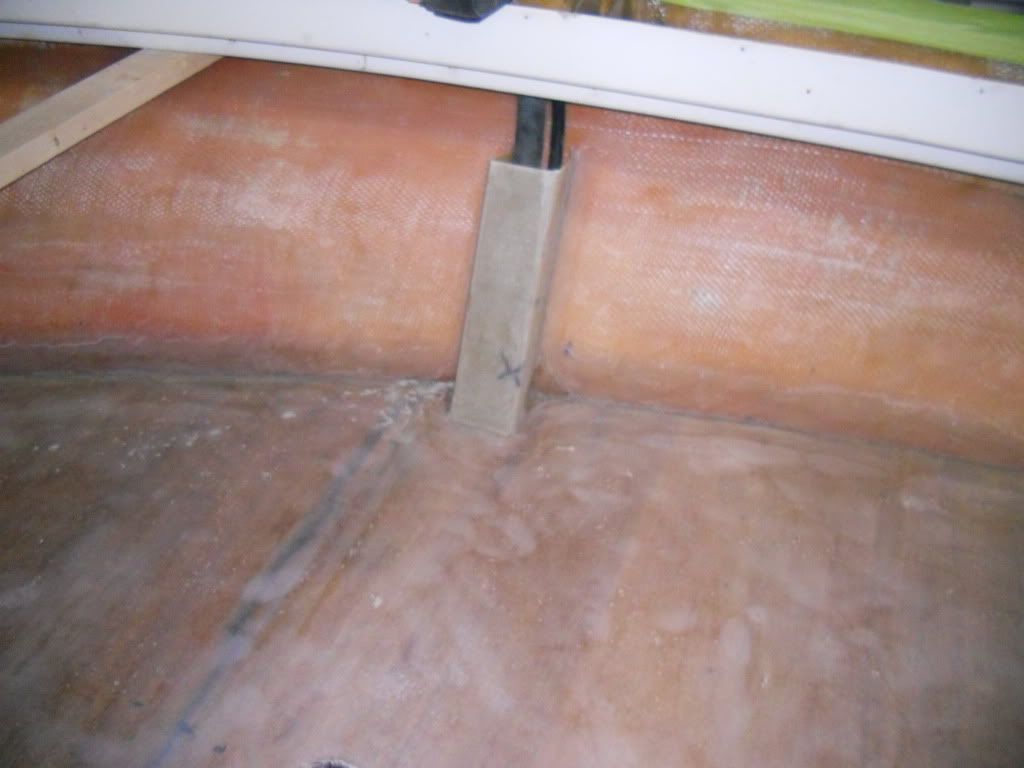

Glassed a new block in for the bow eye. Glassed a 2" pipe in for the gas line and a raw water washdown that will go under the console.

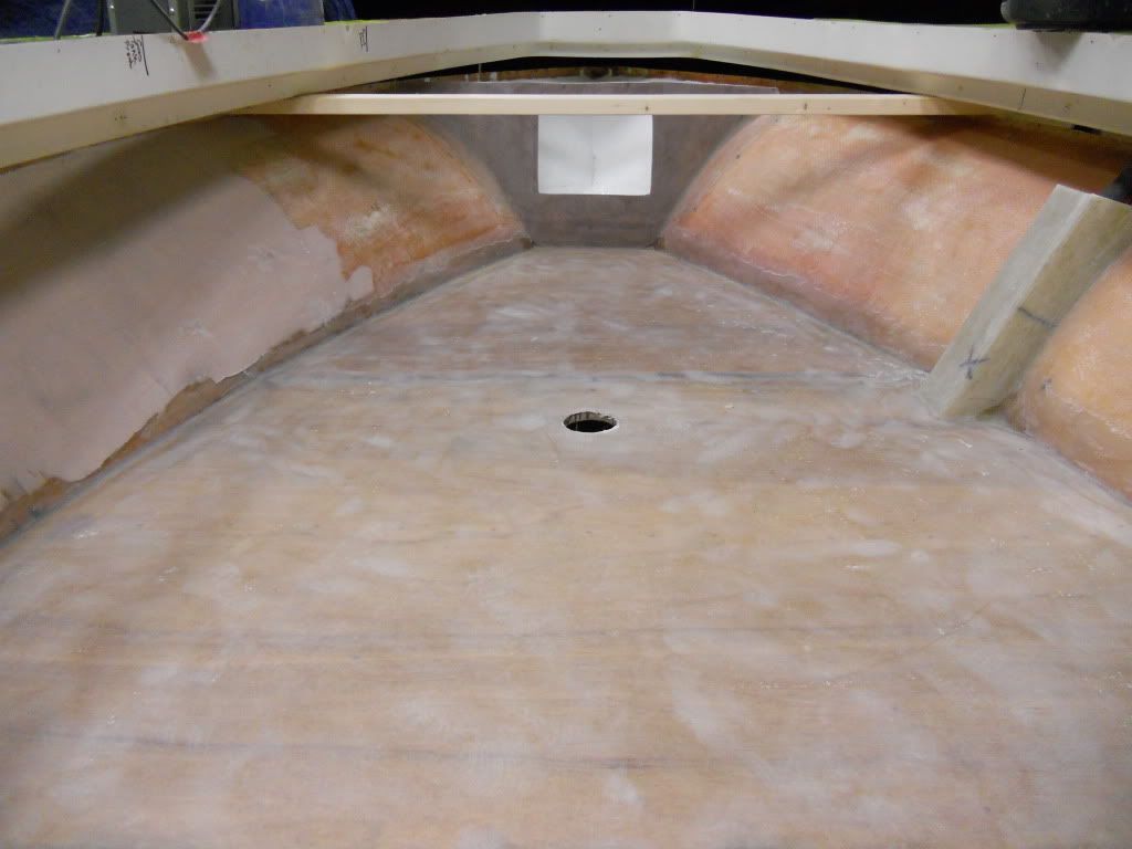

Blue_Heron 01-25-2011 06:51 PM
Re: 1977 20ft Master Angler Restoration
Maybe it's just the angle of the picture, but could there be a little twist in the hull? It looks like the plywood seam farthest aft slopes slightly from right to left and the one farthest forward slopes slightly from left to right.
http://i879.photobucket.com/albums/a...o/DSCN0555.jpg
It might not be a bad idea to lay a level and straight edge across the gunwales aft and forward to see if they're both level. If there's a twist, it will be a lot easier to correct before the deck is glassed in and it becomes permanent. Or maybe it's just my overactive imagination.
Anyway, your work is moving right along. You'll have her in the water in no time at this rate. I see you've made good use of the space heaters to keep your resin active. I think I'm going to have to invest in a couple more of those myself.
Dave
Seacraft84 01-25-2011 08:48 PM
I am just hot coating the bottom, the top side will get 1 layer of 1708 with 1.5oz matt on top of that to give me something to sand smooth. I feel since I am using 3/4" plywood putting glass on the bottom is just adding weight. Now if I were going to use 1/2" plywood then glassing the bottom would make sense. And the resin is waterproofing the wood good enough.
Blueheron.. The floor is pretty level when I pull a string and measure up the sides. It is pretty close, may be alittle off. You will never notice once everthing is put back together.
The hull looks alittle twisted because the top cap is not really connected to the hull. Just a couple of screws holding it together. I had to undo a bunch in order to lift the top cap to get the plywood in. But I will definatly put a level on it before I screw down the floor. Once I get the floor glassed I will do the top cap. The space heaters work good but the reddy heater I bought for $30 off craigs heats the place up very good. I can even work in short sleeves!! Only thing is, kerosine is $3.40/gal. I guess I use about 2gal in a evening glassing. I usually keep it off when sanding and stuff.

Blue_Heron 01-27-2011 08:16 AM
Stringlines around the perimeter won't tell you if you have a twist. Imagine a twisted picture frame. All four sides can be straight, but it's still twisted. To be sure, try this trick of the trade from an old carpenter:
Run two stringlines diagonally across the deck as in the picture below. Pull the red one first, then pull the blue one over the top of the red one. Pull both strings tight and then slide a 2x4 block under each end of each string. The strings should touch in the middle. If there's a space between the strings, you have a twist. If there's no space, switch the strings so the red one runs over the blue one. If they touch again, you're good to go.
Dave
http://i655.photobucket.com/albums/u...t/DSCN0555.jpg
Seacraft84 01-27-2011 09:43 AM
Thats a good idea. I will do that first thing this evening. Hopefully nothing is off to bad and I can get it corrected now.
Thanks again. :)
Seacraft84 01-28-2011 01:34 AM
Well everything seems to be good to go. Pulled some strings and they layed on one another just right with either one on top. Also rough cut a bulkhead for the front, where the anchors will be stored. Maybe Saturday I can get the floor screwed down.

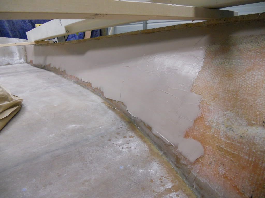

Thanks man. Put some quikfair putty on the inside of the hull this evening. This stuff is great. Goes on very easy. Started remodeling my wifes buisness this weekend so boat stuff came second.

ricknewman 02-14-2011 10:31 AM
Are you going to replace the carpet inside below the gunnel or just paint? Does anyone know the purpose for the carpet?
Seacraft84 02-14-2011 05:14 PM
Yeah I am going to fair it out and paint it. I guess the carpet was to cover up the woven since there is no liner.
everybody 02-15-2011 08:36 PM
I would think about putting a layer of matt over the quik fair and then some more quick fair while the matt is a bit green. I did on mine because I was afraid the flex would cause the quick fair to crack. That is just a guess on my part. somebody may know for sure

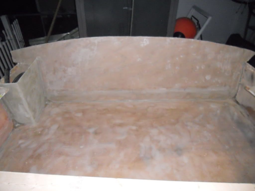

Seacraft84 02-22-2011 12:21 AM

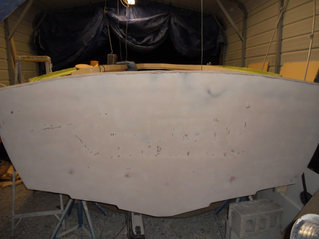

Been hard at it. Got the first coat of fairing sanded on the transom. Sanded all the inside plus the floor. All is ready for fairing. Started sanding the console. I will add some glass to the bottom edge and remove all the foam around the box.

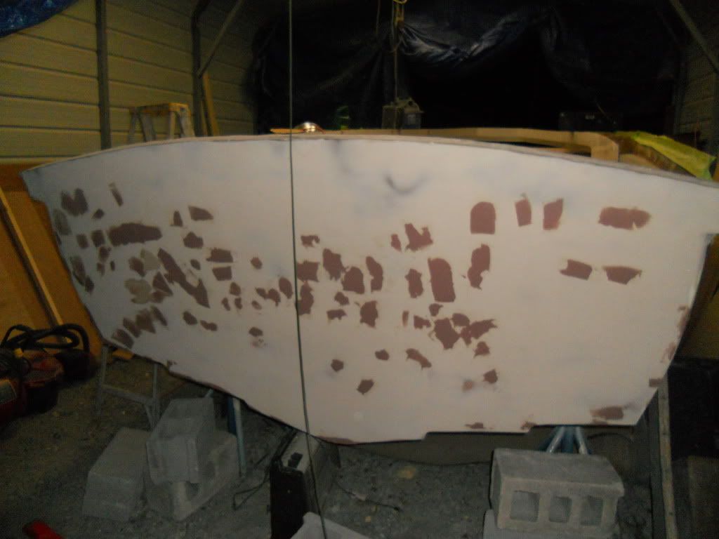

Seacraft84 03-14-2011 01:32 AM
Finally got some work done on the boat. My dad came by and gave me a hand putting the top cap on and cutting out the new transom. Put the cap back on with 100 thru-bolts.
One set back lately has been some quickfair not setting off good. I know, I said it was some pretty good stuff. At first I had bought the 1.5qt kit and it was fine for the most part, sanded good, and not any soft spots. Then I went and bought the 1.5gal kit to finish the rest of the boat. I weighed it out on a set of scales, mixed it up with a drill paddle, heated my shed up with the heater and let it run for ever, and still had places that were completely soft. Now the outside of it before I started sanding was hard. Then after sanding a couple layers off, soft spots started appearing. I dont know if it was something I did wrong or just bad product. I do know that all the West Sytems 407 and 410 I have been using has not give me a bit of trouble. I ended up using some 410 to fill in the spots I had to grind out.

newellchunker 03-14-2011 08:53 PM
Man thats some good work you're putting out there! I can tell that the apple didn't fall far from the tree! How's Mr.Donnie doing anyway? I had his phone number after I bought a downrigger from him a few years ago and lost it. Anyway, I see that your cap was in about the same shape as ours was. Did I read correctly...you used divinycell to recore it correct? If so did you find it local? I think thats the same route I'm gonna go with ours. I wish that we were closer, I'd like to get some first hand experience with you and your dad teaching my son and I! Take care and keep it up. Tell your dad hello...
Seacraft84 03-15-2011 01:33 AM
Thanks man. You all can stop by anytime. Dad is doing good. About to retire in alittle over a year. Him and a buddy built two carolina boats last winter and wants to build a bigger one once he retires.
My cap was in good shape other than where the rod holders were and bow section. I kinda messed it up on the top side of the bow. The flat bar went through it a couple times and the glass became flemsy when I took out the wood. Basically I am going to have to grind it down and relay some glass on the top side now. I ended up using 1/2" okoume with four layers of 1708 to recore it with.
newellchunker 03-15-2011 07:22 AM
I know the feeling about punching through with the flat bar!! We did it in quite a few places also...where we went through I layed up a layer of 1708 and then another layer of 1.5oz mat over it. I hope that will give me a base that we can sand and fair out and get it looking straight again after we recore it!

Finally finished up with my wifes shop and she should be open next week. Just finishing up helping my buddy make the lettering for sign that will go on the building.
Finished up the transom tonight. All I need to do now is sand it some and add a layer of 1708 and 1.5oz mat over it and blend in with the rest of the gunnel. Filled in all the holes in the top cap and had a buddy come by and start sanding on the hull. Hopefully by the weekend he can have the whole boat sanded top to bottom. I am starting to run out of time and my buddy needed some extra cash, so it is money well spent.
http://i879.photobucket.com/albums/a...o/DSCN0804.jpg
http://i879.photobucket.com/albums/a...o/DSCN0821.jpg
http://i879.photobucket.com/albums/a...o/DSCN0803.jpg
http://i879.photobucket.com/albums/a...o/DSCN0809.jpg
http://i879.photobucket.com/albums/a...o/DSCN0812.jpg
http://i879.photobucket.com/albums/a...o/DSCN0802.jpg
http://i879.photobucket.com/albums/a...o/DSCN0801.jpg
strick 03-23-2011 08:19 AM
I like the lay out. Looks nice and clean. Are you going to put a live well in it? Paying someone to help with the sanding is one of the smartest things I have ever done :D
Seacraft84 03-23-2011 12:31 PM
Thanks man. Trying to utilize all the space. I am going to build a coffin box to go in front of the console. Dang coolers are so expensive and I can build the box for about $100.
I have never been a fan of hatchs in the floor and compartments everywhere, especially on these smaller boats.
