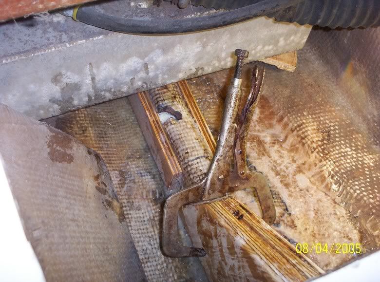

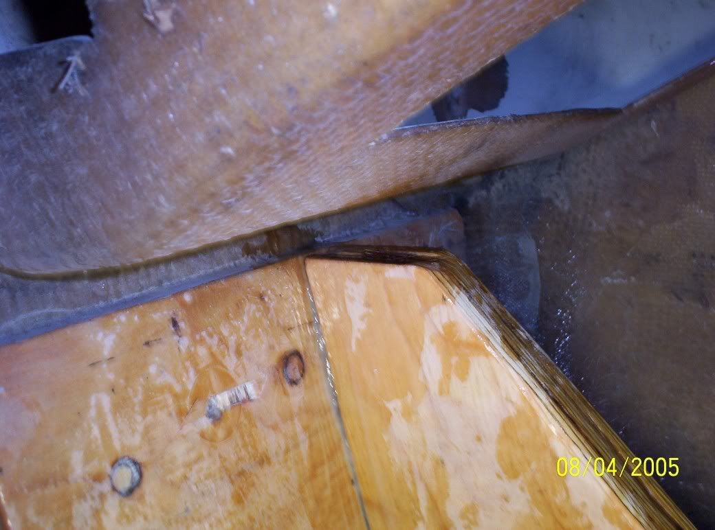

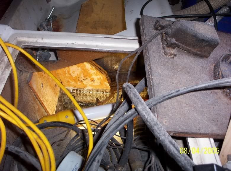

ok - so last we saw, the keel had a hole in it, and I wanted to brace the transom with a knee, to stiffen and prevent any further cracks from developing in the splashwell, or transom corners - as seen
http://i12.photobucket.com/albums/a2...r/000_0276.jpg
so tonight I crawled underneath, ground off the gel coat around the transducer hole, and beveled the hole out a little - I had already slabbed a couple pieces of 3/4 ply on each side with RW and thickened epoxy
here is the partially filled keel hole, and the knee brace
http://i12.photobucket.com/albums/a2.../Kneebrace.jpg
and here is another shot of the knee - it's two shorter pieces of 3/4 ply bonded to one longer one, which is slabbed onto the side of the keel, again with epoxy soaked RW and filled epoxy butter
http://i12.photobucket.com/albums/a2...kneetokeel.jpg
I ran the knee up to the top of the inside transom stiffener plate, both of which end right below where the splashwell comes up to the transom
http://i12.photobucket.com/albums/a2.../topofknee.jpg
Tomorrow night I'll go back and tab the knee into both the keel and the transom support plate. Then I should be positioned to put the outer skin back on this weekend.

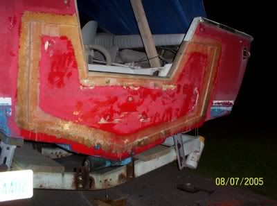

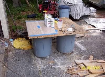

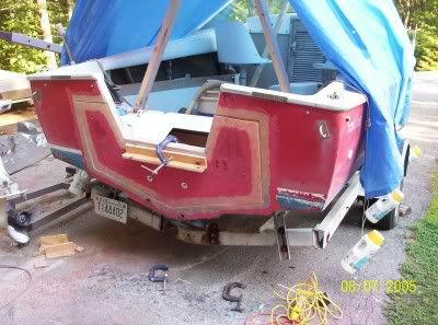

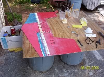

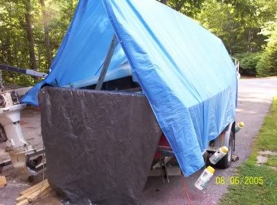

oldbluesplayer 08-08-2005 01:58 AM
the skin goes in -
sun night - took all weekend - maybe I'm just anal about details and prep - oh well.
a running picture story -

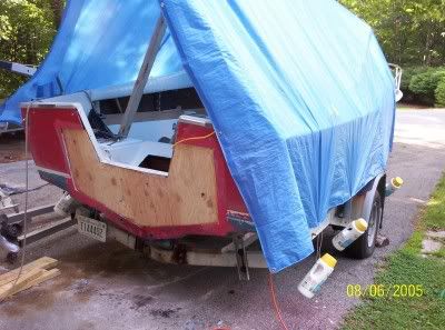

Sat morning
http://i12.photobucket.com/albums/a2...ayer/satam.jpg
pull off the cover and get ready to work

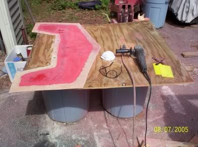

http://i12.photobucket.com/albums/a2...thenewcore.jpg
set up the work bench - I like 3M blue painters tape and wax paper - an easily renewable work surface
http://i12.photobucket.com/albums/a2...yworktable.jpg

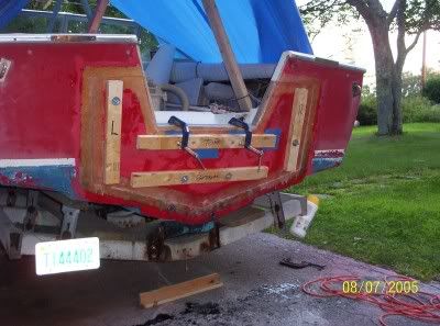

first real job, cap the new transom with several layers of cloth / epoxy resin, using some quickie molds to help hold the shape
http://i12.photobucket.com/albums/a2...transomcap.jpg
now pull the molds off after that cured, and do a little sanding
http://i12.photobucket.com/albums/a2...pedtransom.jpg

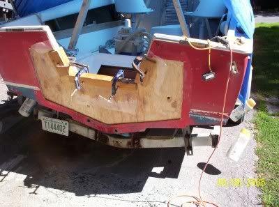

now to start prepping the outer transom skin - I had previously ground clean the inside surface, but still needed to do the outside surface
http://i12.photobucket.com/albums/a2.../skinprep1.jpg
and then grind back the edges, both on the skin, and on the boat, so it would be ready to tape the seam after installation
http://i12.photobucket.com/albums/a2.../skinprep2.jpg
and then trial fit - it came out of that hole - would it go back in ?
http://i12.photobucket.com/albums/a2...kinfitting.jpg
mixed up more sauce, backed up the skin with a piece of RW, wet the core, skin and RW out, and installed
http://i12.photobucket.com/albums/a2...kinbonding.jpg
Halleluja !! the Skin is In !!!
http://i12.photobucket.com/albums/a2...heskinisin.jpg
word to the wise - this is a butt busting, dirty job - don't undertake this lightly.
On the flip side, rap the new transom with a hammer and hear the sharp, distinct sound of SOLID .... I like it !!!
