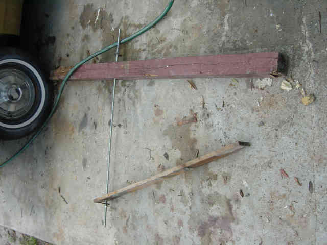

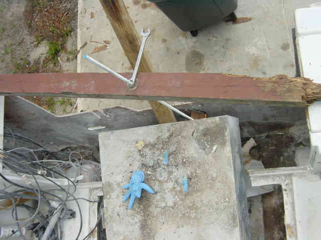

JohnB 07-30-2007 09:20 PM
Re: Stringer/Transom area question
I have a carbide tip chain saw we use for disaster relief. It cuts wood, fiberglass, and aluminium like butter. I think I will leave it on the shelf for this one.
I tried a new approach, and the tank is freee and pretty well out, got rained on, and needed a second set of hands to catch it this afternoon. I should have it out in the AM.
I used a 6' piece of 4x4, a 3' piec of 5/8"s threaded rod, and a 5' 2x4 and it took about 2 hours to get it out.
I drilled a hole in the end of the 2x4 and slide it under the tank lengthwise. I drilled another hole in the center of the 4x4, and placed on top of the stringers just past the end of the gas tank. I slide the threaded rod through the 4x4, and down through the 2x4 that was under the gas tank. Then I put a big washer and a nut on the bottom end, underneath the 2x4. I put another washer and nut on top of the threaded rod, on top of the 4x4. Put the wrench on it, and in about 15 minutes, I had it popped free, and started sliding it toward the back of the boat. The steady presure broke it loose from the foam. I currently have the rear of the tank resting against the transom, and I will have to grind a little off the tabs to get it out.

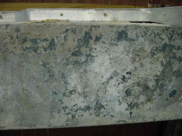

The tank is out, and it looks like she is getting a new one.
http://www.deep-blue-sea.org/images/tank4.jpg
Would you say this was pitted?
http://www.deep-blue-sea.org/images/tank5.jpg

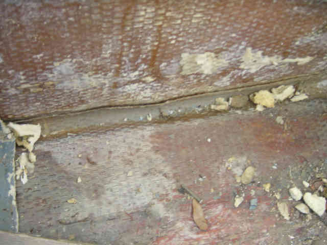

Now for some more fun. I suspected that a stringer was loose. I didn't suspect it was loose 1/2 the length of the boat. It seems that the port side is always the screwed up side on a seacraft. They didn't put enough glass to hold it and they didn't rough it up when they put it in there. It just pulled apart, with shiny glass underneath. The other side looks fine, and has more glass over there. I am probably going to re-enforce it. Good news is the stringers are dry and appear to be fine.
http://www.deep-blue-sea.org/images/stringer1.jpg

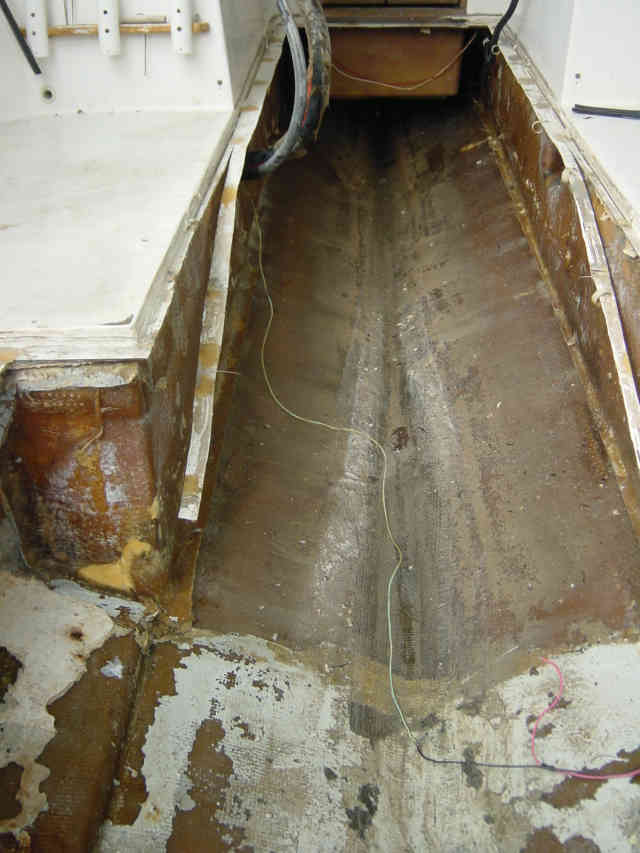

Here are some shots of the empty spaces.
http://www.deep-blue-sea.org/images/transom4.jpg
http://www.deep-blue-sea.org/images/transom5.jpg
One of these shows the "tool" in action. One guy, 4 hours, and the tank is out. No trying to get the foam out, it lifted straight out, even though it was twisted/shifted in there. Here is the tool I came up with.
http://www.deep-blue-sea.org/images/tool.jpg
