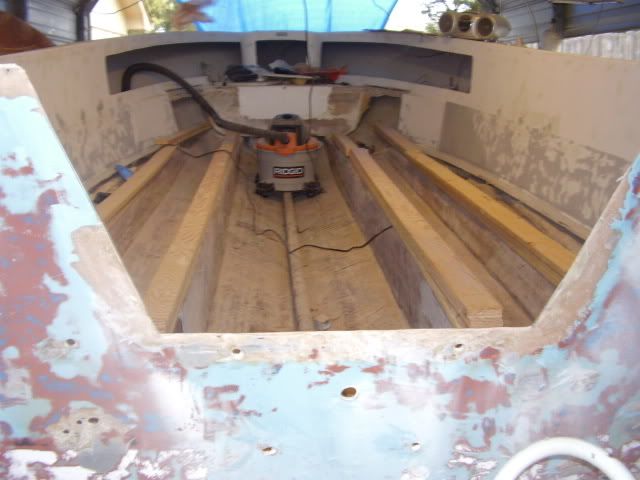

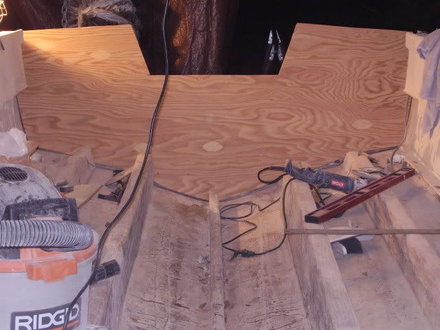

skipjake04 03-10-2008 12:08 AM
Re: Floor?

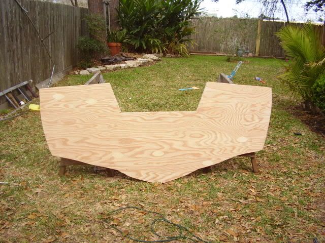

transom finally cut
http://i216.photobucket.com/albums/c...console063.jpg
test fit. It worked the first time can't believe it.
http://i216.photobucket.com/albums/c...console067.jpg

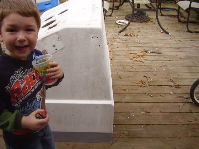

my helper and side shot of "new" console
http://i216.photobucket.com/albums/c...console065.jpg
http://i216.photobucket.com/albums/c...console066.jpg

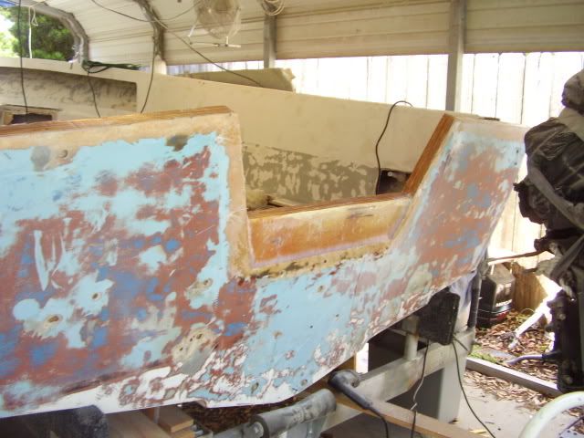

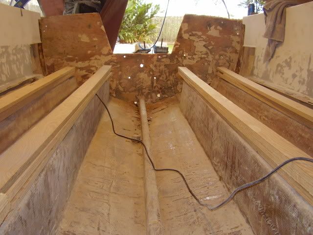

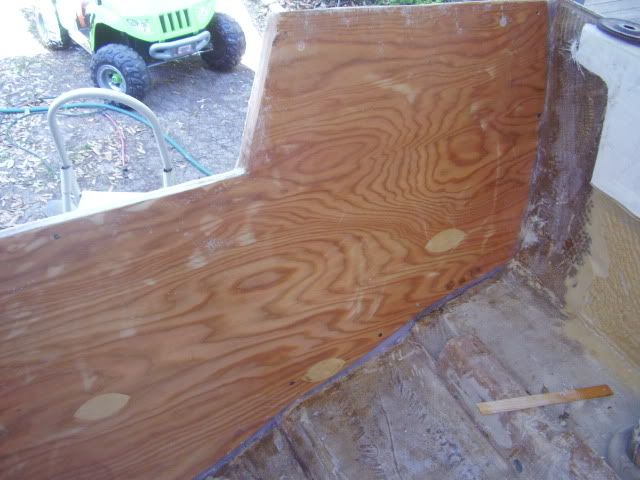

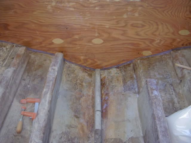

skipjake04 04-13-2008 07:09 PM
Re: What I did to remove.

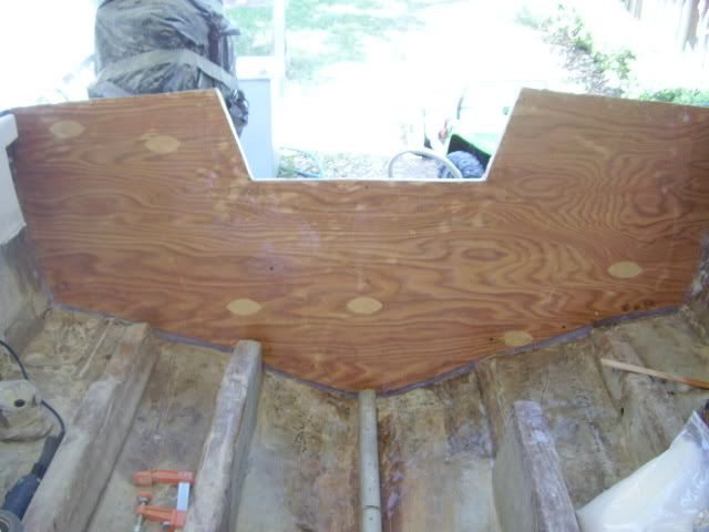

transom work.
http://i216.photobucket.com/albums/c...console078.jpg
just need to lay inner skin
http://i216.photobucket.com/albums/c...console088.jpg
http://i216.photobucket.com/albums/c...console090.jpg
outside shot
http://i216.photobucket.com/albums/c...nsole087-1.jpg
one more shot
http://i216.photobucket.com/albums/c...console091.jpg
