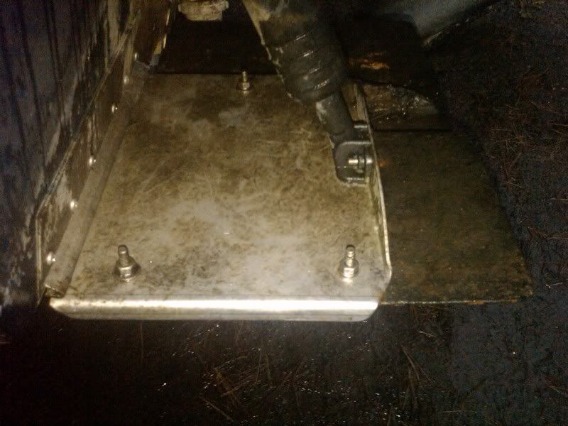

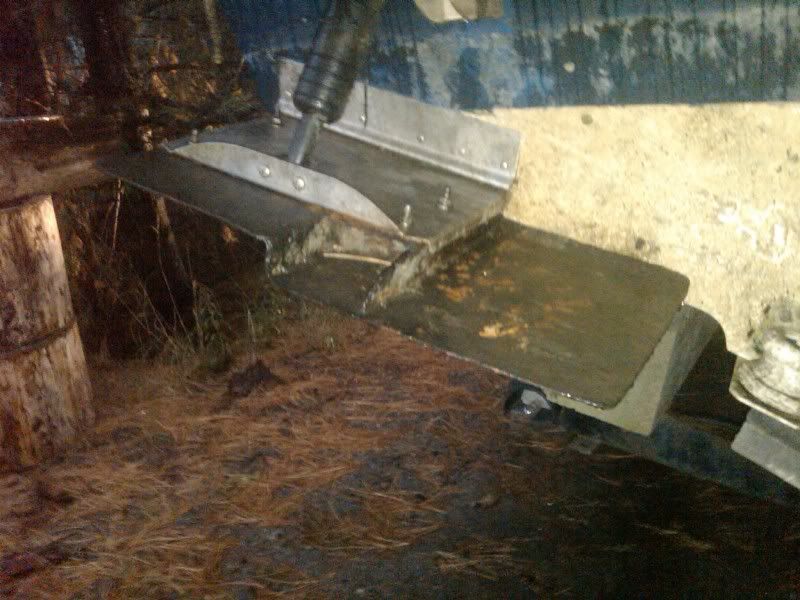

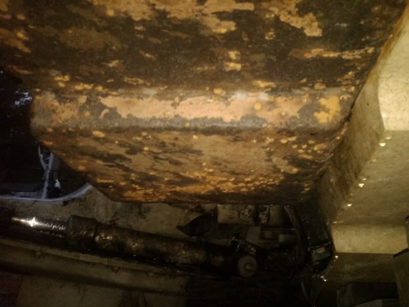

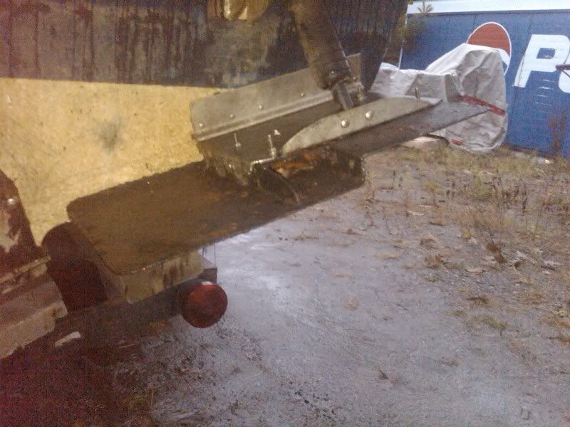

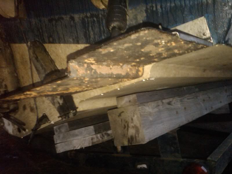

Well, she was on a trailer awaiting cleaning and winterizing so I got a few shots.[image]http://http://i446.photobucket.com/albums/q...91023-1826.jpg[/image] [image]http://i446.photobucket.com/albums/q...91023-1822.jpg[/image] [image]http://i446.photobucket.com/albums/q...91023-1821.jpg[/image] [image]http://i446.photobucket.com/albums/q...91023-1820.jpg[/image] [image]http://i446.photobucket.com/albums/q...91023-1822.jpg[/image] [image]http://i446.photobucket.com/albums/q...91023-1824.jpg[/image]

cdavisdb 10-26-2009 08:58 PM
Re: Seafari 25 Performance
Outstanding pics! Just what I needed to show the welder.
Thanks
Connor

Mine are where Brandon's seem to be. They exit through the side of the boat. Much of the time the deck tilts slightly down going forward, so scuppers more forward sound like a good idea.
Brandon,thanks again for the tab idea. Those are even larger than what I had on the Seabird. Looks like there is enough surface area to damp the roll quite a lot. I'll find out.
