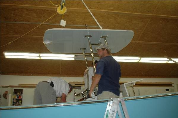

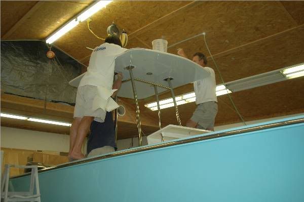

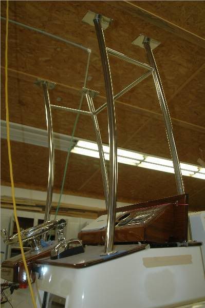

These are the legs of the new hard top. Everything is just tack welded together for now.
http://i31.tinypic.com/2ajwcgm.jpg
The console has now been glassed into the boat.
http://i32.tinypic.com/281bpxv.jpg
Battery box underneath the roll up console seat.
http://i25.tinypic.com/123slmv.jpg
Legs mounted to the top of the console.
http://i30.tinypic.com/v748bd.jpg

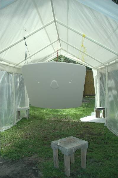

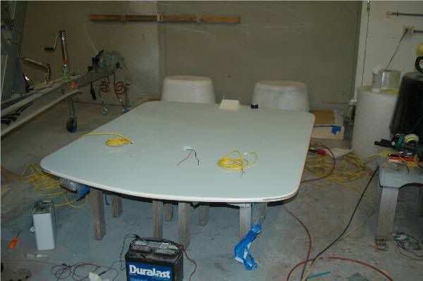

Foam core hard top is fabricated.
http://i26.tinypic.com/14b0oy9.jpg

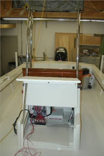

The floor was raised about 2". The boat is about finished now and I'll post pictures, but here are some progress pics to catch up.
Console is now being completed. The plates have been welded into the proper position to accept the hard top.
http://i57.photobucket.com/albums/g2...nes/csc190.jpg
http://i57.photobucket.com/albums/g2...nes/csc187.jpg
http://i57.photobucket.com/albums/g2...nes/csc189.jpg

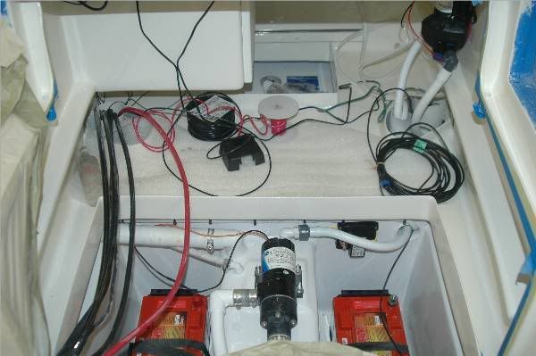

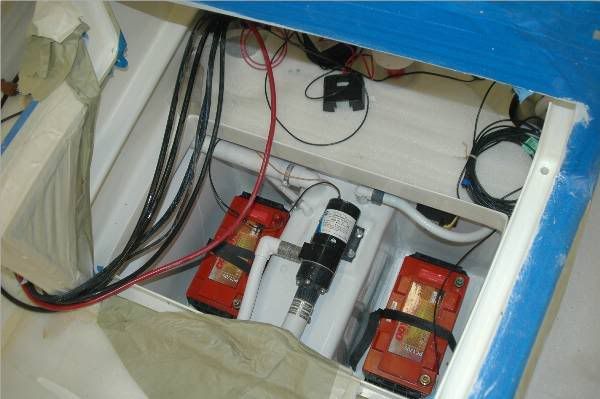

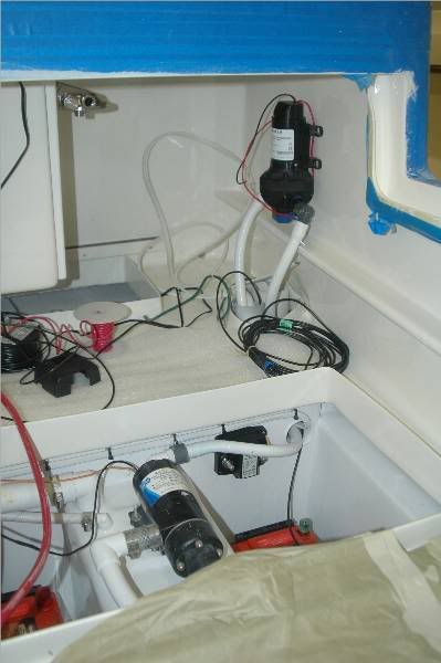

Battery box and inside of the console.
http://i57.photobucket.com/albums/g2...nes/csc191.jpg
http://i57.photobucket.com/albums/g2...nes/csc192.jpg
http://i57.photobucket.com/albums/g2...nes/csc193.jpg

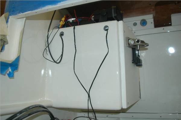

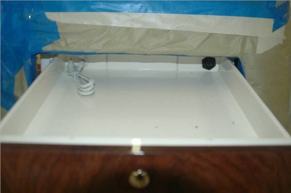

This is cool: wires from the black box VHF and stereo travel through the back of the drawer box and into the top drawer. The microphone for the VHF and my ipod can be put in the top drawer.
http://i57.photobucket.com/albums/g2...nes/csc194.jpg
http://i57.photobucket.com/albums/g2...nes/csc188.jpg

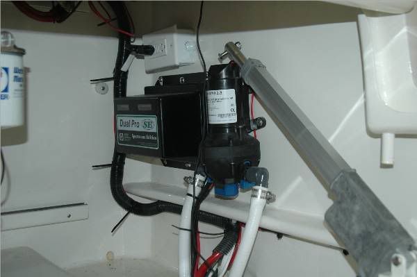

Battery charger, fresh water pump, and the actuator for the roll-up dash.
http://i57.photobucket.com/albums/g2...nes/csc198.jpg

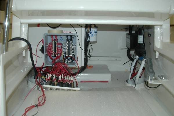

Finishing the wiring for the breaker box.
http://i57.photobucket.com/albums/g2...nes/csc199.jpg

Bobv 08-01-2008 10:06 AM
Re: A New Boat to Check Out
The 110v plug underneath the console was placed so that I didn't have to hard wire the battery charger. It is wired to an external plug in that is located under the gunwale, so that it is hot when plugged into an external source.
Here are some progress pics of the top that I forgot in my last post. It was painted, pre-wired, and then placed.
http://i57.photobucket.com/albums/g2...nes/csc195.jpg
http://i57.photobucket.com/albums/g2...nes/csc196.jpg
http://i57.photobucket.com/albums/g2...nes/csc201.jpg
http://i57.photobucket.com/albums/g2...nes/csc202.jpg
Almost there!
