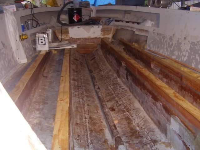

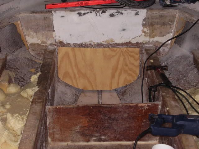

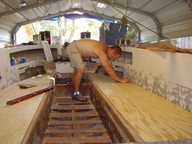

here is where we are today. getting a little closer. going to put storage/fish box under deck where the original was taht was cut out

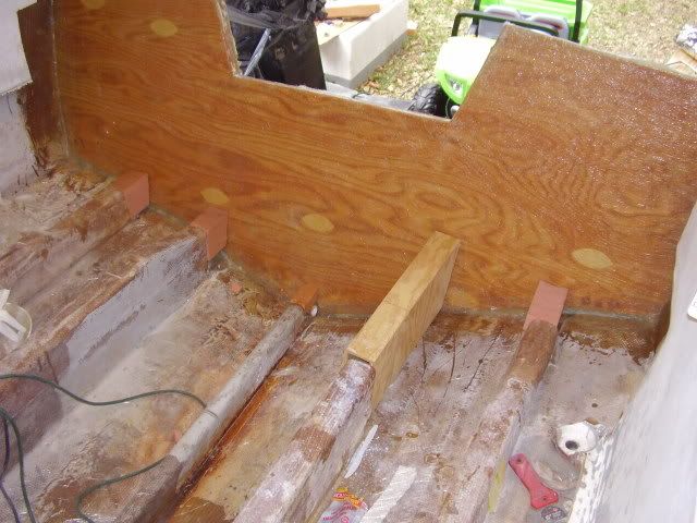

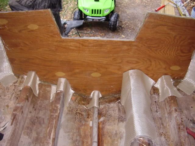

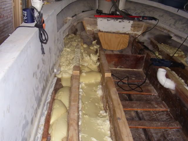

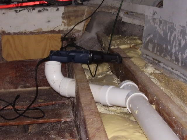

grgmouse...i pretty much copied Strick and the others here on the transom rebuild. Closed cell foam and then covered it with woven/roven. I don't know all the technical names for each individual piece of Mat/Cloth etc. I just show up at the fiberglass house with a checkbook and legal tablet. I think you could drop this boat stern first on concrete and it woouldn't budge though. Here are a few pics I tought I had already included.
http://i216.photobucket.com/albums/c...console093.jpg
http://i216.photobucket.com/albums/c...console094.jpg
http://i216.photobucket.com/albums/c...console092.jpg
Blue...I think I am going to build those seats up to the gunnels with hatches on top.

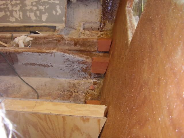

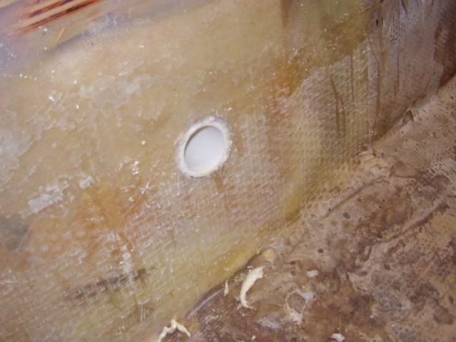

Thanks. I hear ya about the glass. I've got so many rolls of different kinds in my little shed! I've had a huge learning curve getting up to speed. Luckily, like you, I've had some great resources like this site to lean on. Looks good. Keep it up! I also noticed I didn't see any limbers in the stringers around what looks like it would be the "bilge". Are there none or just not photo'd?
skipjake04 09-08-2008 10:53 AM
Re: Update
here is one of them, i jsut didn't post them
http://i216.photobucket.com/albums/c...4/grady005.jpg
