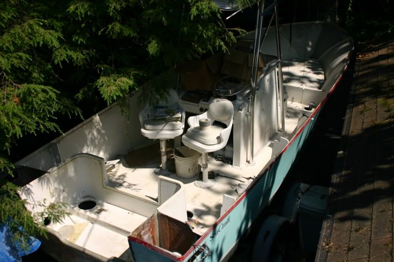

I finally got time to work on the vette today, and as it turns out, this is one of the easiest transoms I've done! I just fell out. The accual wood had turned to potting soil so it made the job quite easy.
http://img.photobucket.com/albums/v4...l/vetteTr1.jpg
http://img.photobucket.com/albums/v4...l/vetteTr2.jpg
http://img.photobucket.com/albums/v4...l/vetteTr3.jpg

Finster 07-21-2005 07:22 PM
Re: Finster - any more progress - pix ?
Ya ever see so many hole's in a transom? I got her all cleaned out and justa'bout ready for new.
Stony, I'll get a pic of the inside in a little bit.
Oldbluesplayer, try using two claw hammers. Hit the claw in and try prying up. It worked pretty well for me. I cut and cleaned this whole transom in about 5 hrs.

Finster 07-22-2005 11:58 AM
Re: Fin - lookin good -
No all the threw hulls are out. And yes I'll put a few layers of glass on the inside and layer up 3/8 ply with a couple layers of matt in between each sheet.

stoney 07-25-2005 10:33 AM
I did mine from the inside. I had over 50 holes in the transonm. The boat was originally dual outbourds. I had to do the deck cap also.
http://i15.photobucket.com/albums/a3...Picture001.jpg
http://i15.photobucket.com/albums/a3...Picture005.jpg
