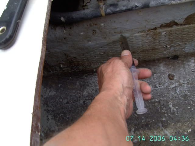

I too am not a fan of drilling holes in a perfectly good boat, but I have to say I love it. I can sit in my bilge and work on anything. I also found a slight top layer delam on my port stringer, which I never would have known about. Was a little damp. Now dry and solid.

stringer fix
http://i245.photobucket.com/albums/g...ideopen164.jpg
