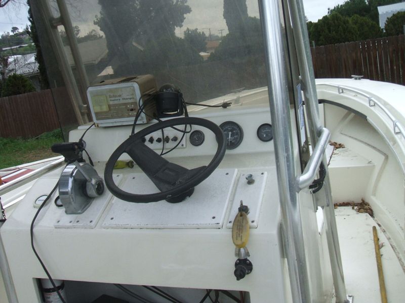

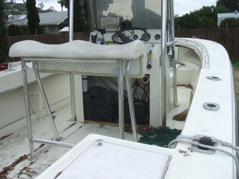

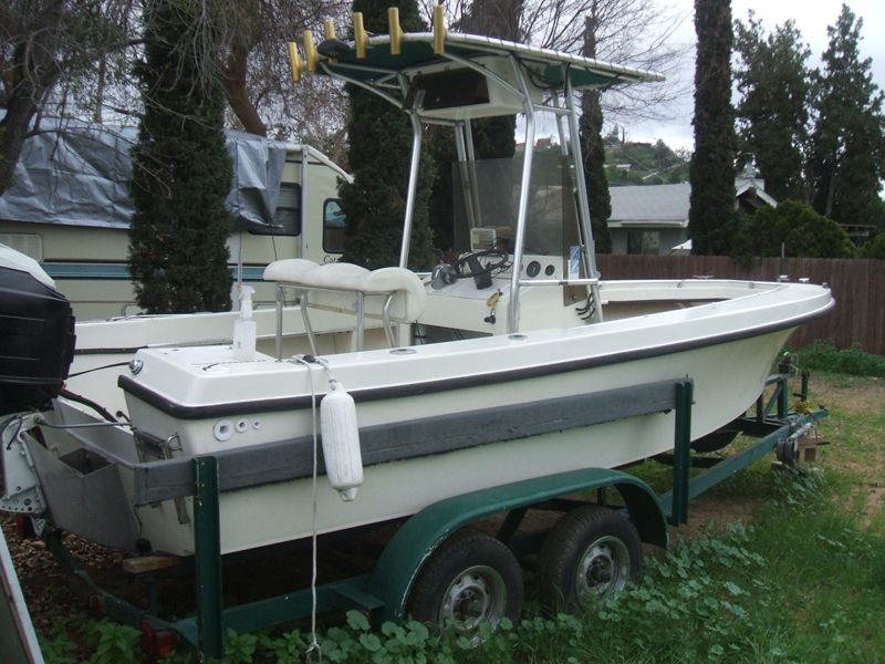

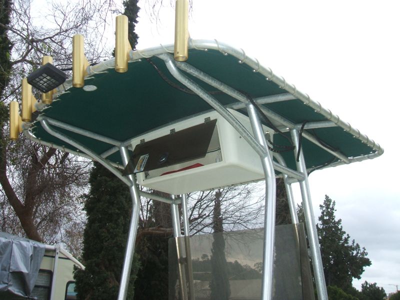

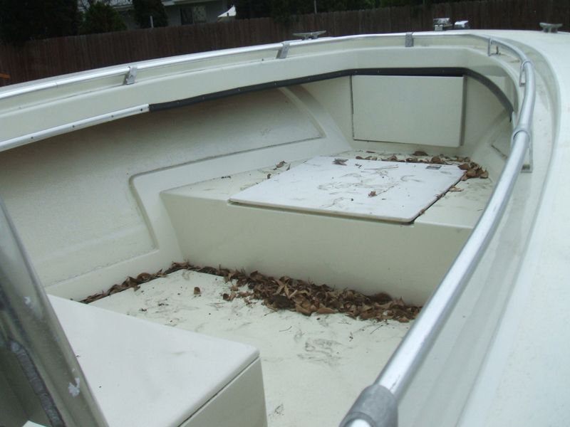

I'm looking at this boat tomorrow and would appreciate any thoughts from those who know more than me about Sea Crafts.
It's obviously due for a repower and could use a galvanized trailer but if the price is right I might be able to take care of those issues fairly quickly. I'm wondering if the short OB bracket is a plus or a minus?

looks like they used the bracket to put a 25" motor on a 20" transom. I custom made one for my 78 conentental for the same reason.
jorgeinmiami 02-21-2013 03:53 PM
That trailer has to go... only mine is worse. I run mine with out the bracket and I like the way it runs. And it does look like a 25" engine on a 20" transom

Jon, how much is the price that's right?? That's the big question!! The t-top looks really nice as well as the hull. Not sure what scrap metal prices are, but that's about what the trailer is worth....especially after you dunk it in saltwater. Great looking project boat, good luck.

It has cable steering that is stretched out to the max..
The forward hatch looks like starboard..
The trailer speaks for itself...
The bracket looks like a jail house urinal..

Dido on what nobones said above. It's got a 20" transom . . . probably original and will most likely need to be done. Plan on spending some money if you buy that boat (transom + fuel tank + hoses + steering + batteries + all wiring). Check for other soft spots in deck, hatches, and gunnel cap. Replace the brass tubes (scuppers) and the deck drain in forward fish box . . . those tend to leak if they have not been redone. That merc can be a good motor . . . but that one does look particularly well cared for.
