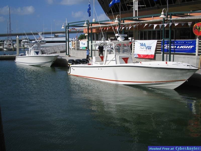

Here are a few examples of what it could look like (this is a 31’ SeaVee boat)
http://www.cyberangler.com/photos/wa...ee-6-25_02.jpg
http://www.cyberangler.com/photos/wa...ee-6-25_03.jpg
FellowShip [img]/images/graemlins/grin.gif[/img]
