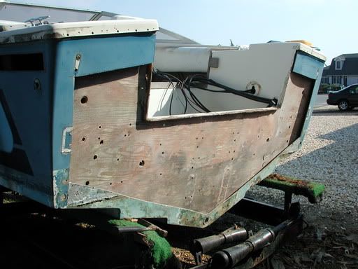

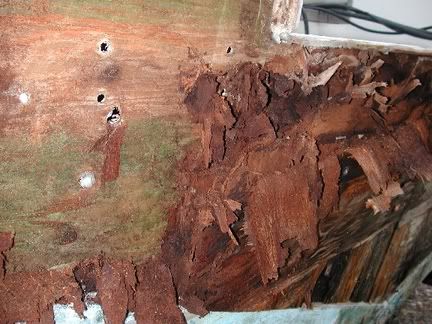

I finally got time to work on the vette today, and as it turns out, this is one of the easiest transoms I've done! I just fell out. The accual wood had turned to potting soil so it made the job quite easy.

Wow .... Its no wonder that big old Black Max bounced around back there. I don't think the now infamous security chain would have done much in keeping the motor attached to the boat. I can see now that I took my life in my own hands when cruising on that craft ... And you call yourself Captain !!!!
I was starting to wonder if the Vette was going to turn into a flower pot from sitting there. [img]/images/graemlins/tongue.gif[/img] [img]/images/graemlins/shocked.gif[/img]

anyway it's amazing how strong fiberglass is...it can keep everything together enough to go boating even when the transome is dust [img]/images/graemlins/blush.gif[/img]

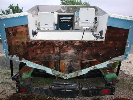

Ya ever see so many hole's in a transom? I got her all cleaned out and justa'bout ready for new.
Stony, I'll get a pic of the inside in a little bit.
Oldbluesplayer, try using two claw hammers. Hit the claw in and try prying up. It worked pretty well for me. I cut and cleaned this whole transom in about 5 hrs.
