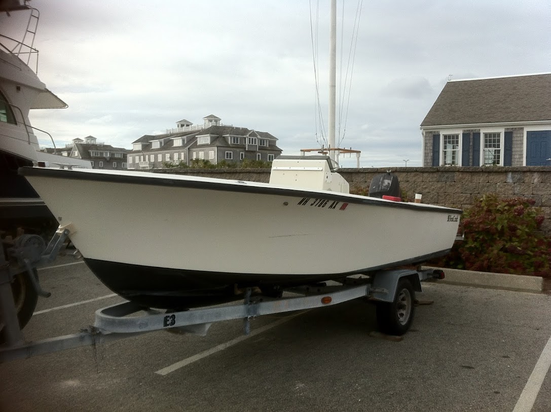

Here she is before work had commenced.
Hull is in pretty good shape for 38 years old.
Not too bad looking.
