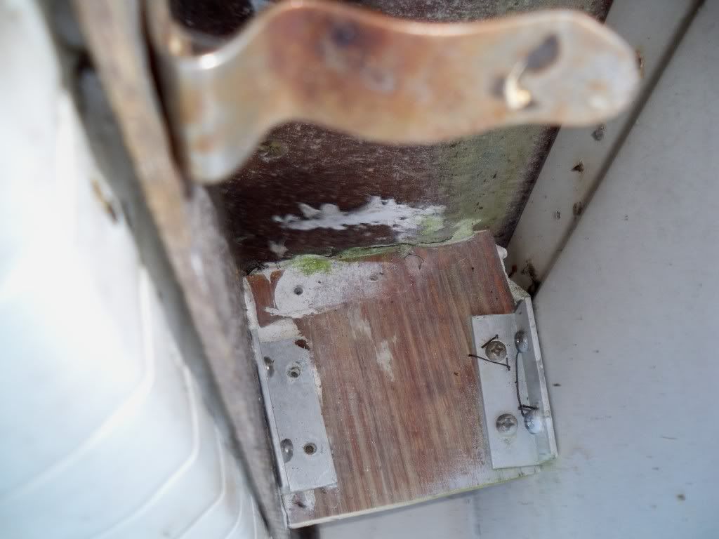

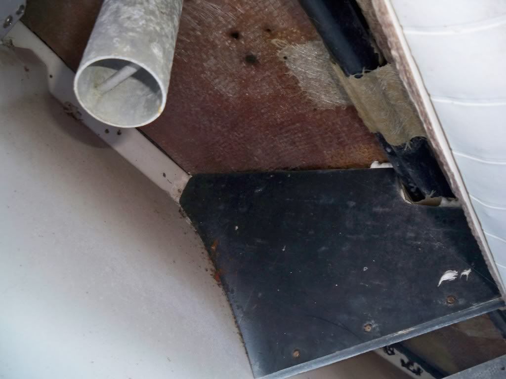

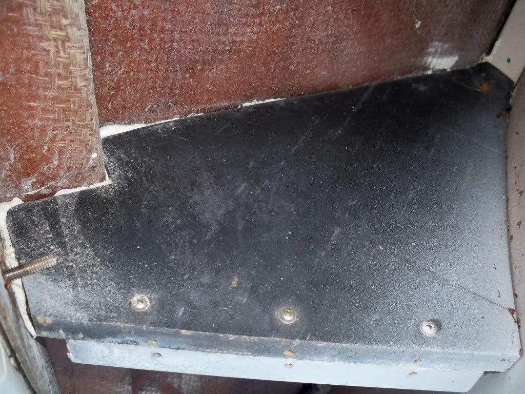

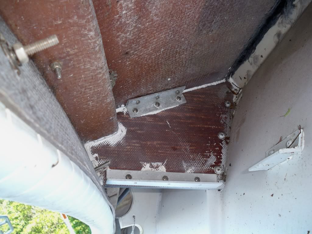

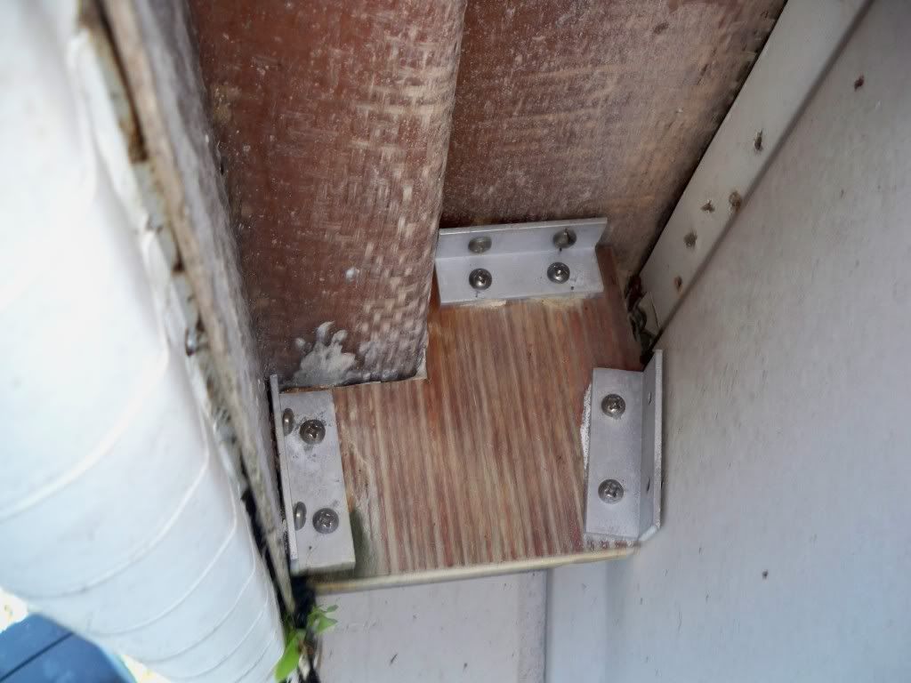

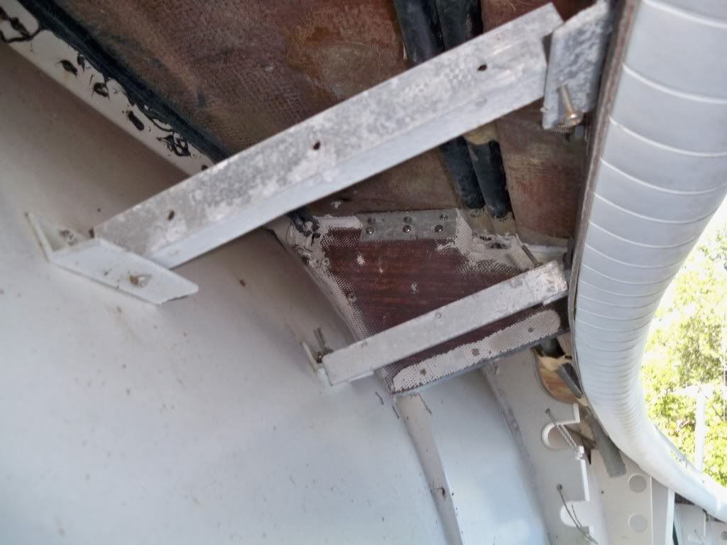

Old 11-13-2009, 03:23 PM
Default Re: Anyone ever under brace/knee the gunnels?
Not wanting to mar the hull prettyness think am going to brace/knee then. although i like the idea of glassing wood to the hull and screwing into that for the u clamps as an alternative worth exploring. I may do both in the spirit of structural integrity now better than a torn up gunnel later.
The winter boat work-list grows .
thanks guys...
Josh-
I have taken pictures of my 23SF's knees and brackets.
I didn't install them, and they look bad, but they work. FYI - The bolts are screwed into the liner not all the way thru the hull to the outside. The original owner was a charter captain with similar issues probably with heavy gear putting pressure outboard of the boat. And/or just to beef up the the cap with normal wear and tear of a 1979 Jackshafted diesel that was used daily!
Here are the oversized pictures(sorry for the large size!):

Thanks for the pics and ideas! These are 130lb class rods/reels with 12" bent butts for going after medium and giant bluefins, north of 200lb fish. The tuna Steve caught on spinning gear last weekend on board was a small fellow at around 175-200 estimated
Nothing out of ordinary as to length of rods. Certainly no need to replace them ! [img]/forum/images/graemlins/tongue.gif[/img] And not at 400-600 a rod.
The bow swivel location is really about fighting a fish without worry of the line hitting the prop during the fight. You won't be trolling from the bow. If kiting or live-lining or chunking I guess could use the bow swivel location. Adding a swivel up front does make sense so will do so this winter. Good boat handling no reason to not fight out of the current swivels though.
So imo I have no choice but 2 address the gunnel flex issue. The murphy factor still lives that someone on the boat slides the drag lever up when being spooled in current swivels. Before I stop them. Hell it could be me in the tuna fever throes of not wanting to lose a big fish.
These gunnels already have betwen 1.25 near transom, and 2 inches+ of wood/glass layering next to console. Somewhere in the past someone went way over-kill on the gunnels already! The swivels have ss backing plates now of note. They still flex outboard. It was obvious with Steve when we put some simulated outboard weight and drag, that the flex was way more than the comfort zone and in the battle with a big fish needing say more than 25lbs drag that 130's can throw down, would be seriously problematic.
Net is gotta solve the outside flex issue no way around it. Looks like bracing/knees and u clamps are the way to go.
And those pics are not ugly! Its under the gunnels! Someone being the critic on that had better be a good swimmer!
