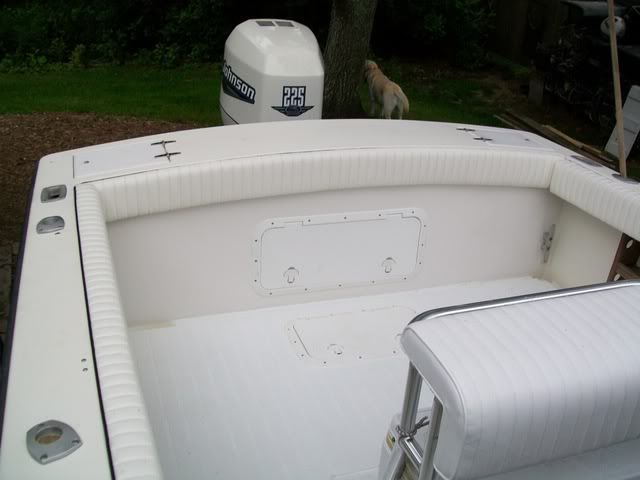

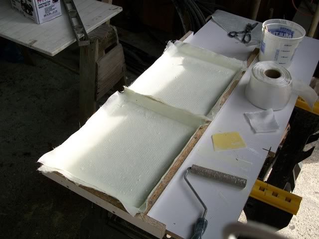

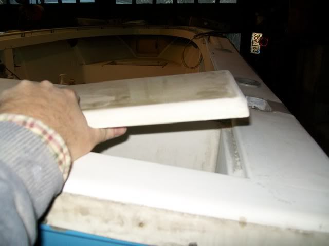

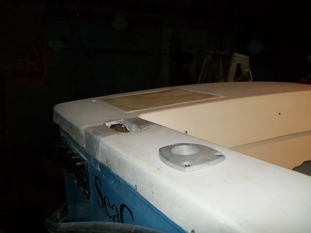

I made my own corner box lids....and I suck at making these fiberglass parts. Mine are just about 4 layers of glass...no core...and they are holding up great. Used white pigment epoxy and painted to match.
