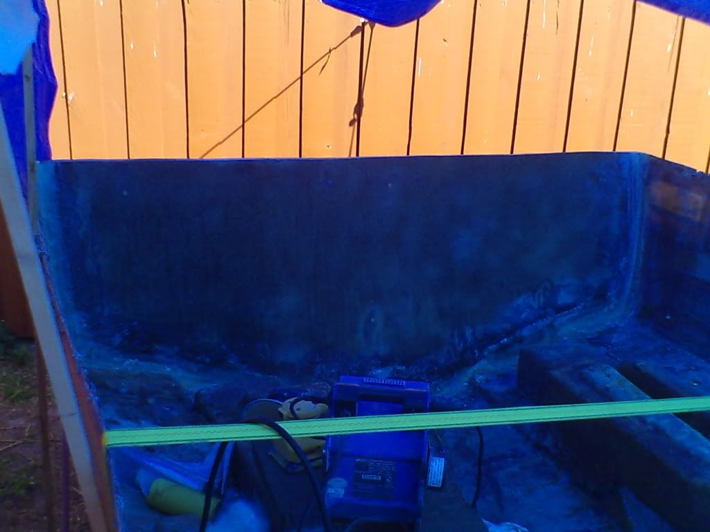

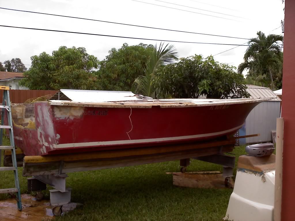

Hello all. let me start by saying this site and its contributers are the best thing going for the survival of the classic boats we all seek. the posts by the ppl restoring seacrafts have irritated my itch long enough. and after a year long, exhausting search through most of florida for the right project, last summer i found just what i was looking for. a 73 seacraft superfisherman, stripped to the hull ready for restoration.after restoring several for customers in my earlier days i found with hulls afordable i would take advantage and build one to MY specs [image]http://[/image]

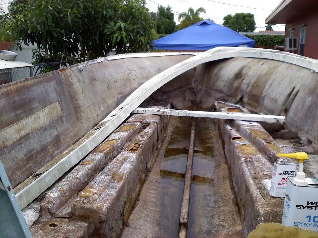

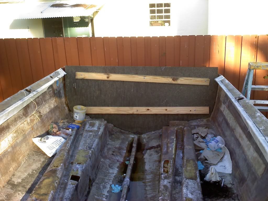

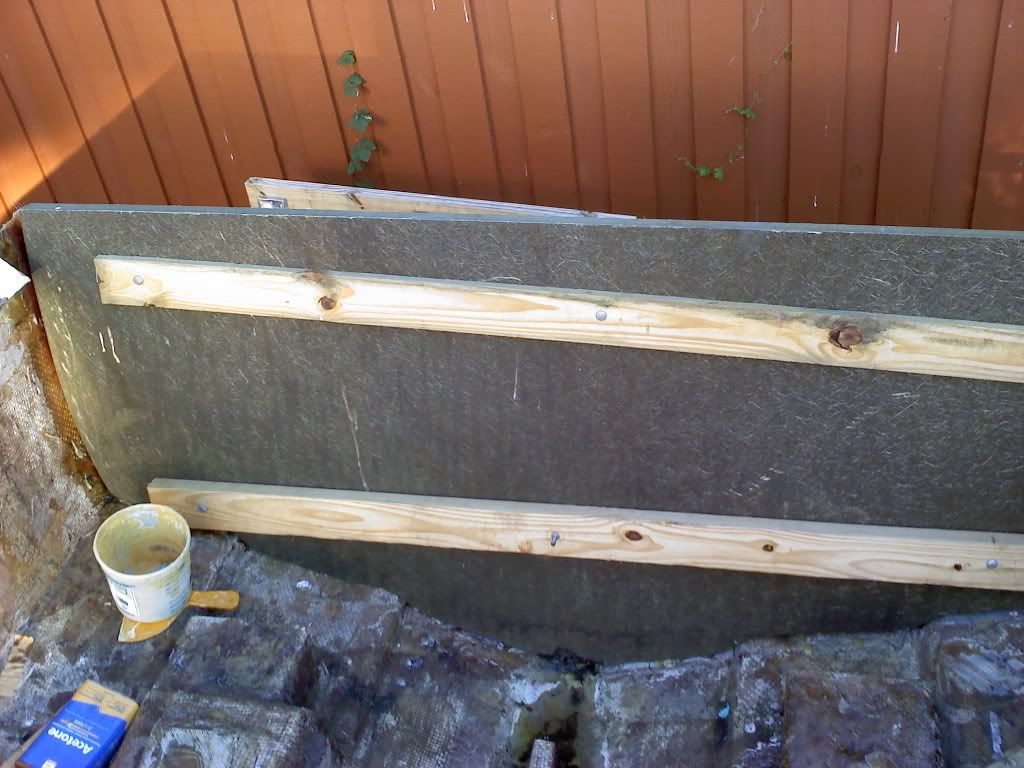

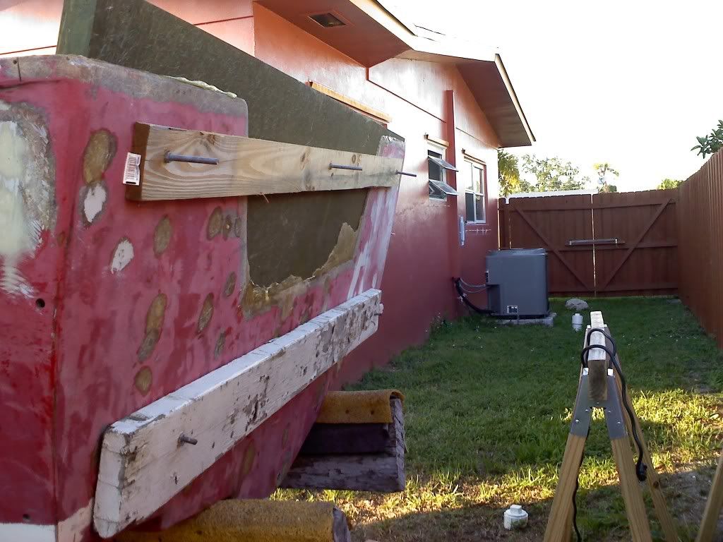

I bought the boat, after an extensive search, in the ft. meyers area, from a gentlemen who, lets just say was going through a divorce, and had to get rid of it. he threw in a sheet of 3 inch thick divinacell for a hundred bucks more. which paid for the trip. i temp-lated the transom and cut out of the divinicell

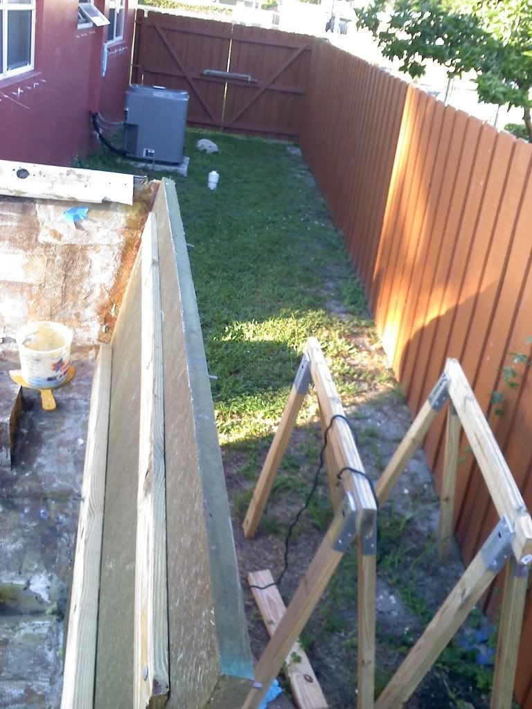

as you notice from the template, i intend to enclose the transom and bracket the motor. the divinicell transom was attached with a mixture of west systems mixed with cabosil to a buttery texture to spread evenly and coat between the hull and new transom. i used a method learned on this forum to clamp while bonding the two surfaces: 2* 1 inch boards (many thanks to strick, for the idea, it sure beats the 100 taping screw method i used in years past.
P.s. sorry about the upside down pic. u get the idea. i have not had the time to figure how to flip it from photobucket to this forum. but lets move along.. more pics:
with the transom in place i am ready to move along. fournately the stringers were re foamed by the previous owner, so that is one less worry. after i glass the transom in from the inside, i will use the divinicell as walls to tab the stringers to the transom, and pour two part foam in the middle to finish the stringers. more to come as progress takes place.

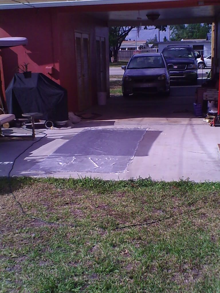

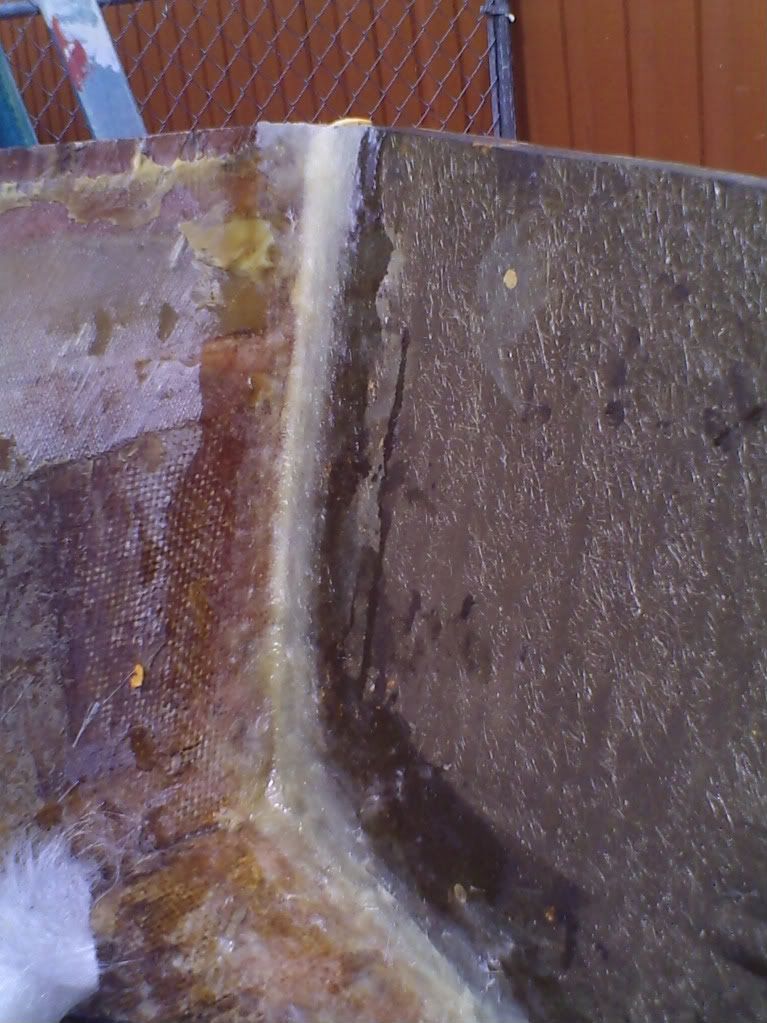

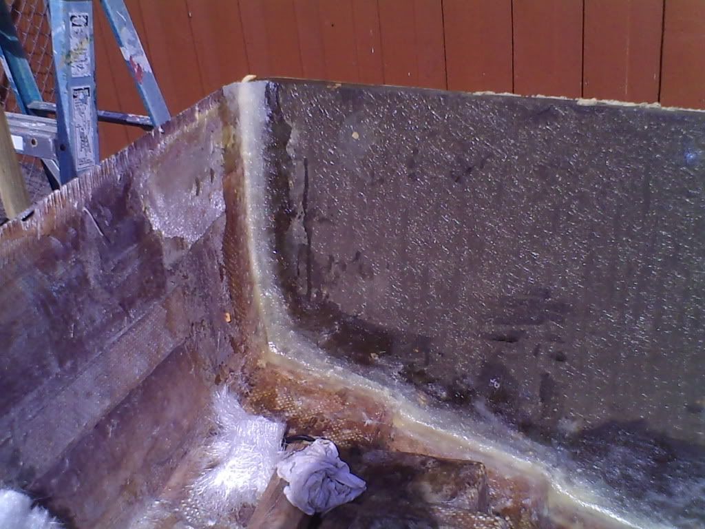

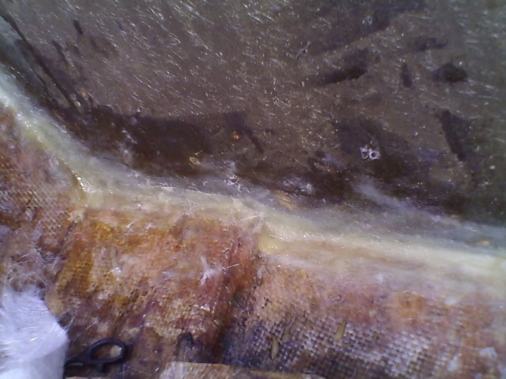

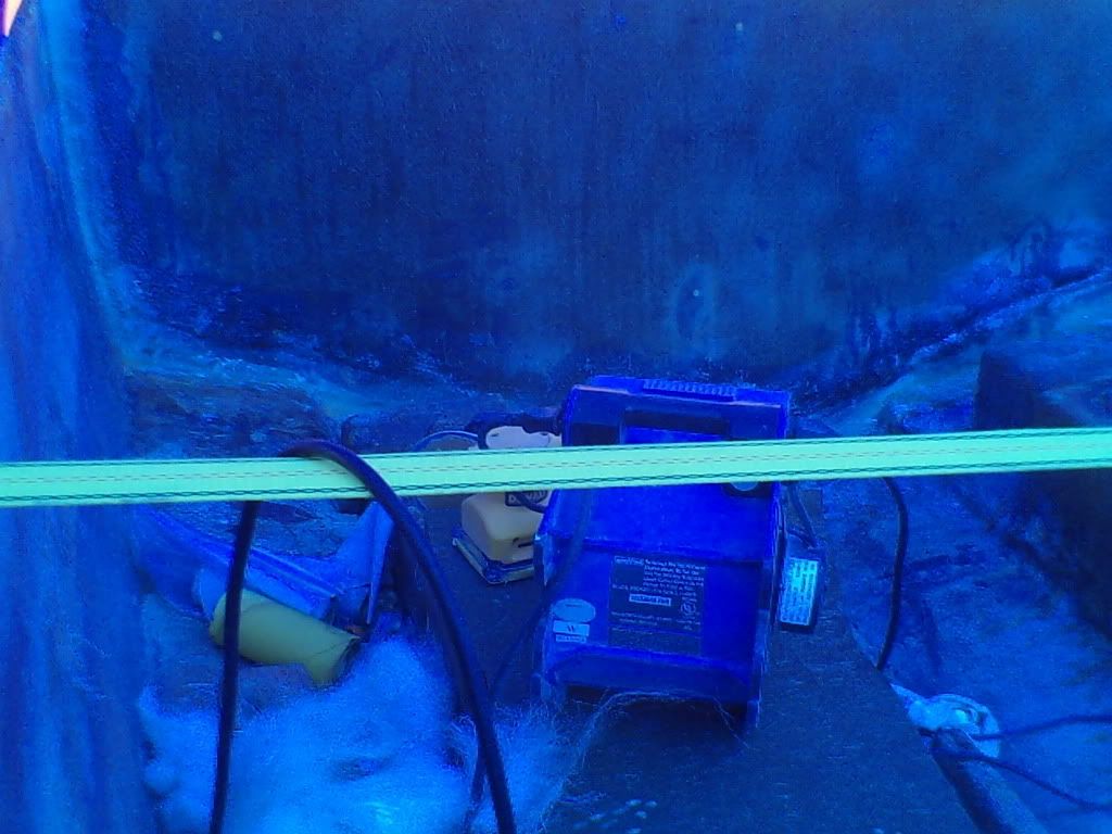

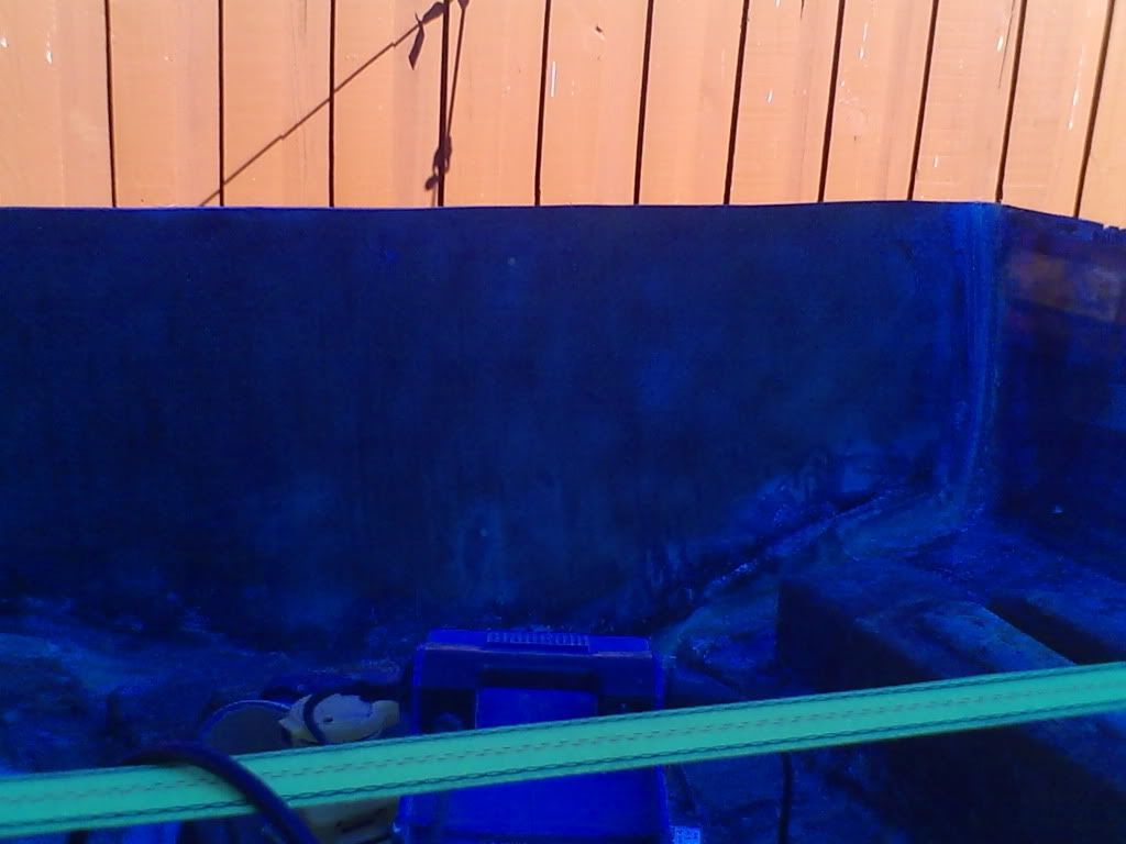

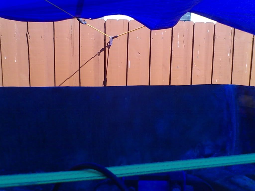

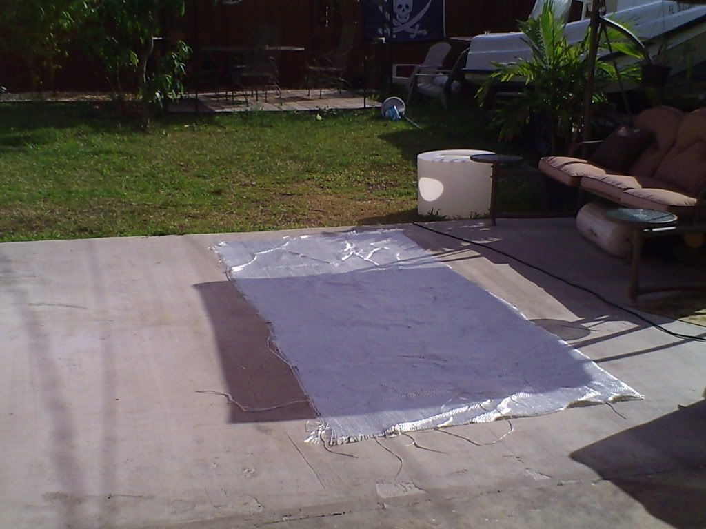

Allright, i continued by filling whatever gap between the foam for the transom and the fiberglass with epoxy/ cabosil mix, than toped off with mat.
http://i1190.photobucket.com/albums/...eeye/045-1.jpg
http://i1190.photobucket.com/albums/...gleeye/046.jpg
http://i1190.photobucket.com/albums/...gleeye/047.jpg
http://i1190.photobucket.com/albums/...gleeye/048.jpg
http://i1190.photobucket.com/albums/...gleeye/049.jpg

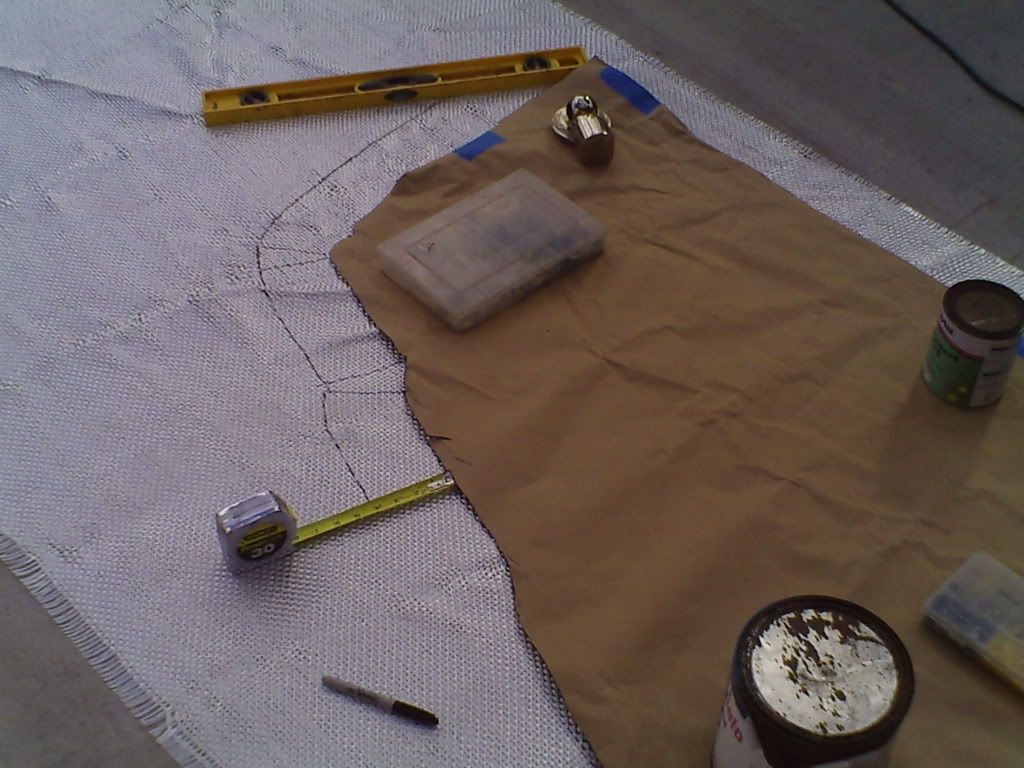

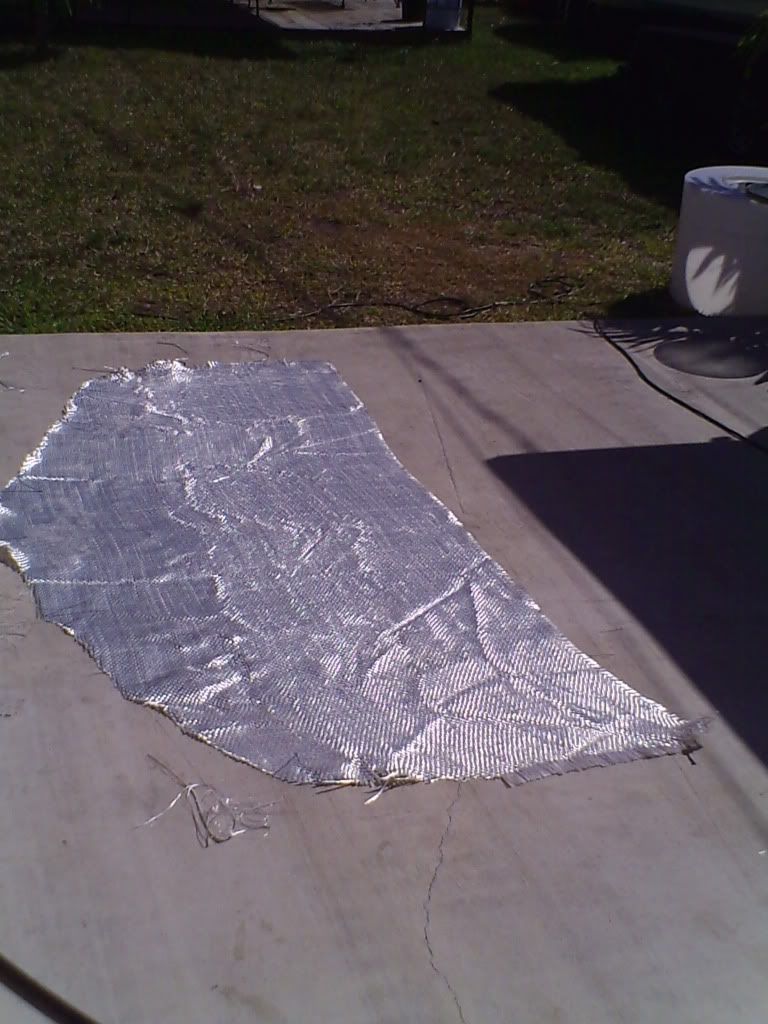

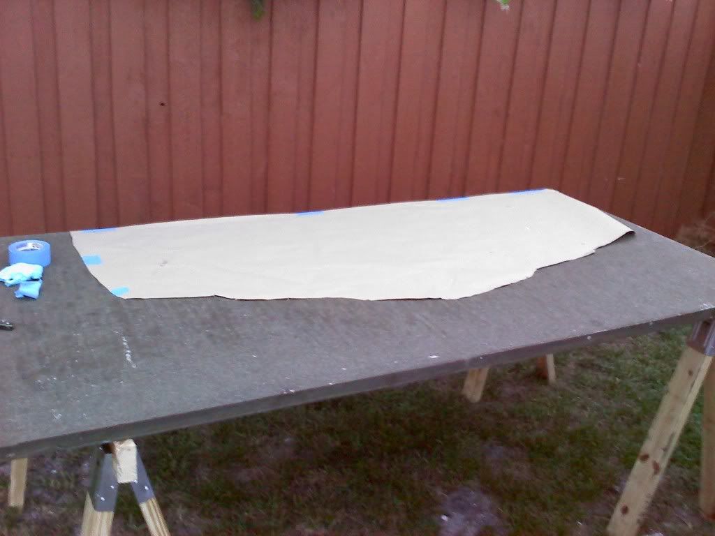

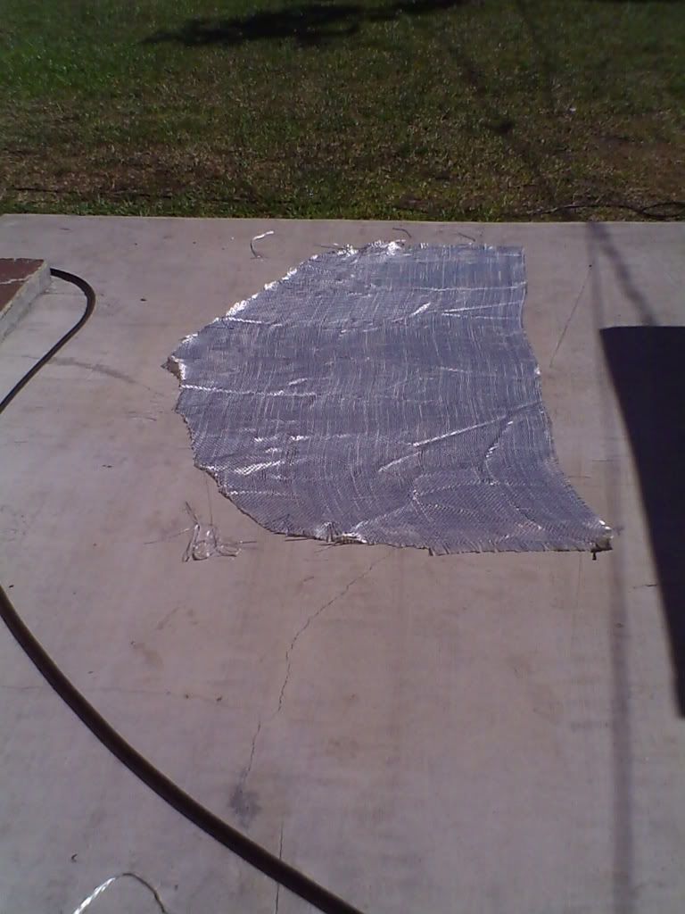

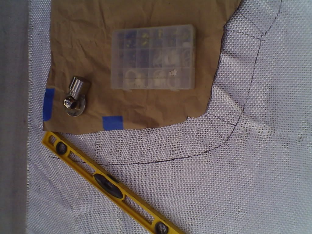

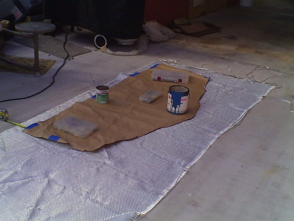

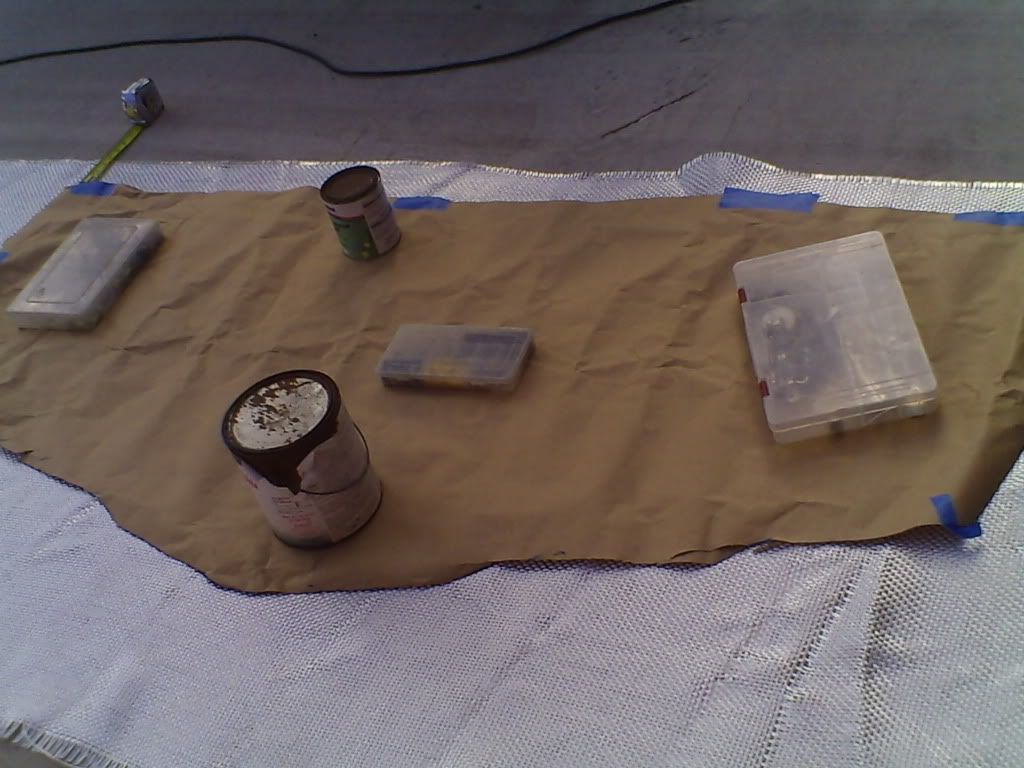

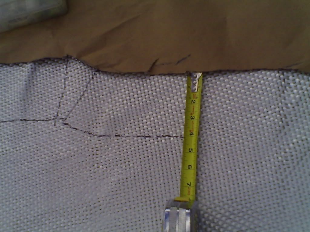

thats the edges of the transom cabo'd in place with 2" strips of mat. next i went to the transom template on the roven woven to laminate the transom into place

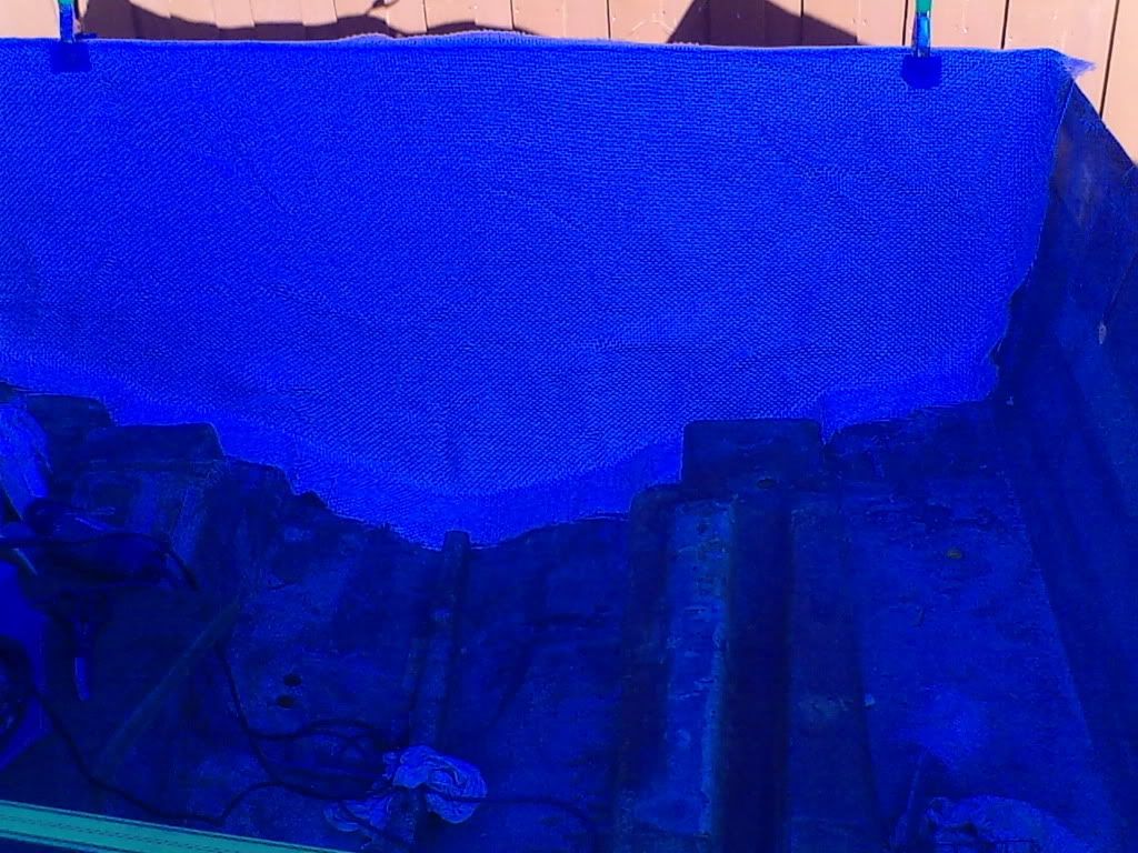

http://i1190.photobucket.com/albums/...gleeye/106.jpg
http://i1190.photobucket.com/albums/...gleeye/108.jpg
http://i1190.photobucket.com/albums/...gleeye/109.jpg
keeping everything in place wasnt easy with heavy winds!
http://i1190.photobucket.com/albums/...gleeye/113.jpg

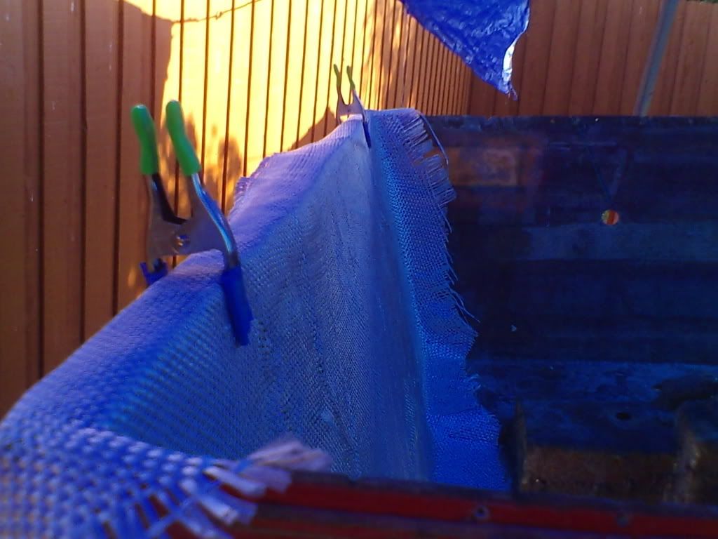

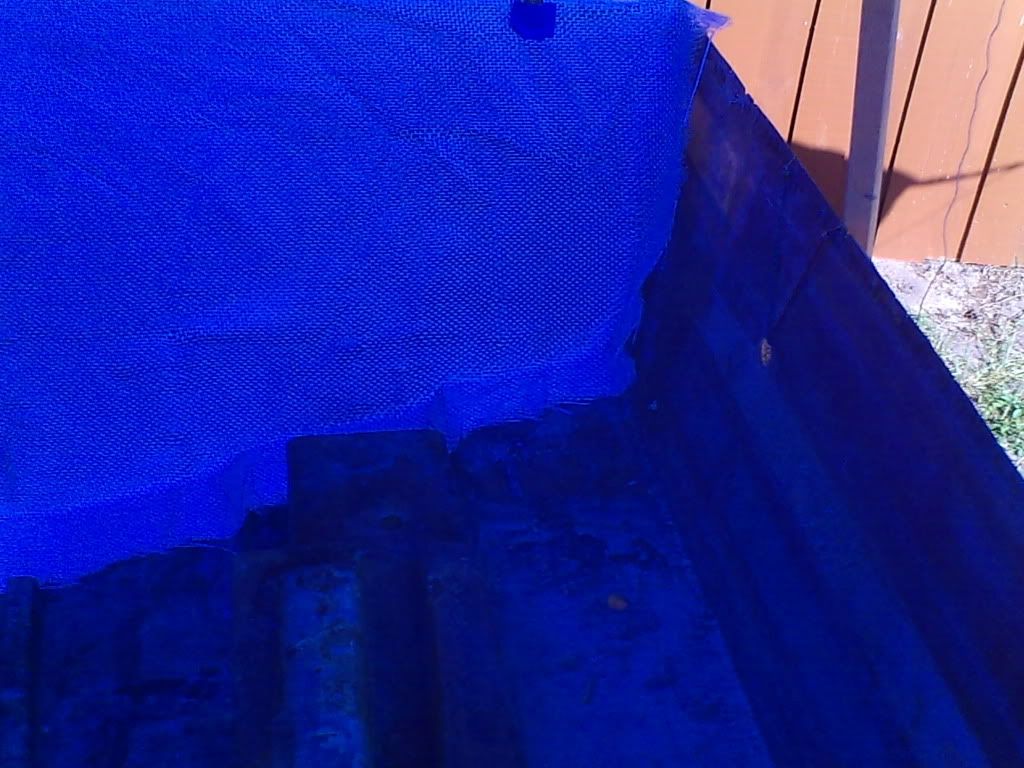

for the mating to the transom i decided to go out 4 inches on the sides and bottom of the boat
http://i1190.photobucket.com/albums/...gleeye/115.jpg
http://i1190.photobucket.com/albums/...gleeye/116.jpg
http://i1190.photobucket.com/albums/...gleeye/117.jpg
finished product
http://i1190.photobucket.com/albums/...gleeye/206.jpg
http://i1190.photobucket.com/albums/...gleeye/207.jpg

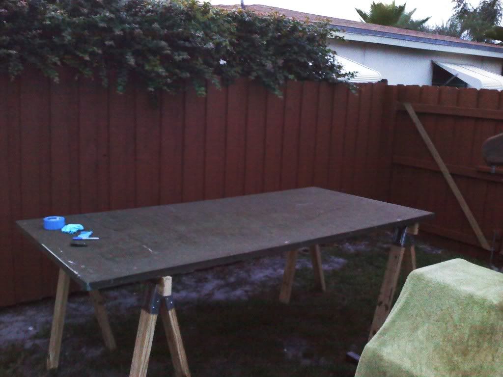

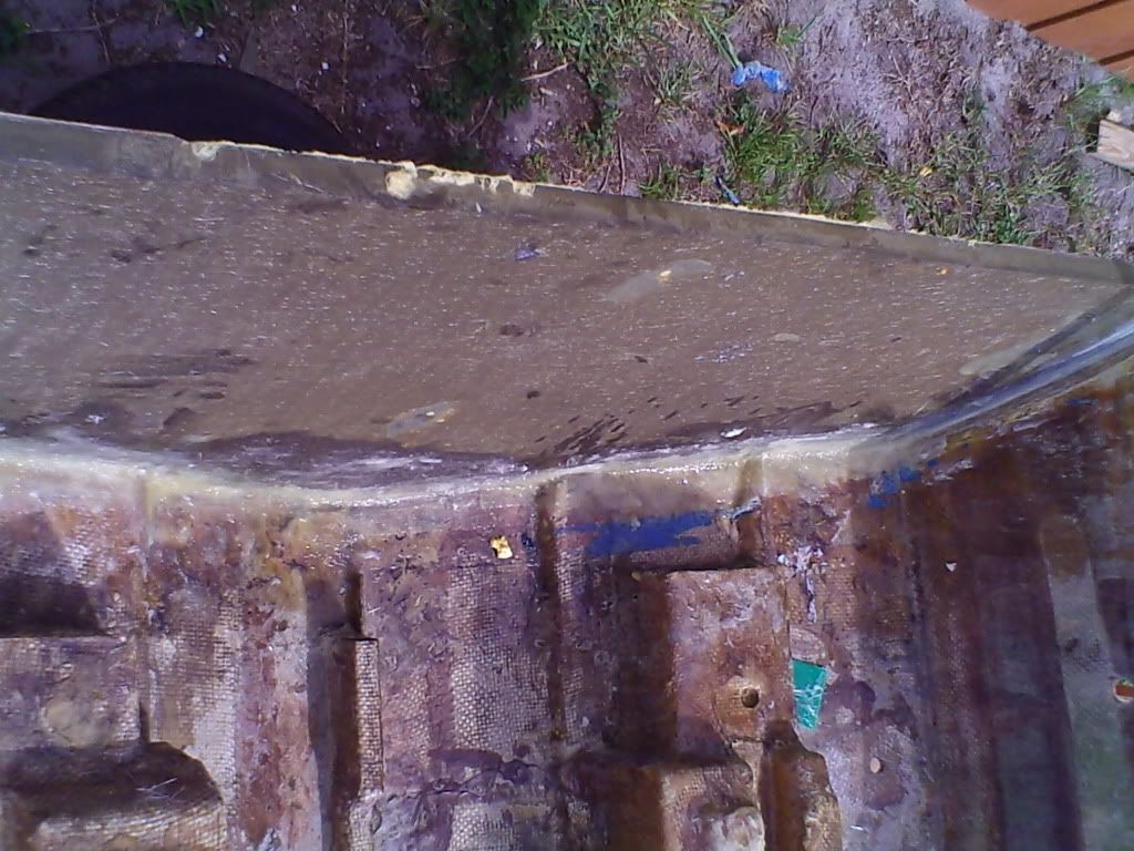

cleaning the transom for lamination:
http://i1190.photobucket.com/albums/...gleeye/208.jpg
http://i1190.photobucket.com/albums/...gleeye/210.jpg
http://i1190.photobucket.com/albums/...gleeye/211.jpg
http://i1190.photobucket.com/albums/...gleeye/212.jpg

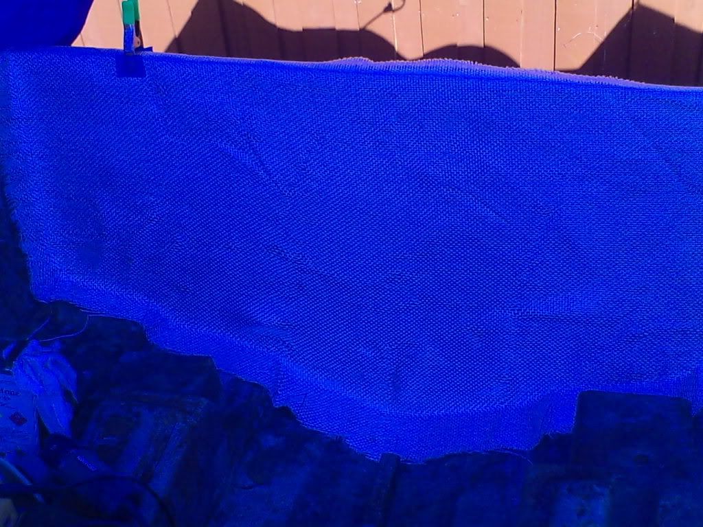

the dress rehersal:
http://i1190.photobucket.com/albums/...gleeye/217.jpg
http://i1190.photobucket.com/albums/...gleeye/216.jpg
http://i1190.photobucket.com/albums/...gleeye/215.jpg
http://i1190.photobucket.com/albums/...gleeye/214.jpg
