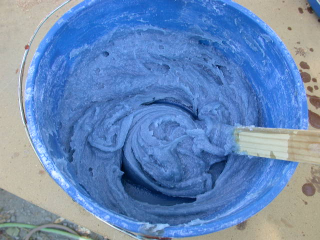

http://www.classicseacraft.com/commu...1&d=1318946804
Bigshrimpin is real good at making this stuff
What makes this blue? ingredients?
