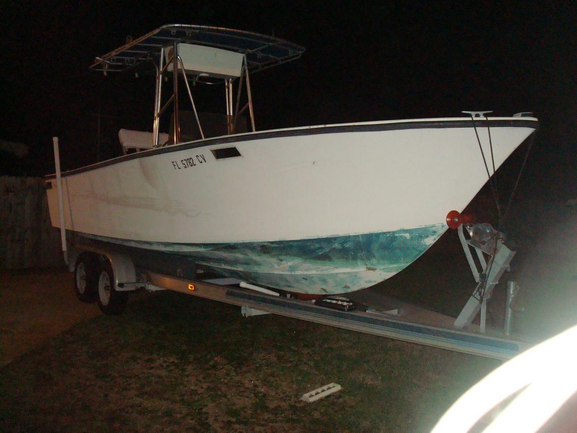

Finally after all these years searching .I bought a 23 ' sea craft 1976 From the Original owner ..It has all the original brochures and paperwork..Pretty cool stuff.. Looks a lot bigger in real life.. Anybody have any input on IO It has a Mercruiser 350 magnum and a bravo 2 outdrive.. anybody have any fuel burn numbers on this setup.. Thanks Martin
Old 02-21-2012, 09:21 AM
Most Mercruisers at cruise will burn between 8-10 gals. I speak from over 2000 hours of running them.
I wonder why it has a bravo 2? Most b2 are put into heavy duty type applications etc. diesel work, fish boats.

Here it is I guess it is a 250 hp with a bravo 2 Looking for 300 hp ..hopefully this is not to loaded for the boat.

Nice grab i saw her advertised on craigslist, what kind of condition is she in? show us some more pics!
