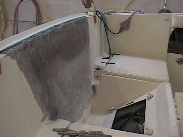

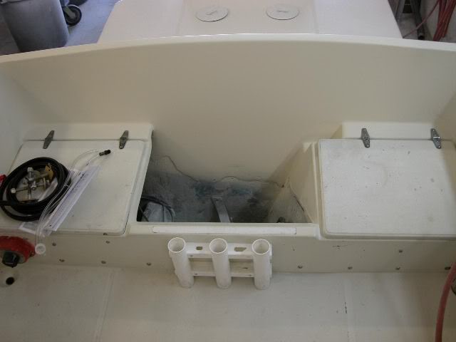

Use a batten across the top of transom on either side of cutout to establish the radius, like Don Herman did when he filled mine in.
Here's the result.
Old 05-12-2012, 09:40 PM
Location: Satellite Beach, FL
Posts: 375
What Denny said....That's a great looking transom!

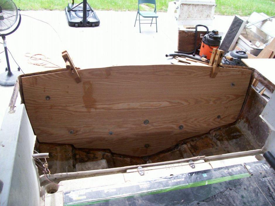

Default Followed the radius
I followed the radius and set it down 1/2" in case I use a plywood core there.
