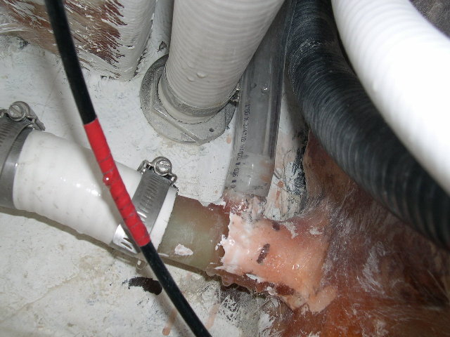

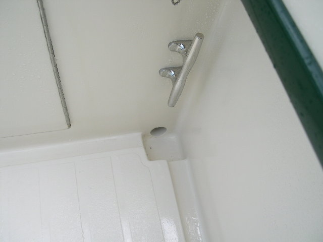

Default Floor Scuppers
23' s don't need floor raising. My Floor scuppers ran thru the transon even before my barcket install without issues. I raised them about 1" with this current setup.
1.) Fill / Glass in old Floor Drain
2.) Glass in fiberglass tubing
3.) Gemlux Flapper type S/S drain thru the transom with 5200
4.) Tie in drain tube & Scupper with ridgid bilge hose & S/S clamps

Old 10-13-2011, 09:15 AM
Jacquestrappe Jacquestrappe is offline
Location: Mass
Posts: 49
Default Capt Chuck
Thanks for those pics. Very helpful. That is exactly what I will be doing this offseason.
Quick question, when your boat is at rest are those scuppers above the waterline?
RC
Old 10-13-2011, 09:54 AM
RC
yes
