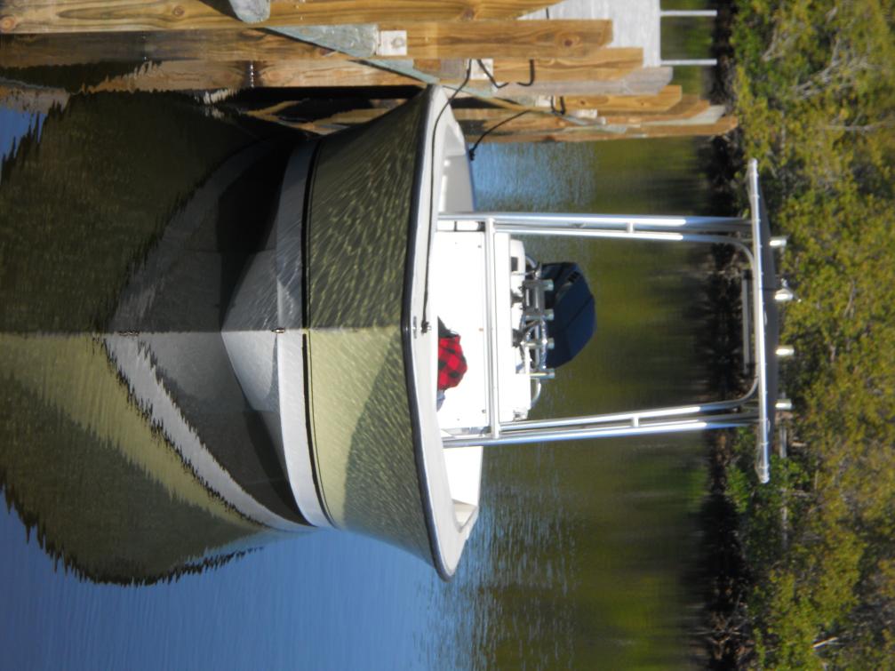

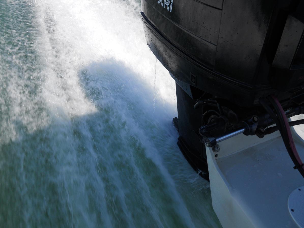

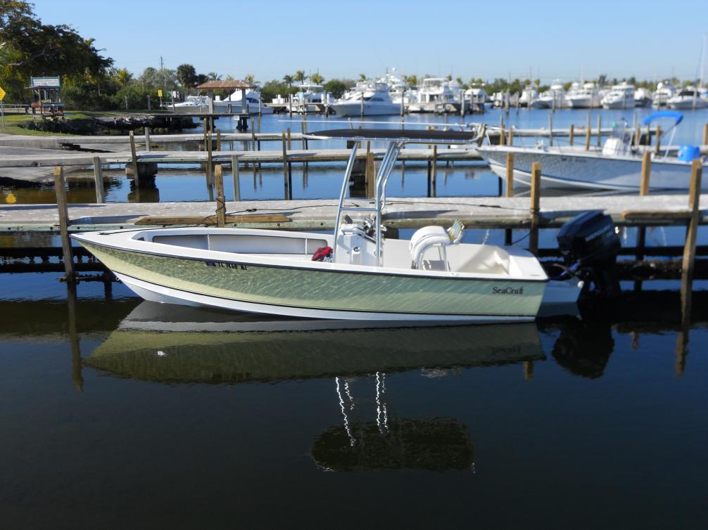

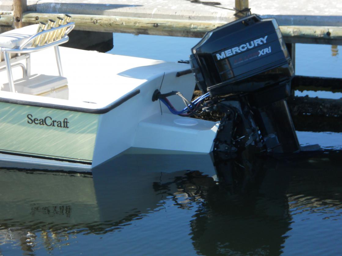

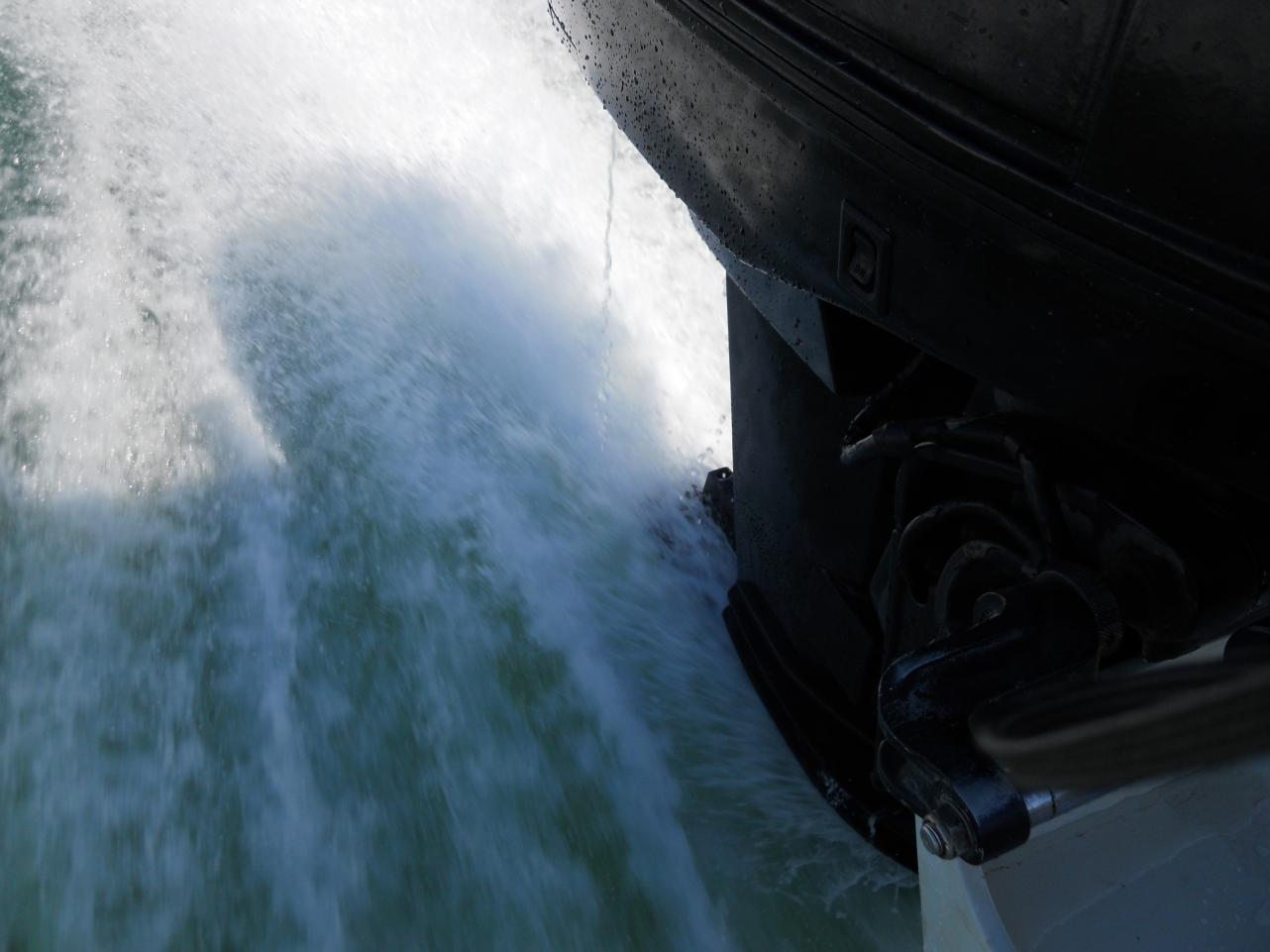

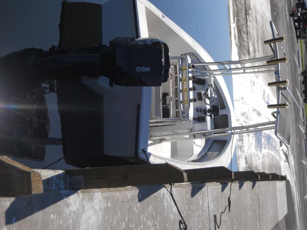

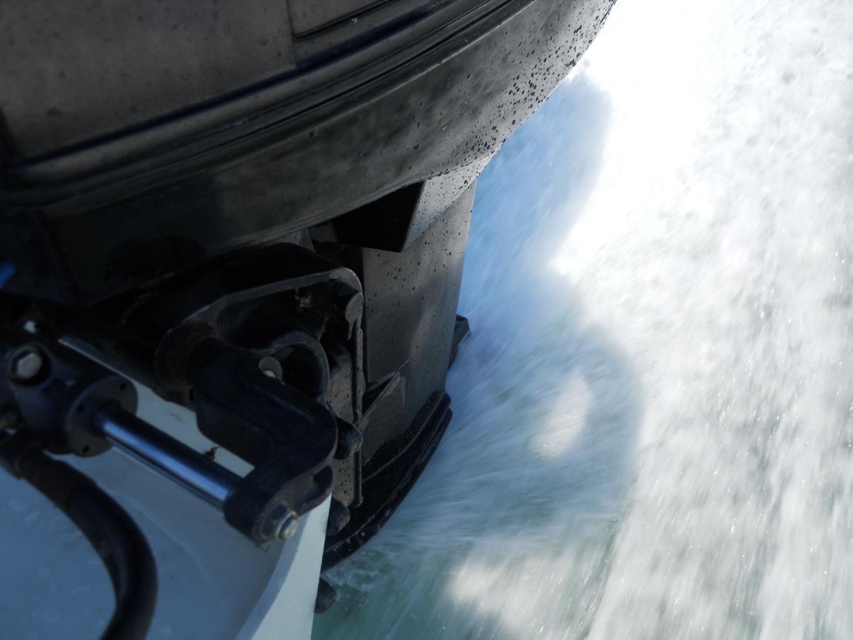

ok so i got her out today after 9 monthes and all this work, heres my numbers
3k rpm 20 mph
4k rpm 30.7 mph
5k rpm 39.6 mph
wide open 5600 rpm 48 mph
best slow planing speed i could get was 18 mph
i need to raise the motor to the last hole up.

Thanks guys, yea Mike it was at Boca Chita.. and strick thanks for all your posts on your build, the round ass on her is your brain child! stole your boats lines to the best of my ability.

same exact motor set up - numbers are very close although my cruise is better - after I raised mine 1 more hole - that thing likes it high.
29@3600 - 35@4200 40@4500 - have been playing around with the nice weather - top end is close I can get maybe 50
Raise it up it will help
