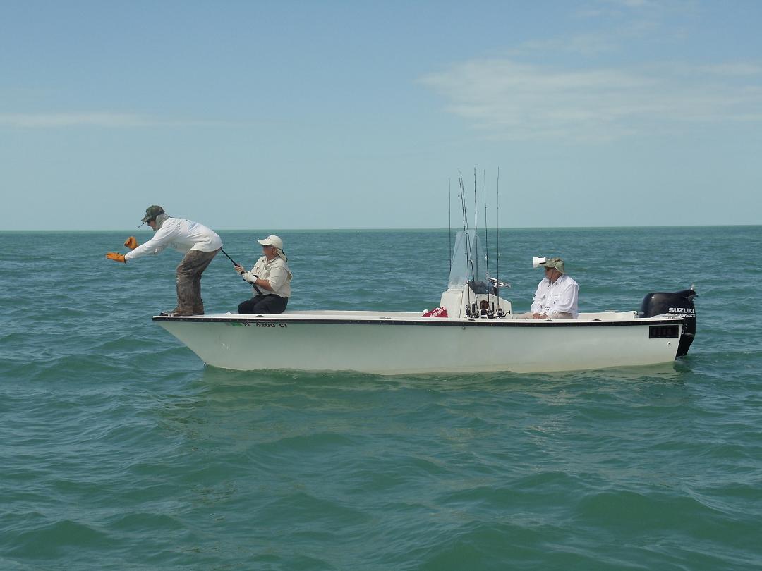

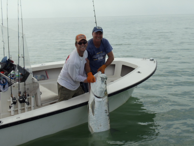

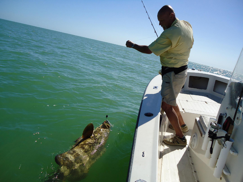

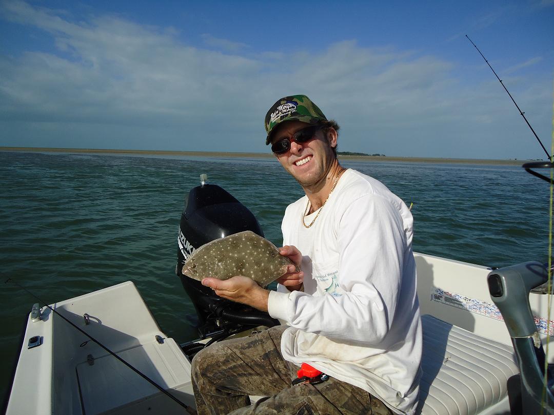

Unfortunately all my boat pics include fish with them as well! Maybe that's not a problem lol

Nice fishes. Unfortunately, the only picture without a fish looks a bit disturbing for the fellow at the pointy end
HAHAHAHA! Thanks for "pointing" that out. LOL. Yeah, those bows sure have a sharp entry.

I just looked again. LOL.
The dude behind the console: Yeah, that's ok. I'll just hang back here and fish... while seated.
