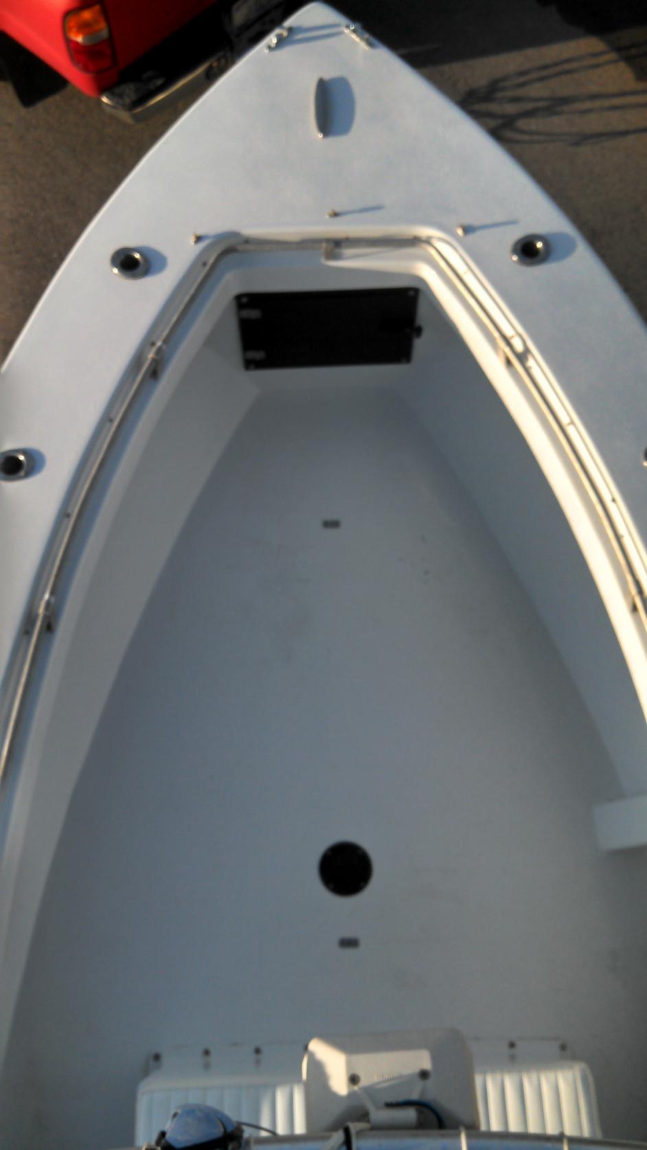

Man I could of sold u a nicely redone MA just a few months ago here n morehead. Either way I preferred the MA for my type of fishin. Fish the swansboro hole, come back n bottom fish then home on 45gals of gas. 9 wahoos and around 200lbs of bottom fish in a 20ft boat. Boat rode awesome. Plus I had huge tabs.
The look of SF is more appealing.
For catchn cobia my MA worked good w the flush deck. Had plenty of room up front to fight fish then once u put it n the boat u really didnt have to worry about it flip flop n out of the boat while it tore the inside up.lol
