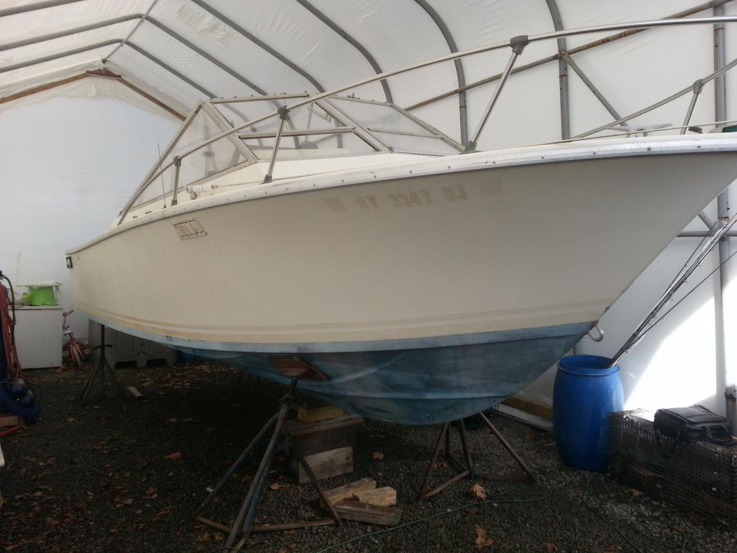

Another 73 Tsunami winter project added to the collection. Picked this one up on Long island yesterday.

Nice. I tried to get that one a couple months ago. At the time, the guy wouldnt move on the price. How does it look?

Going to be really nice when i get done with it. But it is not what the seller said, the transom is wet, needs a fuel tank, and the deck needs to be redone. The seller had to give it to me for alot less than what he wanted. This boat will be for sale in March of next year with power and turn key ready for a reasonable price. Keep an eye on it i will post pics of the resto as i go.

Ok this is what will be done, I am swapping out the windshield with a windshield that has tinted tempred glass, i am doing a new transom from the inside and regelcoating the outer skin, recoring 2 sections of the deck and regelcoating the whole deck with the original nonskid pattern. I am installing a mercruiser 350, along with bravo assembly and bravo 2 drive, replacing the 57 gal tank with a brand new 81 gallon tank. New teleflex steering with new wiring and gauges. So basically when i am done it will be turn key.
