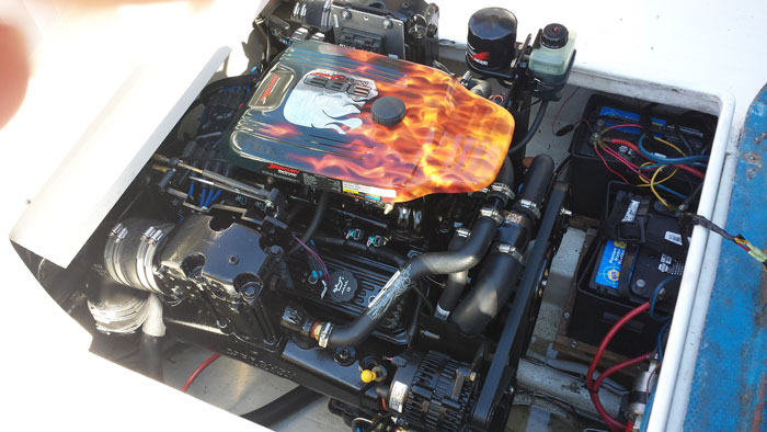

I am in the process of finishing my 73 Tsunami and upgraded to a 383 Stroker with a Bravo One. I am hoping someone could help me with any info that has the same setup. The prop I tested only let the engine get to 4800 and would like to get 5000-5200. Any info on pitch, diameter, would be great.

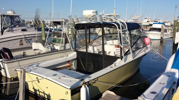

Thanks for all of the quick responses and the welcome. I think it is a 1.5 and have a top and arch on my rig. We were lightly loaded and just wanted to see what it would do since spent last summer restoring the boat. Doe anyone have the info on the diameter of the Merc Mirage Plus 17P?
