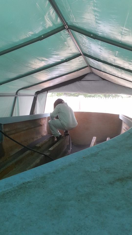

Whoever recommended sandblasting as an alternative to grinding is my hero. I only bought one bag of sand because I wanted to see how well it worked but it worked amazing! I would say that it would cut the prep time for new glass in half even figuring in the the cleanup time. Plus, I think it works better because it gets all the nooks and crannies that a grinder wont get to. I highly recommend it and thank you to whoever gave me the idea!!

I'm low budget here. Its a harbor freight blasting tank with a harbor freight deadman blasting gun. The media is just black sandblast abrasive for autobody work. It cuts through stuff fairly quickly. My compressor is most likely around 90 psi. Its just an old craftsmand 5 horse 30 gal. It doesnt keep up so I have to stop occaisionally and let the compressor catch up.
One question I did have was if there was an expiration date to the fresh surface. Say I blast the whole thing and dont lay glass on it for a month or two is that ok. Ideally id spend a day blasting and cleaning out the whole interior so I can do my stringers etc but I may not get to them right away.

You should still wash before and after you sandblast- I did acetone/blast/acetone with about the same setup.
Sanel's in Concord has bags, but you can get pallets of black beauty at the PSNH plant in Bow.
I don't know about "freshness". I think rough and degreased and clean is key. I think you can blast and then wait as long as it is clean. I suppose the polyester oxidizes, but I don't know. Some say a styrene monomer wipe instead of acetone is better, but that's a LOT harder to find.
