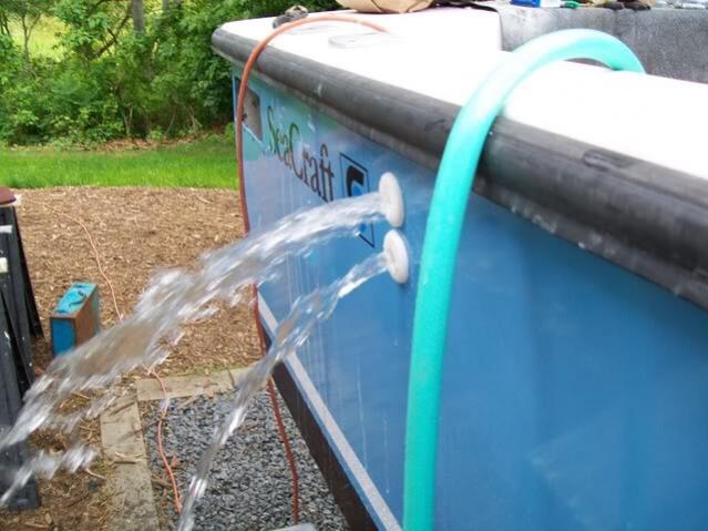

Here is what I did. No issues after 6-7 yrs. One is a 500 auto pump and one is 2000 switch (float and dash). Both wired direct to separate batts.
1974 23SF

Thanks everyone. Someone told me not to drill a hole within 9" of another hole for structural purposes. They must have been referencing a lesser quality boat!
I was going to try to offset the holes to get more distance but I like the looks of Hermits stacked setup better.
