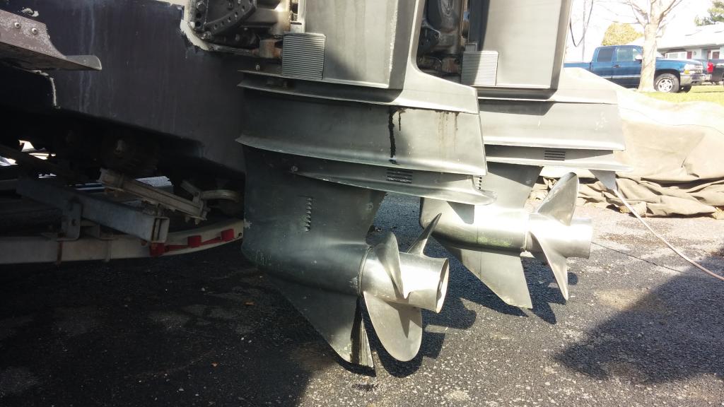

Fired up both engines today. Neither were pumping water. Came in, ordered new impellers and when I went back out, I saw these oil leaks. Any idea what I need to repair them? The engines are 135 Mariner Marathon 135, on a 1986 SeaCraft 23 ft. WA w/ cuddy.

That may just be 2-cycle oil draining out the exhaust, especially if motor was winterized. The first check of lower unit should be to let it sit a few days and then loosen lower drain screw and see if any water runs out or if oil color looks like a milkshake, indicating water mixed with the oil! Then when you pull the WP, do a pressure and vacuum check of the gearcase to see if the seals hold pressure/vacuum or if they leak oil. And if you don't have a factory service manual for the motors, get one! It should explain all this stuff in more detail.
Old 04-05-2015, 12:21 PM
Actually you have what looks like two leaks and as Denny says it might be excess 2S oil. The dark leak from the seam where the lower unit bolts on gives that theory some credence. If your lower unit seals were leaking gear lube down the skeg, as in the first picture, and it was the milky colored lower unit gear lube I'd be worried.

As for your oil leak worries, it's most likely 2 stroke oil like Denny and Don suggested. Change the lower unit oil, if it's milky, you need to further inspect the lower unit. If the oil is not milky, refill, give it a good run, and check it again for peace of mind. However, with the age of those motors, you need to be more concerned about the fuel system and ethanol gas. Make sure all the fuel lines are updated, and use non-ethanol fuel (Rec-90).

FYI, I'm currently doing the 3-year service on my 9-year old motor. (First 2 services were done by dealer since it was under warranty.) First thing I did after dropping the lower unit was take it to the dealer to have them do the vacuum and pressure checks. (There are 2 seals on both prop and drive shafts, one facing in to keep the oil in and the other facing out keep the water out, so both vacuum and pressure tests are required to check both seals.)
Although the gear oil looked fine with no sign of water, they called this morning and said that the upper seals were leaking, so I'll replace 'em before installing the new WP! I don't think the upper seals see quite as much pressure as the lower ones, making them less critical, but if I hadn't had this test done, I'd probably be looking at either loss of oil or water intrusion in the fresh gear lube sometime in the next 3 years! (Although BRP only requires a gear oil change every 3 years or 300 hours, I change it every 100 hours on the advice of a good mechanic . . . he said the E-TECs develop so much more torque than older motors that the pinon gear load is also much higher, so he felt that, even though BRP's new HPF Pro gear oil is the best available, a more frequent oil change was cheap insurance. I think that's good advice!
