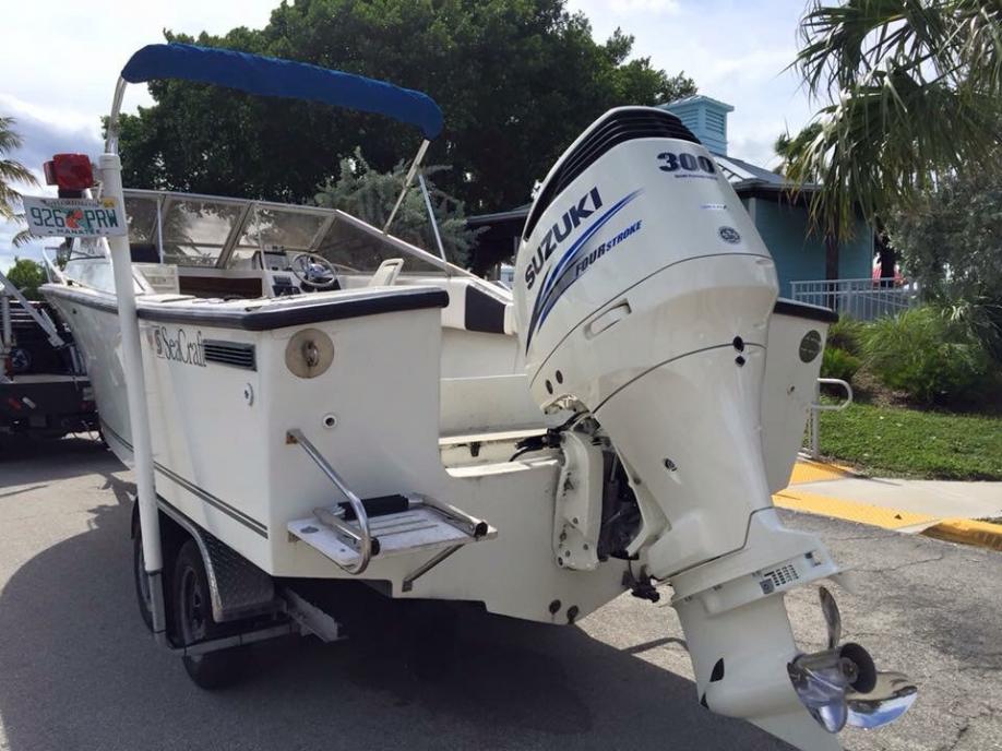

Just getting going with the new motor.....

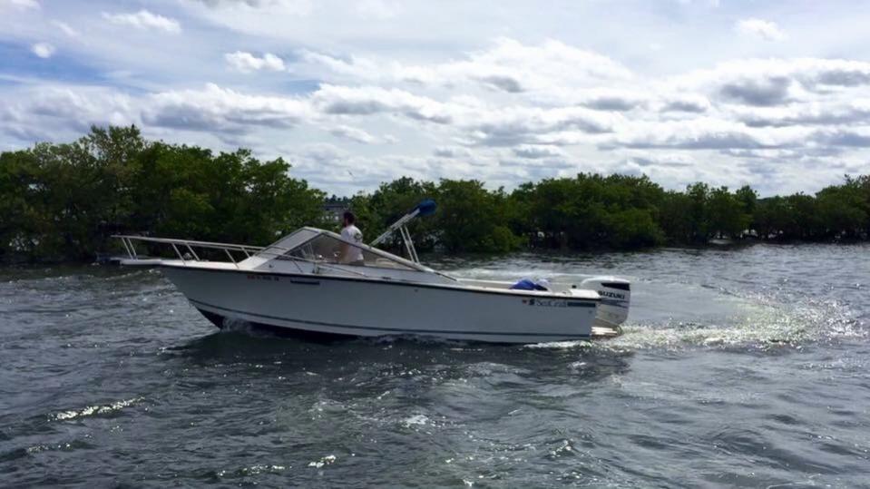

International Marine water testing....

Thanks brethren! I dragged her to Boynton Friday and it was done on Sat by 12 pm. Intl Marine is fast. I will post numbers ASAP. The Cuddy weight made the 16X20 Zuke prop too much. 5400 max rpm. I have a 18.5 on there, but the installer wanted a 17! I probably need a an enertia prop to lift the bow down the road. With the weight forward I have the same freeboard as with the 450 lb Johnson. It's on the 3rd hole and the plate is even with the keel. The nice motor really makes the top sides look ruff!
