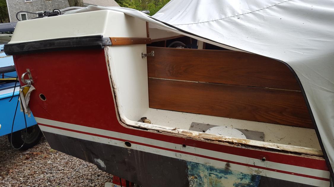

I've attached a few pics of the boat when I found it and before I started the restoration. It was a freshwater boat it's whole life, but the through hulls in the splash well leaked and turned the inside of the transom to mulch. The foredeck and alongside the console were mushy and I've already re cored them as well as the fuel tank cover. I had a new 42 gal fuel tank built and have installed that with all new hoses. Plan on keeping the boat, so it's important I do it right the first time. I appreciate any thoughts you all have to help me make sure I get it done and done right. Thanks!

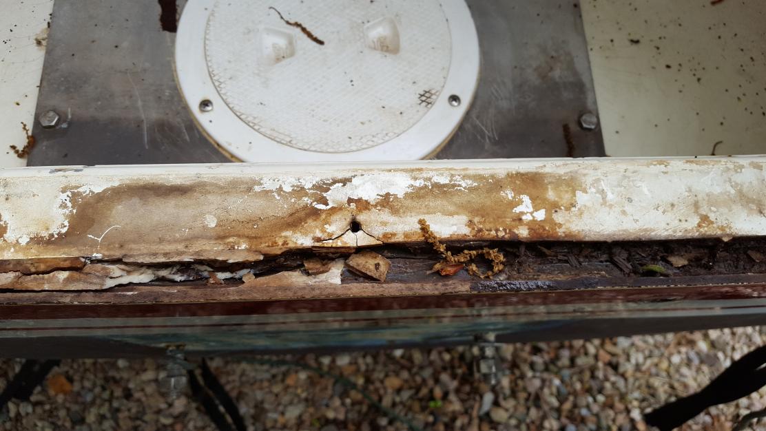

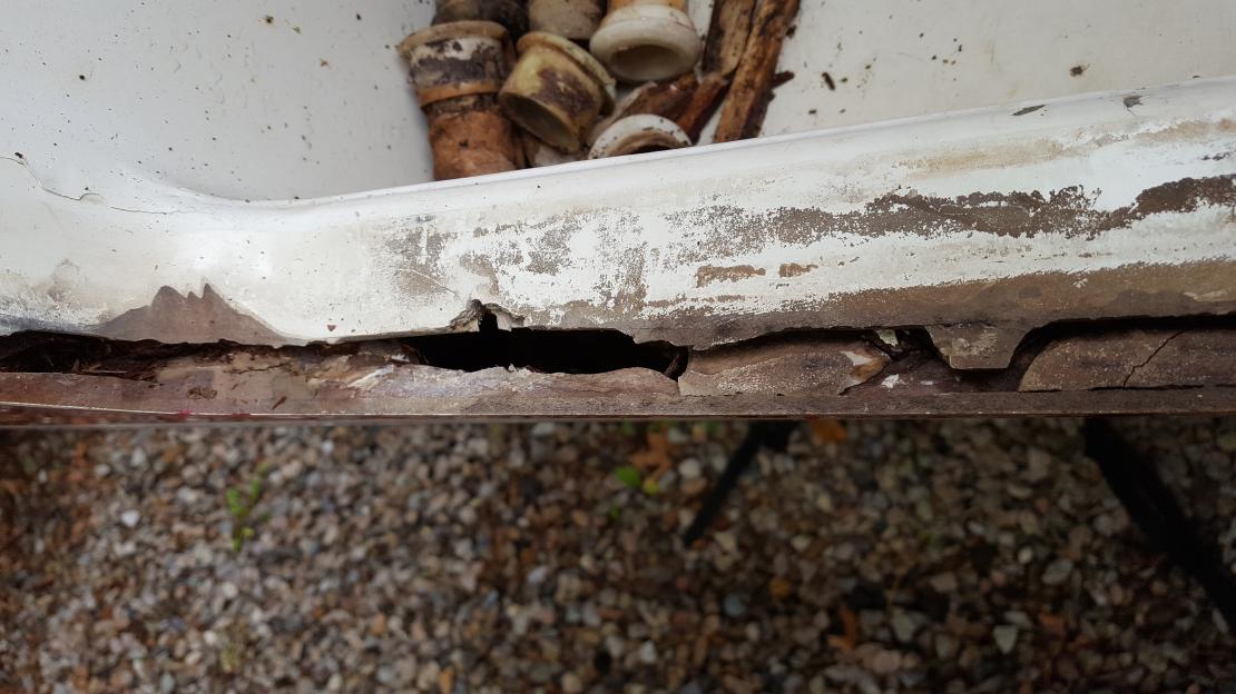

This weekend I took off the aluminum motor well trim and original plastic thru-hulls to get a better idea of the extent of the rot and see how much work is going to be involved in cleaning out the rot in preparation for the new material. I've attached a couple pictures of the current condition. It amazes me the original engine still hung. Not only was it still hanging, the transom didn't even flex a bit when I bounced on the motor before pulling it. The port side of the transom is almost completely devoid of any type of solid core. The only semblance of a core left was under the motor mount and it is soaked through and easily peeled off the skin.
