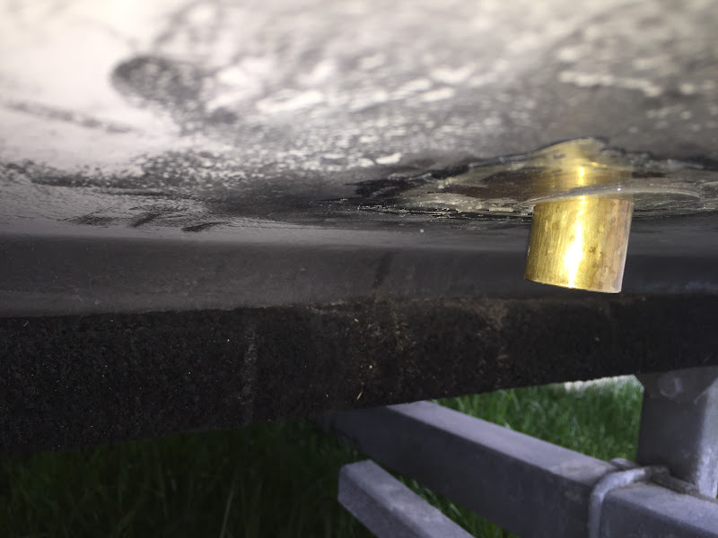

2. Second issue faced, and this is where I am spinning in my head... So, I ordered 4in brass tubes and flaring tool, 3in were too short, so I have to Cut the tubes I'm assuming just shy of 1/4" past hole for flare tool. Again, I can handle the cutting of the tube, its how the tube sits at an angle, instead of square to Hull for the tool to squared the flare... see below.

Looks like those scuppers have been repaired once before, as a '73 should have the wood blocks Gillie mentioned. Looks to me like you've already done the hard work, as the glass surrounding the tubes appears to be in good shape. The fractured gel coat in the well in the deck is just cosmetic and could be easily repaired using thickened epoxy. The tubes I bought were already flared on one end, so I installed them with flared end on inside and cut them at an angle parallel to bottom so they extended roughly 1/8" below hull. I made my own flaring tool using a threaded rod and some 1/2" drive sockets that rolled the edge over about 45 degrees to start the flare on the bottom. The brass is pretty soft so I just used a ball peen hammer to peen the flared out edge flat against the hull.
