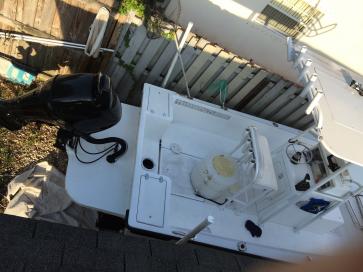

Default Console location
I have a 21 with bracket and suzuki140 four stroke
Move console all the way to front hatch and batteries in front of console best way to go also cut out splash well ,flip it around and glass back in for additional footing
