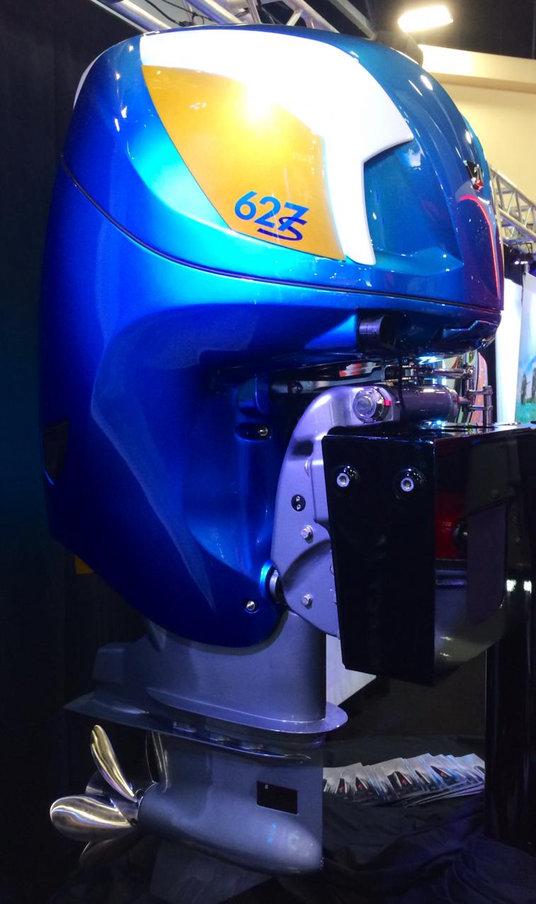

Move everything forward get 5 fat buddies strap them in on the front and hang this on the back
Hold on
