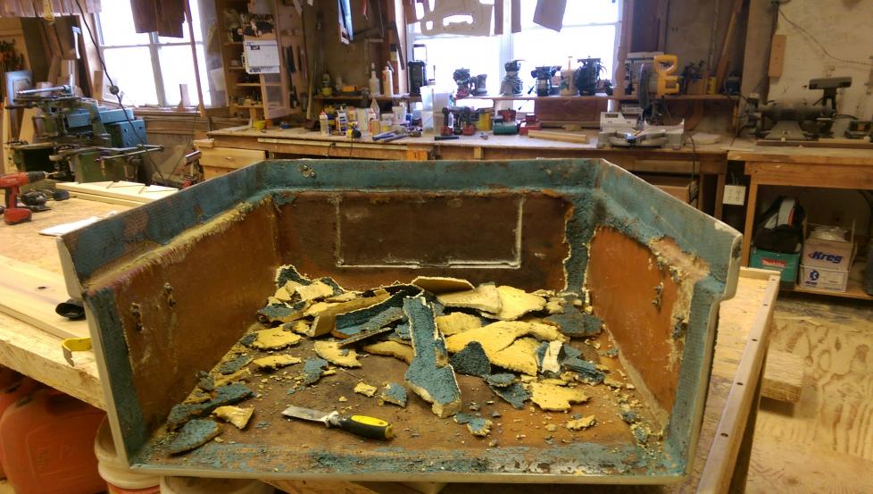

more work , the balsa was soaked with water going to remove and use divinecell for core

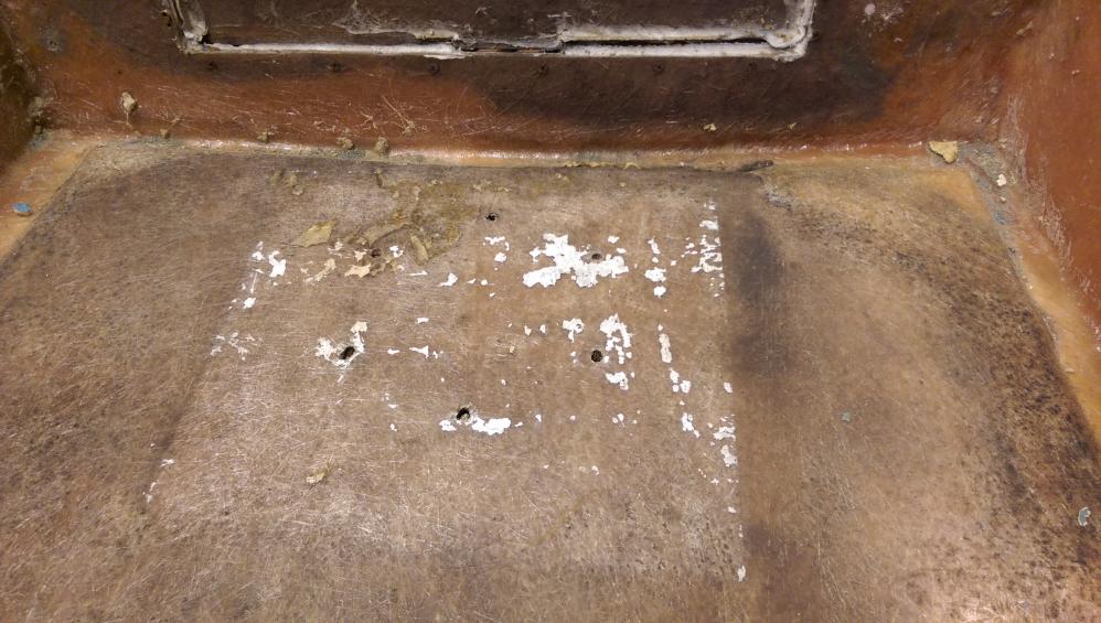

this is what caused problem

hull and deck putty and divincell
