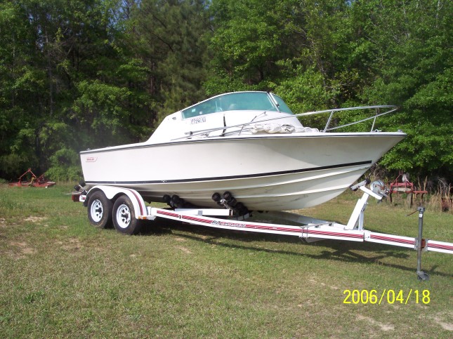

So's I mutter ta muh self, "huh, wonder if any round here" an I finds me a bahia mar up the road a piece on a nice trailer. Good thing I like the cockpit of the hi-liner and the whaler better... nice pics and comments. Dead on... Only additional thought, if the plan is to flip the boat I think a well done Bert would probably bring the most in sale.
