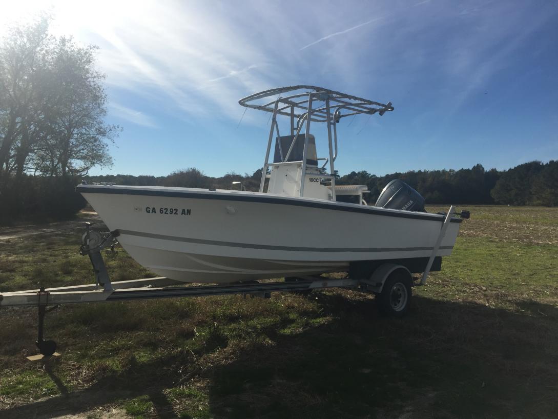

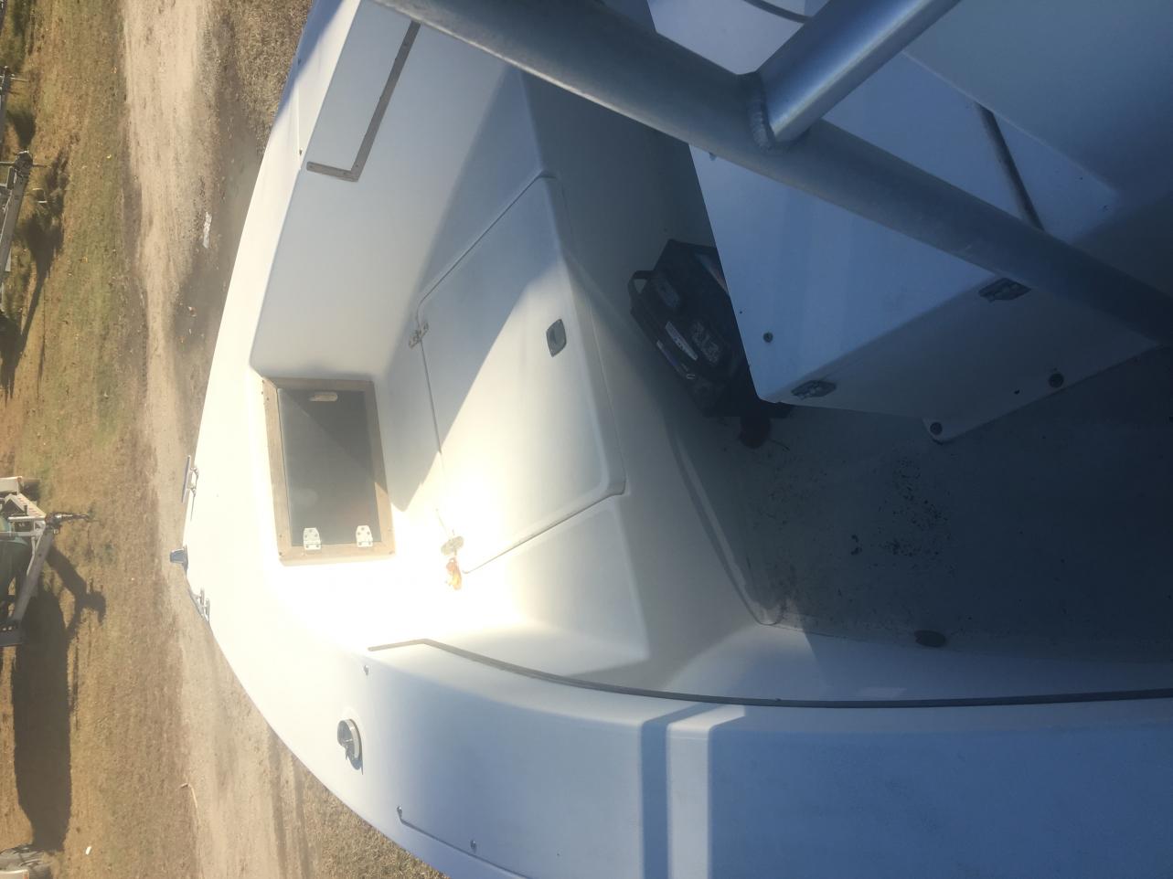

I have been fortunate enough to come across an 18CC that has been in dry storage for the last 5 years in Savannah GA. I have been chomping at the bit to get started on this but have to wait for the old motor to be removed.
What I know:
1. Boat was in dry storage for last five years, hull, floor and transom all appear to be solid - I just did a 17' River Ox rebuild with my father last year and do not want to go into that level of work with this boat. The river ox was water logged, foam was removed, stringers rebuild, transom rebuilt etc. I will definitely do it to this vessel if necessary but fingers crossed!
2. Current motor is a 150hp 2stroke Yamaha (~425lb). Motor is being removed as part of a trade, so I get to repower. I am concerned the weight of a 150hp 4stroke will be too much for this rig (~485lb) - some hulltruth posters mentioned a 140 suzuki 4 stroke (~410) or I was thinking a Yamaha 115hp 4 stroke (~380lb) - thoughts on this?

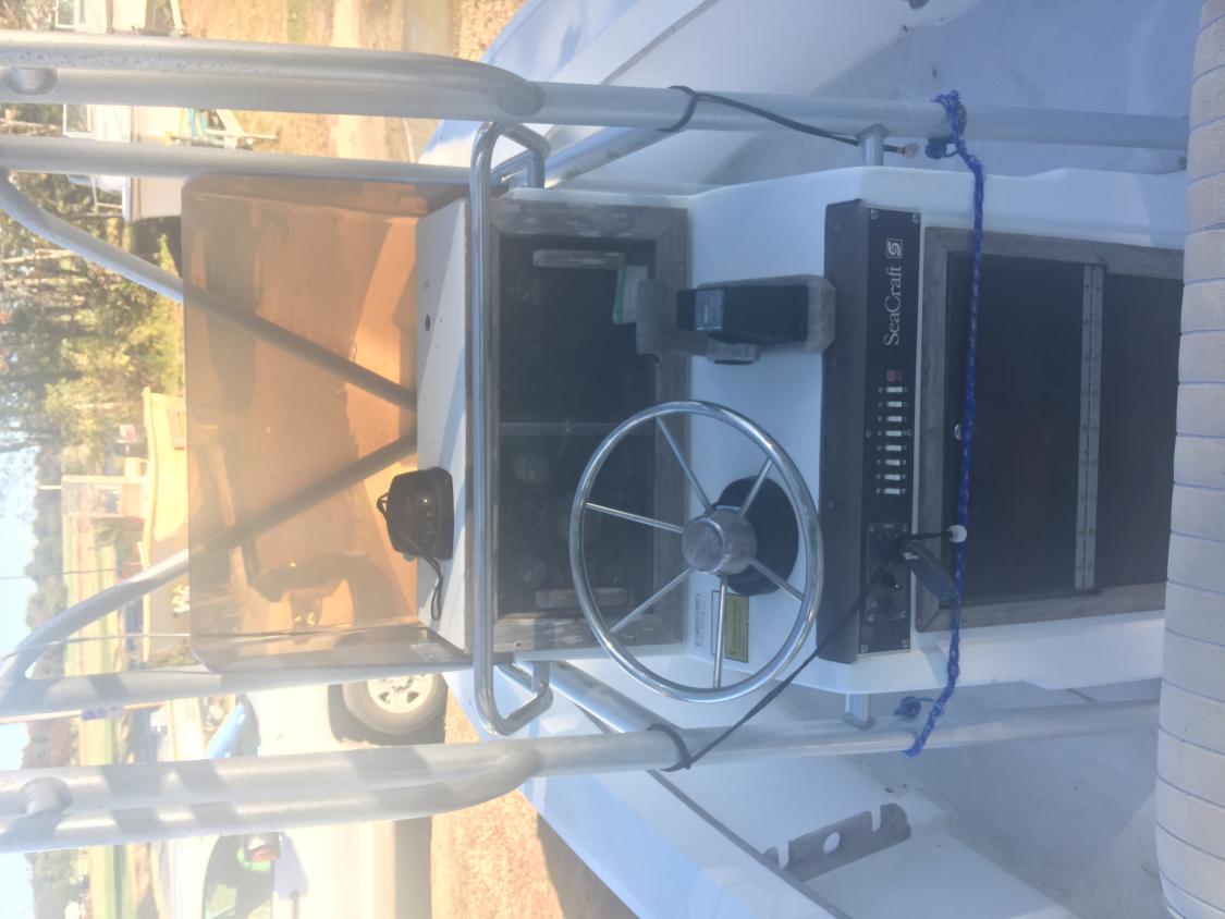

3. I would like to update the console, ive never been a huge fan of the black plexiglass. I want to keep the integrity of the original seacraft but some modern amenities wouldn't hurt. Essentially I'm torn as to if I would want to reuse the teak or just scratch that and go new look completely (leaning toward the latter)
I welcome any and all feedback!! I am brand new to the Seacraft community but have been obsessed with these boats since I was a kid. Excited for a winter project - would love to get it dialed in before next spring. I will keep all updated on progress.
