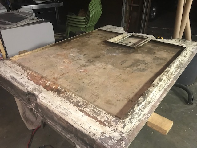

And, this is the progress about 3 hours later. Letting the decking dry out for now since it's still pretty wet to the touch from all the soaked wood sitting underneath it.
Hopefully it will dry out. I'll start sanding it down tomorrow or over the next few days to start preparing for the glass work and core.

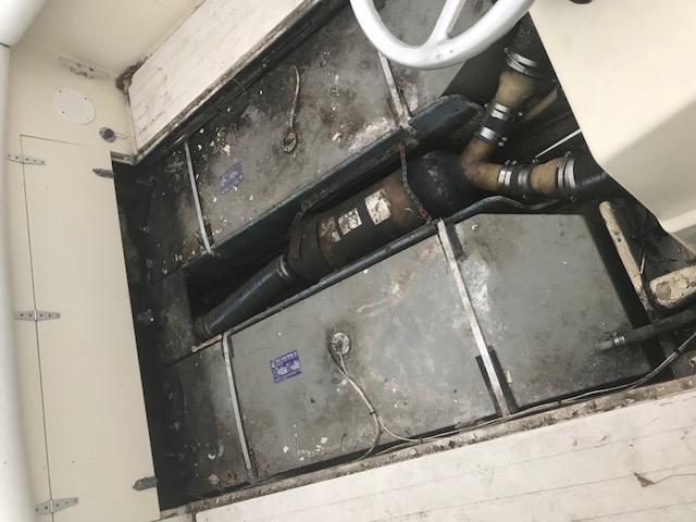

Was able to get up in the boat after work while I had daylight.
The highest objects that are under the deck hatch are the gas sending units, which are 1 3/8" underneath the lip of the hatch. This would explain the 7" circle spots that had a center point 1.5" higher than the bottom.
My father helped me identify what was used before.....bulsa wood/core! I think that might answer some people's questions whether this was original or not. I am now leaning to think that this was done before.
I am thinking that I may sandwich a 1/2'" & 3/4" marine grade pieces together, and that creates my core. I will have cutouts on the 1/2" piece to leave space for the leaning post washers/nuts, and cut two holes to leave space for the fuel sending units. This will fill the entire void back up to 1 1/4", and will leave space to resin/mat the top surface back to that 1.5" mark. The more I thought about it, I want it back to 1.5" depth. It will get me essentially resting on the retaining walls for the gas tanks, and I doubt I'll ever have to worry about this thing getting soft again.

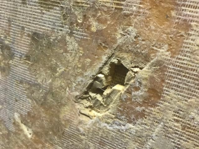

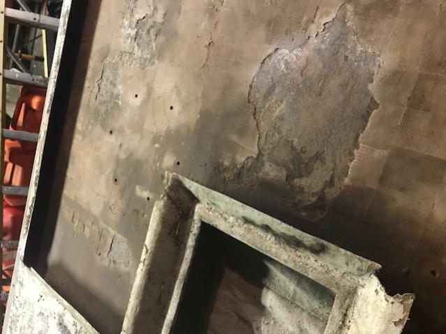

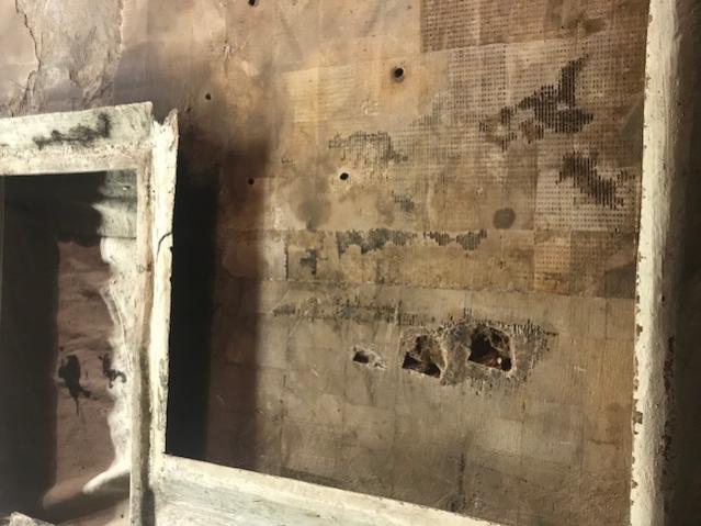

Took a few more pics, first one is of the stern area of the boat. The others are after sanding the deck hatch down and letting it dry out for a day. It's definitely a lot dryer in general than yesterday. I have cold temperatures working against me in NE, so I may have to invest in a space heater soon to continue progress.
Few pics of where I got a little chizel crazy. Nothing that can't be fixed but definitely a moment.
