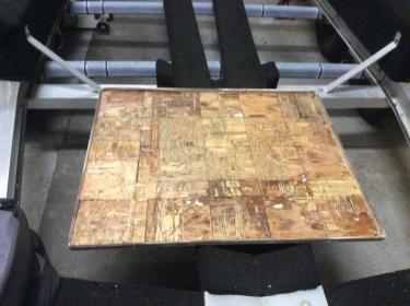

Well removing hatch cores sucks. Trying to save a little jing before it heads around the corner to shop. Front smaller fuel hatch was in really good shape. Appears to have a layer of resin poured over fabric prior to setting balsam blocks. You can see it at bottom right of photo.
Old 03-08-2018, 10:05 PM
Main hatch not so fortunate. Been thru a few times already. Going to have to carefully go grinder method on this one. Oscillating tool blasting thru wood on forward hatch.
