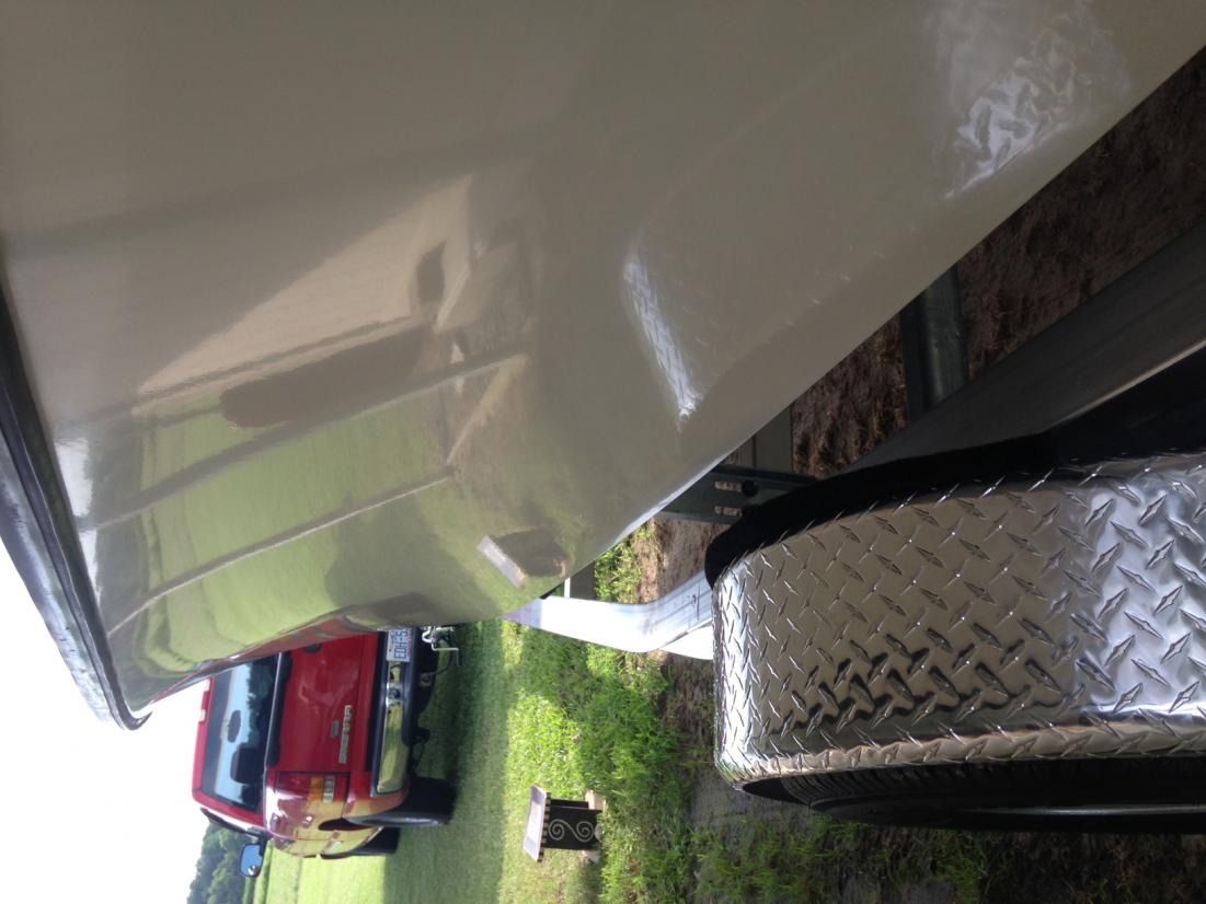

I used a DA sander with 800 grit disc, sanded the hull sides and compounded with 3M Super Duty compound #05954 in the black bottle. That gelcoat is a lot tougher than you think.
http://www.classicseacraft.com/commu...1&d=1527705185
Old 05-30-2018, 02:34 PM
You can still see the raised areas where the old decals and the boot stripe were, but, you have to look for it.
