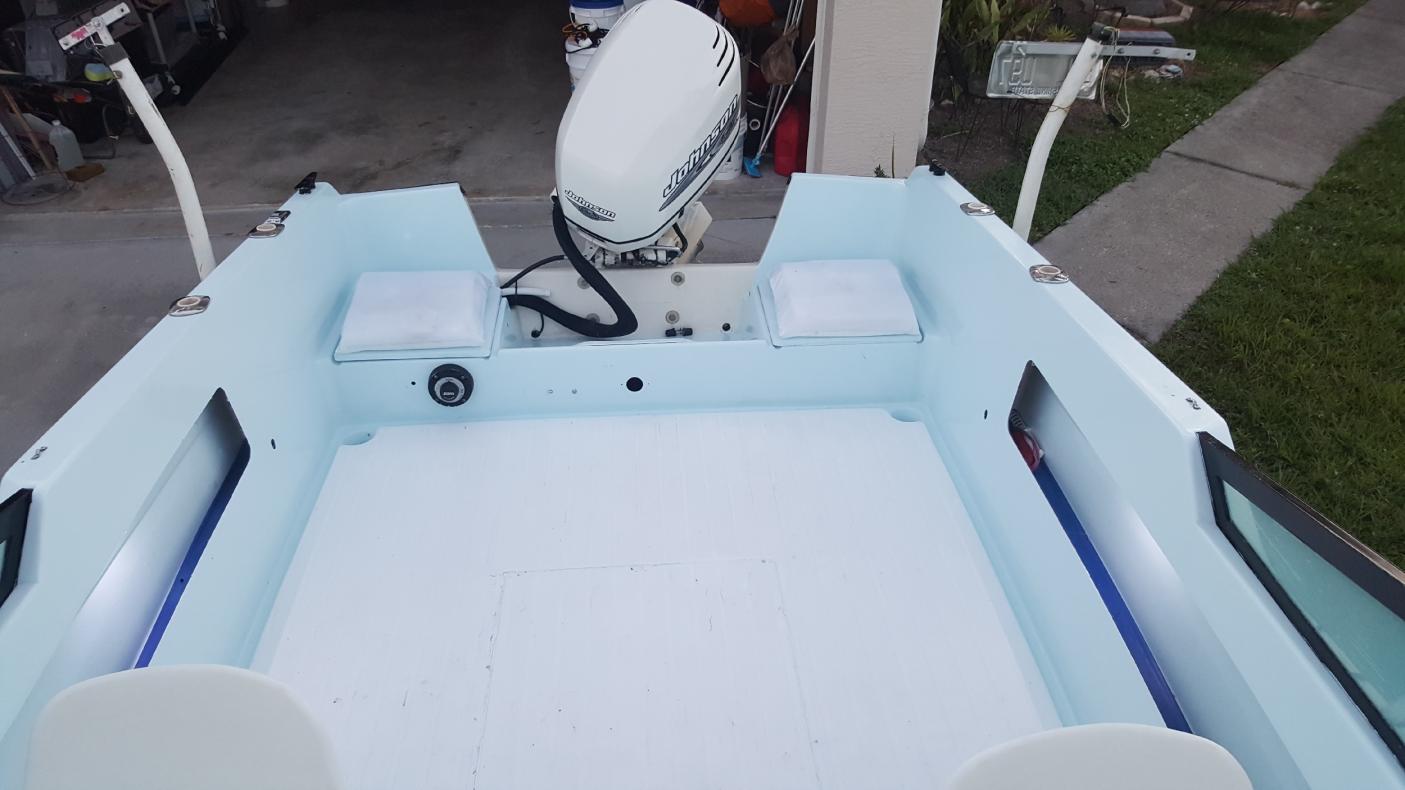

The below pic is not my boat. I do believe it is a members boat. This is what I have. This person seems to have replaced the cleat. Mine has what appears to be the original aluminum ones that match the front ones. This appears to be a different setup that what you describe, Capt. Chuck.

I thought there was access to remove the aft Marinium cleats which came when I ordered my '76 Seafari. My cleats are still tight and have never been removed. I looked today with a flashlight and mirror, it appears to remove them would require cutting access holes if they cannot be simply unscrewed, as no nuts were visible.
That seems to be the case here. I cannot find access to them, and turning the flat head screws does nothing.

Looks like aft cleats were mounted before cap was attached. Maybe the cleats were used as lifting eyes to lower the cap in place.

Surprised the nuts were not accessible through the vents, however unless you have very skinny arms with about six different socket adapters it looks like you might be stuck as is. That being said getting the ones off you have is a piece of cake, 4 1/2" grinder with a cut off wheel and 10 minutes your done. Then there is patching the holes which is always fun. I'd then install pop up cleats between the rod holders as far aft as you can reach with a 3/8" pneumatic ratchet. Have fun!!
