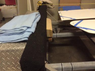

Let’s try this Basket. This is a Quick Load Aluminum I-beam which is too narrow with main bunks attached to topside of beams (strongest and and distributes weight on the beams rather than the cross members).forwards of axles looking back. All four chines run parallel with bunks (straight). Better pic from rear next.
Old 06-19-2018, 11:45 AM
This pic from rear shows transom even with bunk ends, but if you notice she is resting on second chine, and would rather have bunks spread another 1.5 to 2” per side, locking the hull inside the beams and lowering the boat.

Lastly, I have to close the distance between bunks from 61” to 54” to lock the chines. These additional blocks wil only support very little weight but will guide/line outer chines up making it easier to drive on centered. NOW, my ramp in Fla, is very, very steep so blocks, not carpeted yet, will have to be secured about there the water line is on approach. On a less steep ramp, ideally you would want them much further back.

A little tough on a table saw to match angle/beveled edge on top to match the angle of the outer panel, but the factory was spot on for a SeaCraft.
