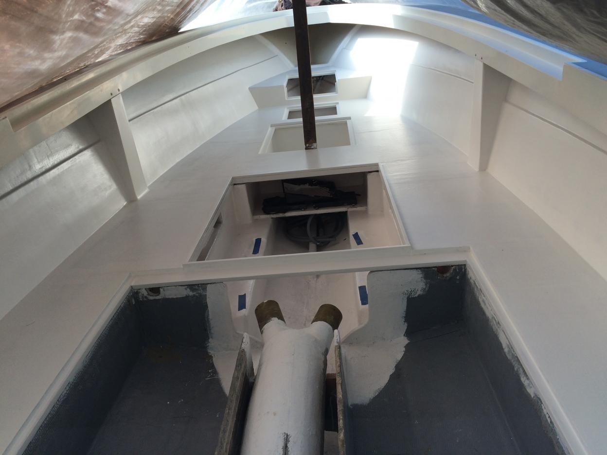

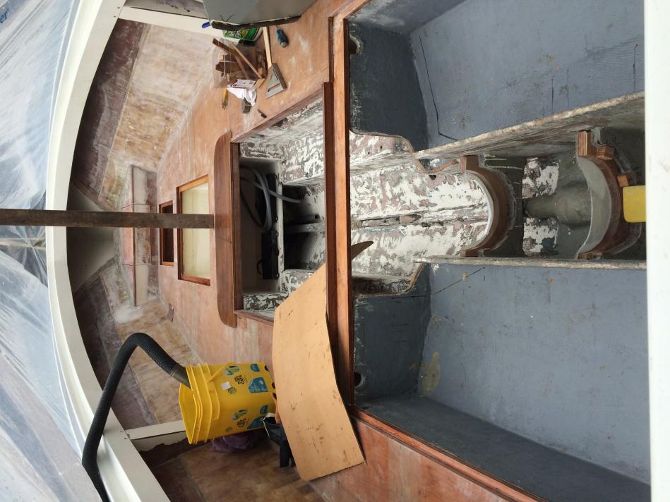

nice shots,dont see inboards too often

I have a 23 invoard that I'm restoring. I see your floor, which is modified. Do you have additional pics? I noticed you changed the forward floor hatches and sealed off the battery hatch. How does your console fold? To the bow? Can you get to the batteries easily enough with you configuration?
