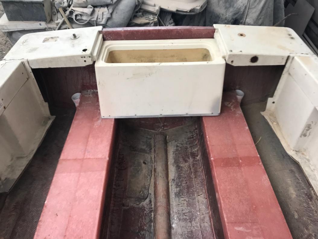

I decided to close the transom and go with a bracket. No if and or butts. BRACKET!!!!
that being said I decided to raise the stringers and floor a total of 3 inches. So that self bailing would not be an issue with all composit material through out.
Bought a console out of a Carolina skiff that is going to be awesome.

Default Transom well
That's a well out of an old mako that fits perfect at my transom

Very cool find!!! Good choice with the Coosa. Good luck!!

Moving fuel tank forward 24 inches. And batteries under front deck
