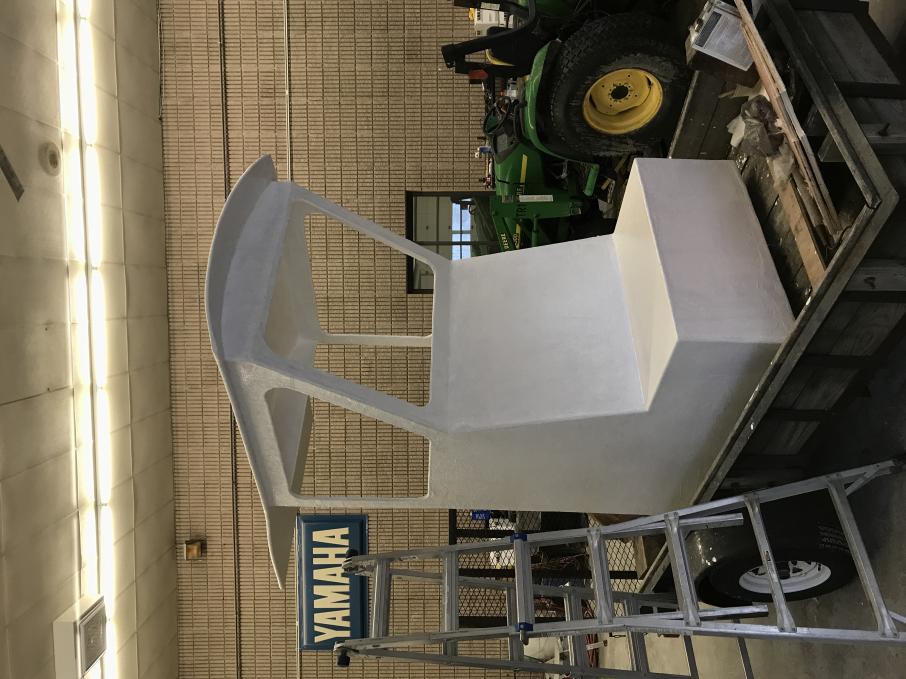

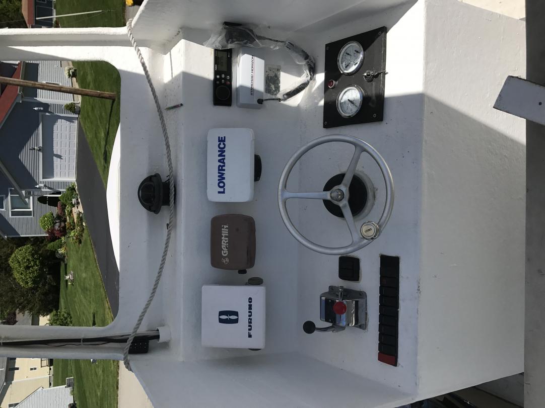

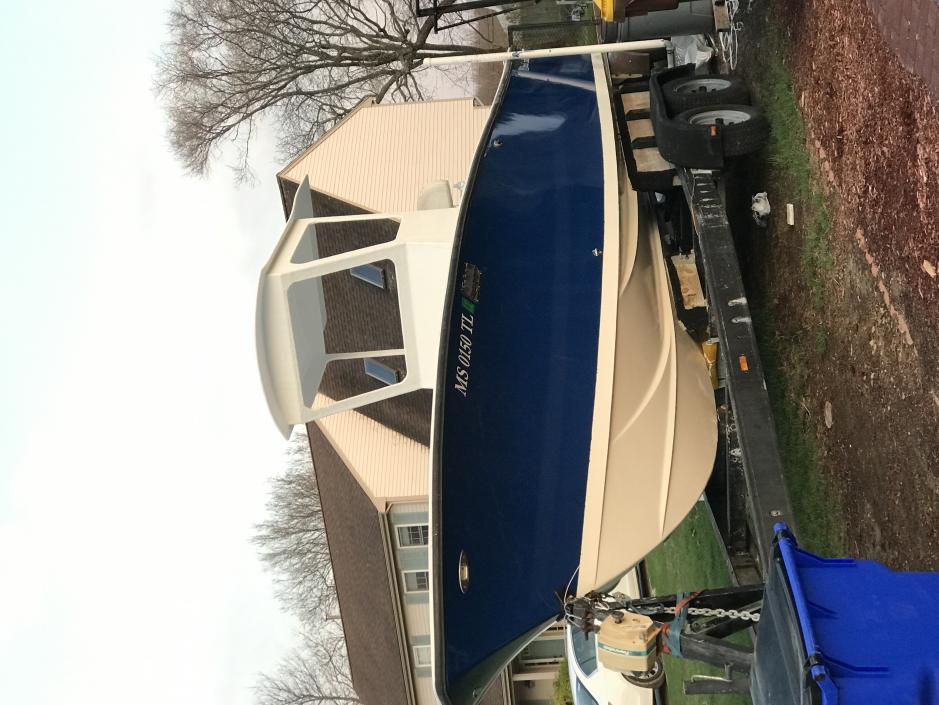

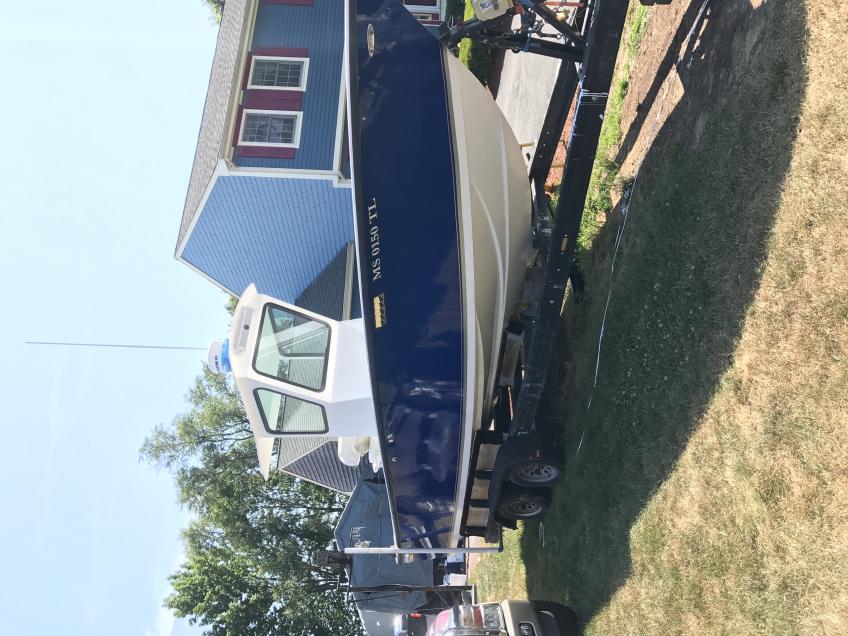

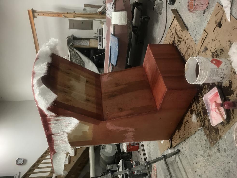

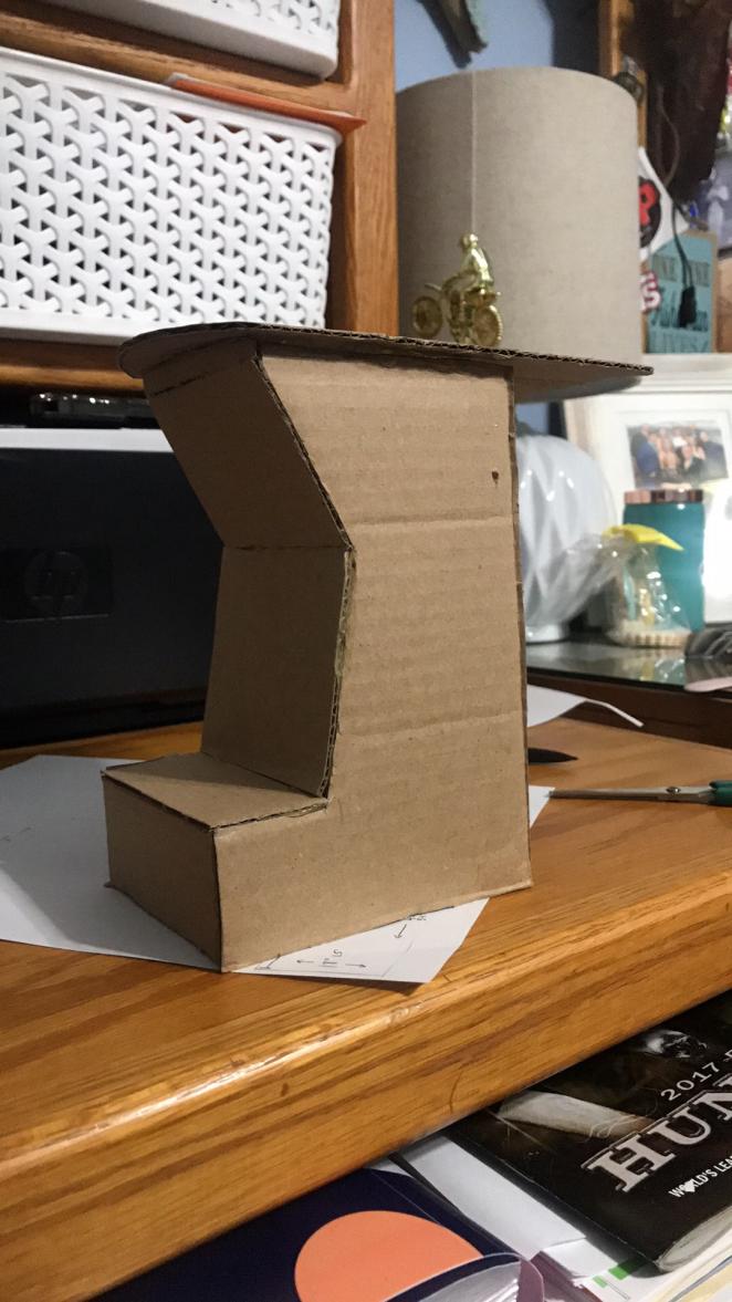

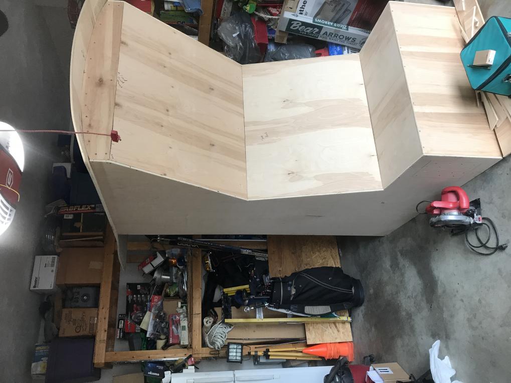

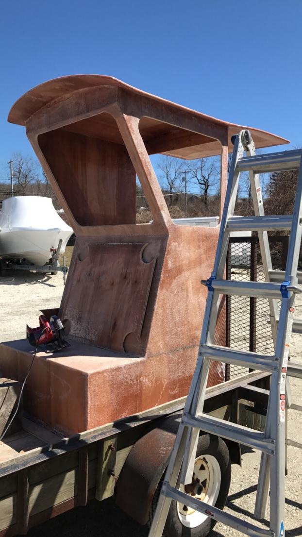

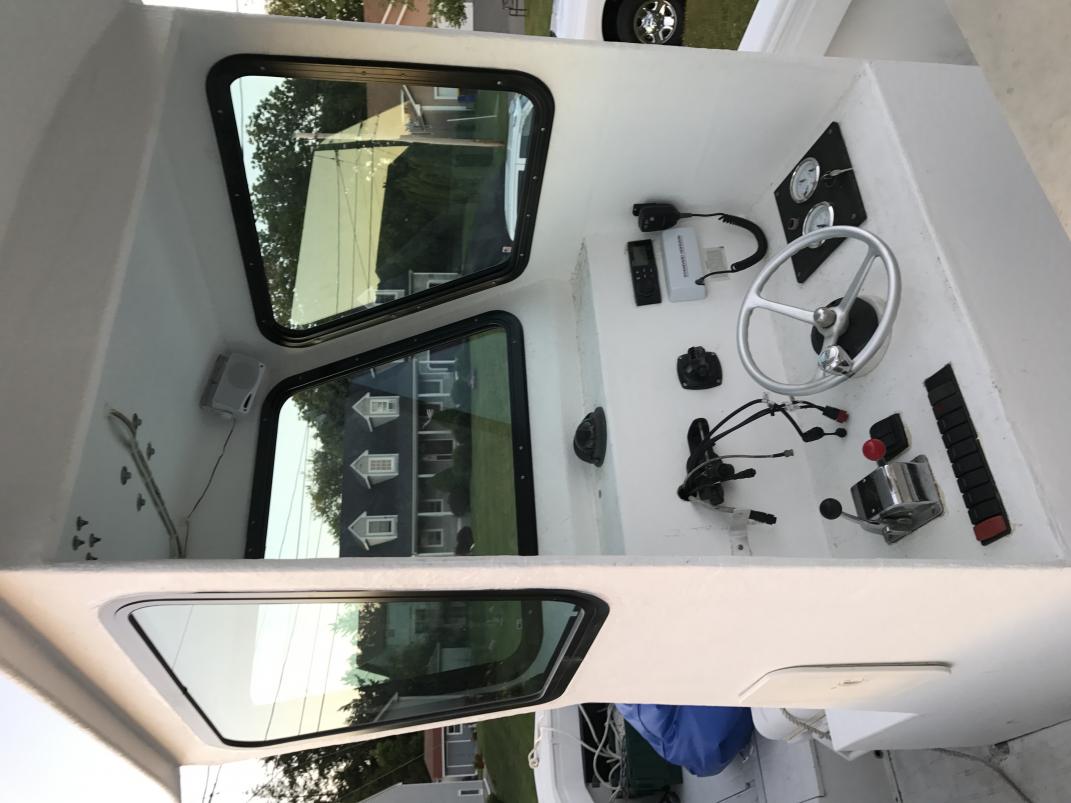

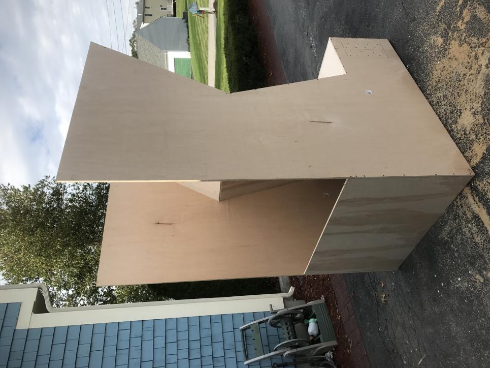

Well when I bought my 23 it had a t top that after a tuna trip in late September had me wanting the doghouse built and installed ASAP. I built a to scale model out of cardboard and then got to it on the real thing. Here's some photos and I would be more than happy to answer any questions on it.

Thanks it does just that. Opening day of commercial bass proved it was worth its weight in gold when I set an 18kt cruise home and got off at the dock nice and dry through some sporty stuff

Wynne enterprise out of Alabama. I sent them tracings of the holes and they built them custom. They use a 3” radius on their windows so I used a 6” holesaw to get them perfect. They were more expensive since they’re aluminum frame and clamp in but they are awesome quality. http://www.wynneinc.com

Are you going to install the dirt-bike on top?

Only if I can find one in gold! It’s comfy, I’m debating making a fully enclosed rear with doors and heat for spring and fall fishing tautog and some late season tuna & cod
