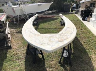

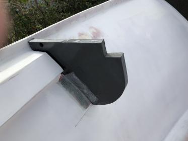

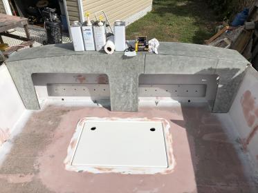

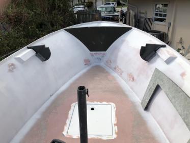

Built some gunnel support, made a 1/4 in bracket plate,cap core with 1/2 inch coosa going to put a layer of 1708 on top,anchor tube.

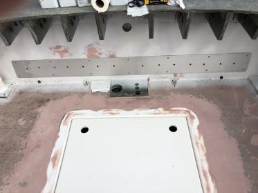

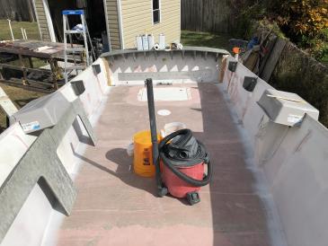

Digging the large bilge access as there is nothing I appreciate more on my bilge area than the big hatch we put in. I have those pics of my bracket steering line install if you want them. Shoot me a PM with your email.

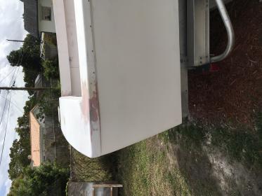

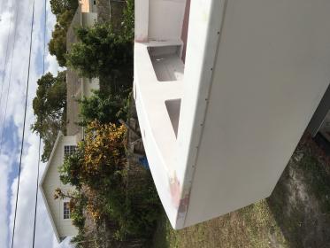

Happy new year. Hey is your rub wide enough to were it covers the small lip/revel on the hull. I want to cover that up, thinking something 2 inch wider or more but needs to have a lip deep enough to make both the hull cap revel and the hull reveal.
Yes steering pics and rubrail closeup pics would be great

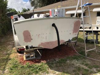

Ill put up some pics tonight but my cap and hull are glassed together so rubrail results may vary.
Old 01-02-2019, 07:56 PM

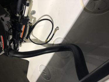

Here is how I ran my steering with bulkhead fittings and 2 24” hoses.

Cap/transom fit togeather perfect
