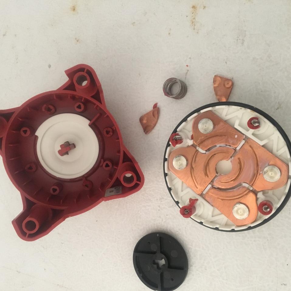

Check your battery switches guys. Blue Seas 5511e has been in service 7 years or so. I noticed the "detent" had gone soft. It basically fell apart when I began removing cables. The plastic lugs for the small screws failed. This holds the unit together and there's no reason that I know of the end user would ever remove them. I sent an e-mail hoping it's covered under their warranty. We will see.......

This was a known failure for a particular run of these switches. They redesigned the switch and did replacements for a while but that was a few years back. You also have to make sure you don’t over torque the nuts when installing and make sure all four mounting lags are secure.
Even with proper installation all battery switches can fail. I always make sure I have a small pair of vise grips in my tool kit just in case so I can clamp two leads together.

They say a replacement is on the way and that the E series were not part of the "known failure" group. We will see
